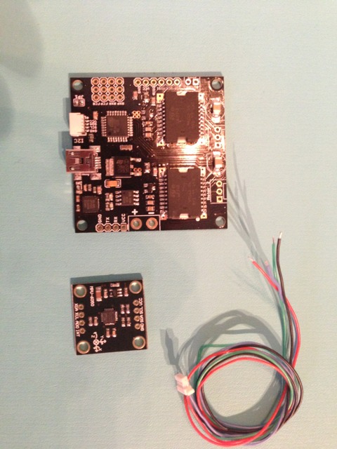

Got the motor wires extended and motors installed now.... getting there. Had a small hiccup with my alexmos board, DOA
