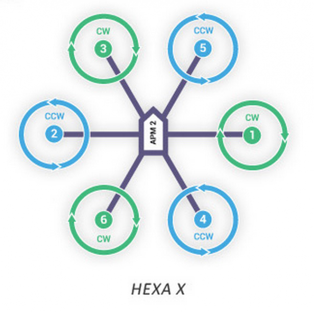

Not wind. I don't have a lot of experience with the Pixhawk, but that is not the way a controller should fly. Are you sure you have the motors in the right configuration? To me it seems like your motors are off. Meaning that #1 on a A2 on a Y Hex is the front right arm. Where is your number 1 motor?
The Pixhawk is weird where the #1 motor is the "3 o'clock" position.
make sure that motor is plugged into motor port 1 and so on.
See below.View attachment 25366

Yeah, that was my problem before but all of the motors are in the correct positions now... It sometimes flies fine but sometimes it spins...
