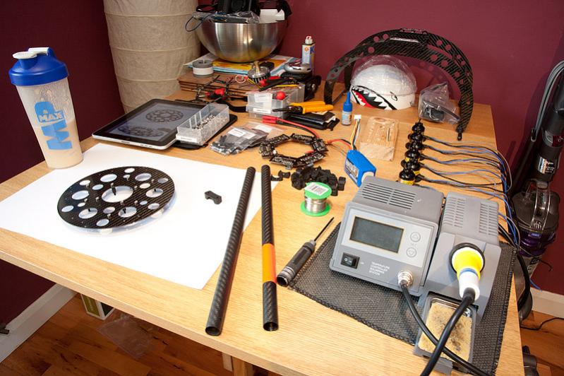

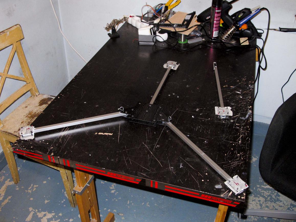

Build got started this weekend.

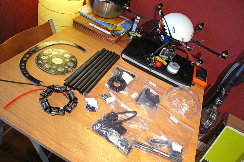

Here's the contents of the AD6 box along with the 'donor' hexa 2.
Lots of bags with bits and some nicely finished carbon parts. No instructions though.

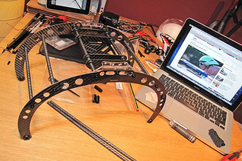

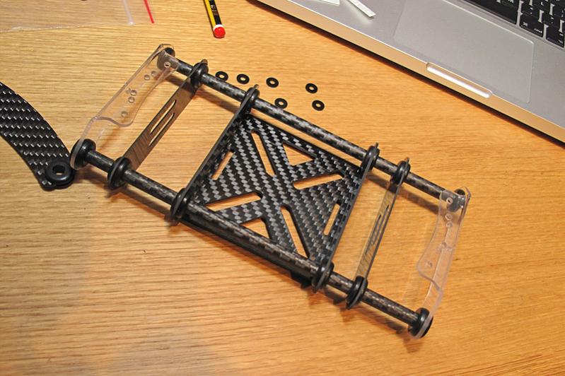

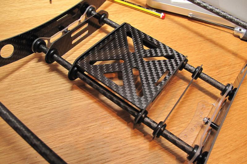

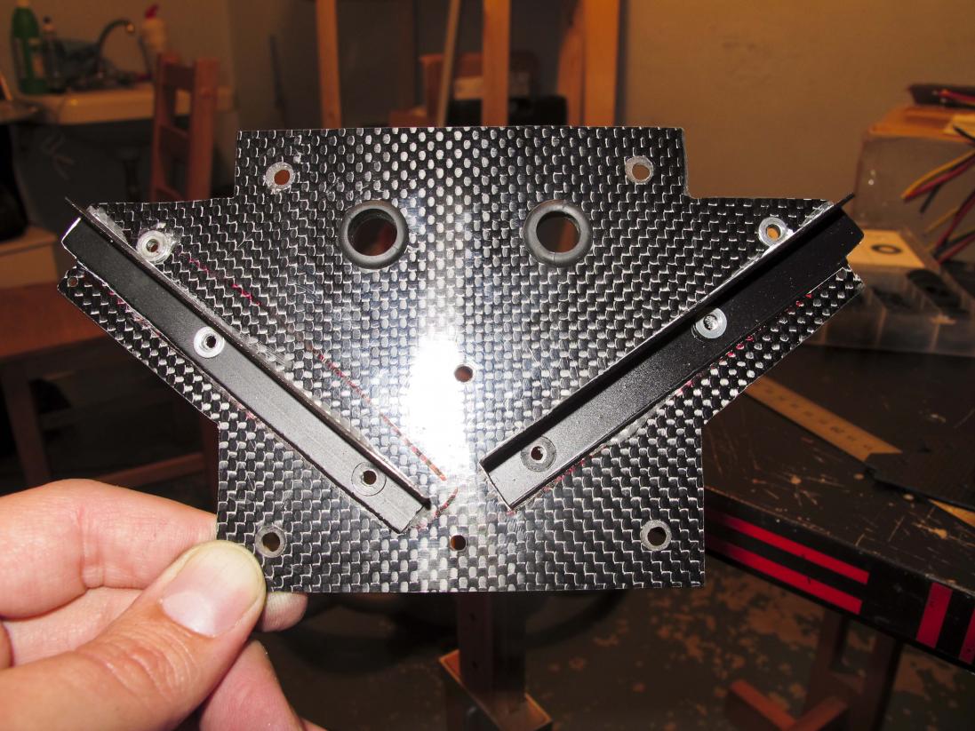

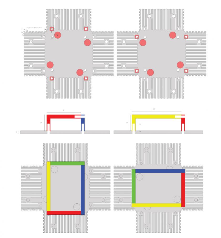

Saturday evening. First job was to build the landing gear. I was quite surprised (in a good way) at how much bigger it is than the MK one - i had access to the rather odd, super long, single page assembly pdf, but there's nothing about the V3 camera plate in there - not sure whether this is supposed to be glued or what - there are some slots, but no supplied velcro straps to use to hold things together - not sure i want to risk my gopro on four tabs in compression, but i don't really want to be hot glueing or using CA on them either…

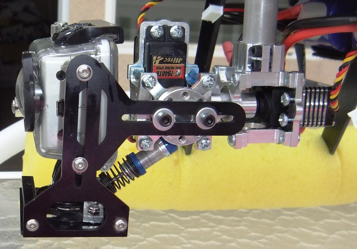

A 'constructive' niggle with this plate - which is touted as a gopro mount on the DW website, is that it wouldn't hurt to have included a tripod mount size hole in the centre along with a tripod thumb screw - for the gopro tripod mount.
That might sound like a daft niggle, but this is a premium frame at a very premium price - it's not a problem to drill a hole myself, but…

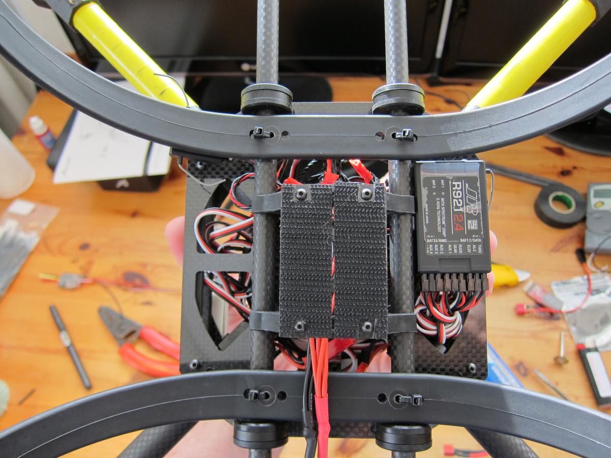

Could also use some examples of different battery mount options. I have the original (next to useless) 3300mAh flat pack and 2 x 7.2v 5800mAh packs, so need to think about how i'm going to mount my lipos.
No straps included in the kit for this purpose either. :-(
Beginning to think i should try funding this hobby by offering my services as a graphic designer, producing clear instruction pdfs…

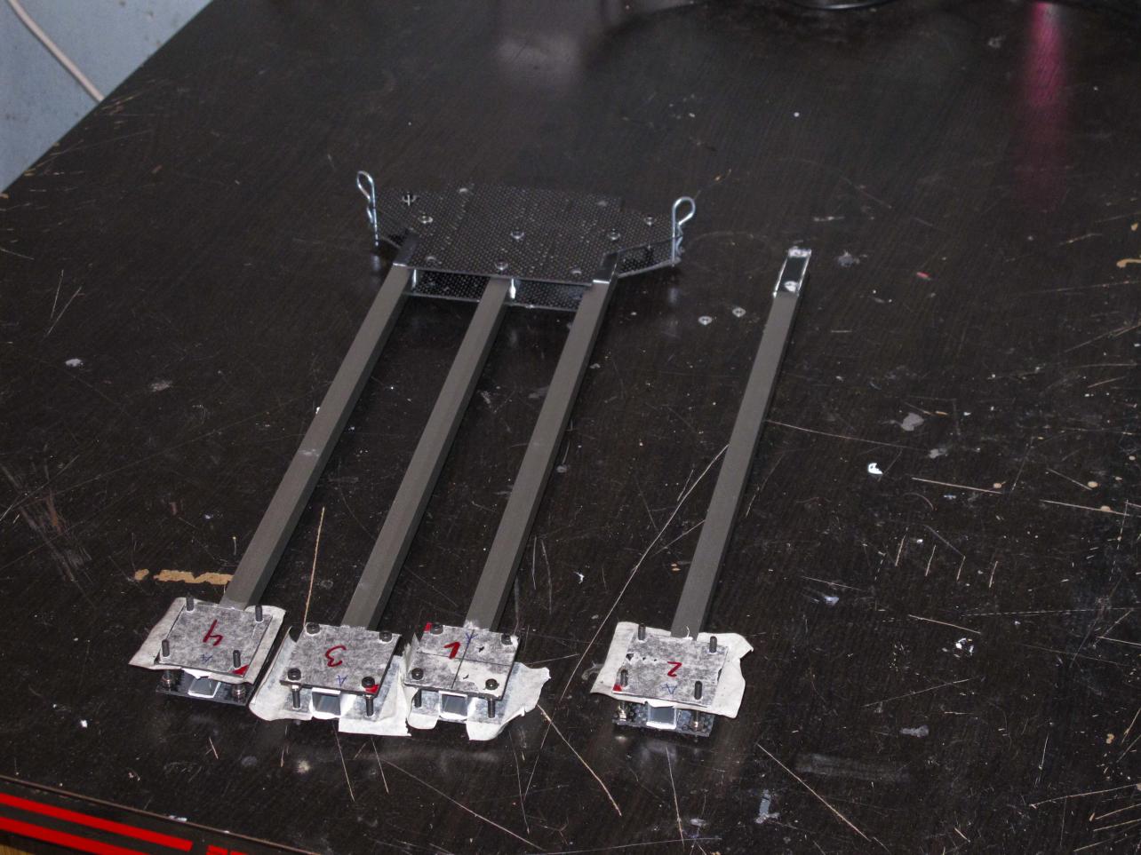

Sunday Morning.
Planned to get the power distribution and motors sorted today.

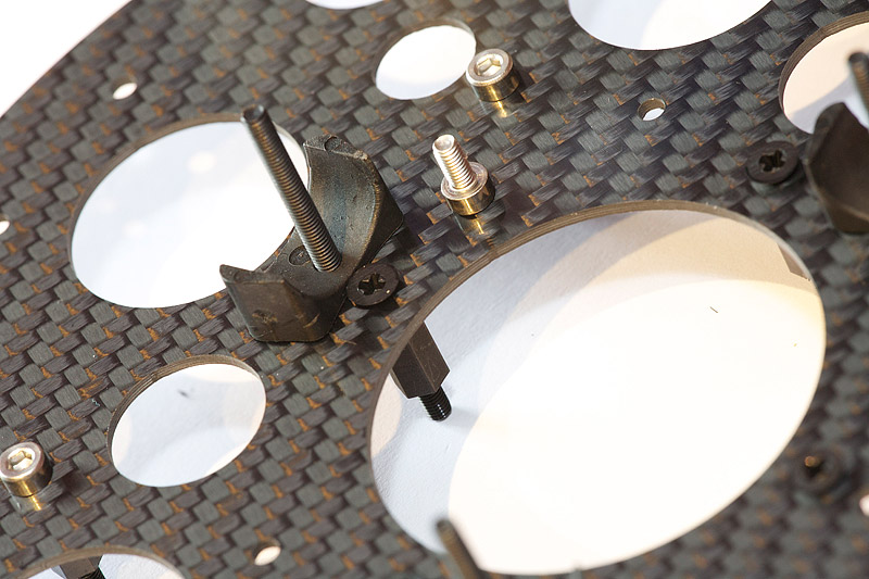

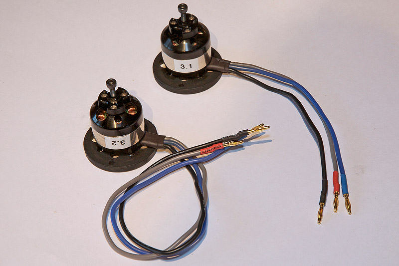

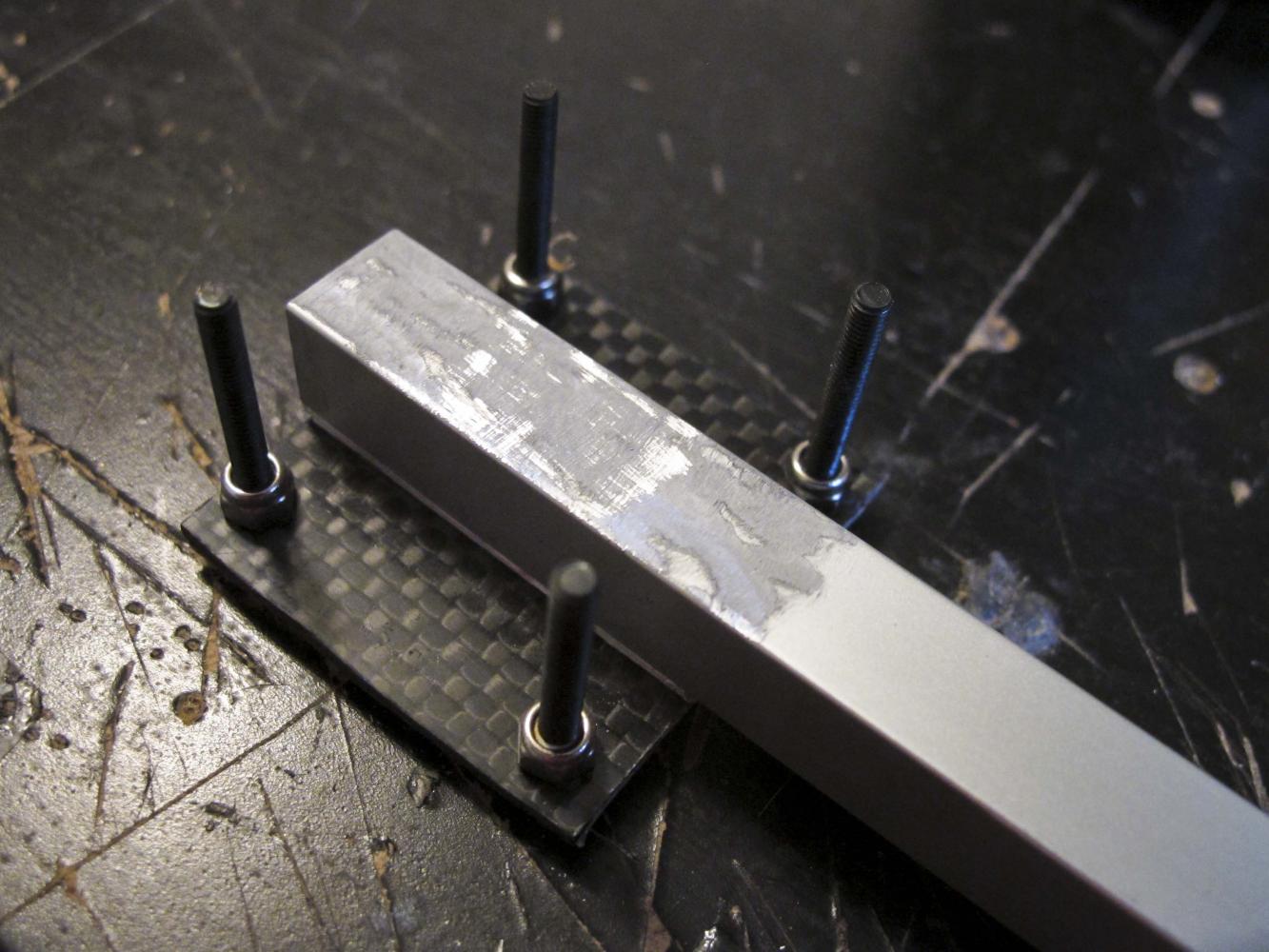

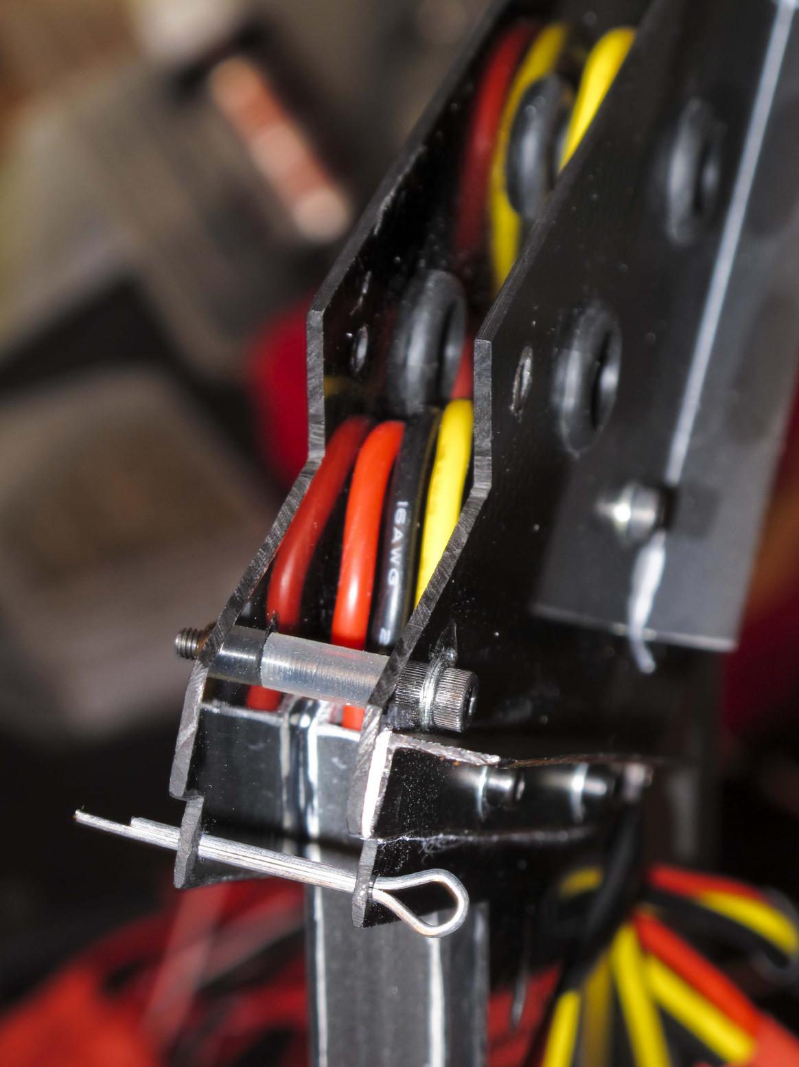

I replaced the cross head screws with my own M3 cap heads as i prefer to work with them, however i soon discovered that the booms wouldn't fit with these on the stack standoffs so had to swap those four back to the ones supplied.

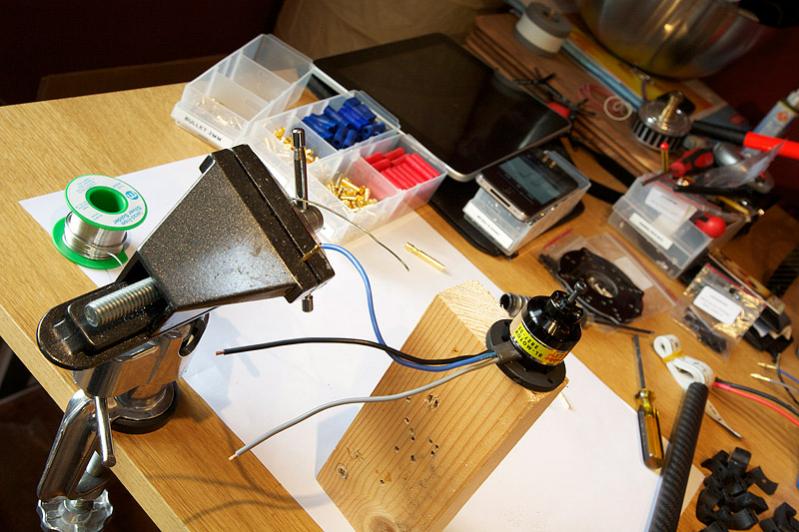

Had a read up on connectors and decided to use 2mm bullets on the motors as they're rated up to 20amps. The donor motor leads are not long enough to reach the PDB so i'm having to make extension leads for them. To avoid bottle necks in the booms each motor pair has one short and one long set of leads.

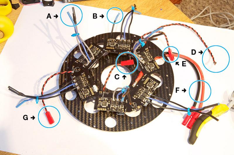

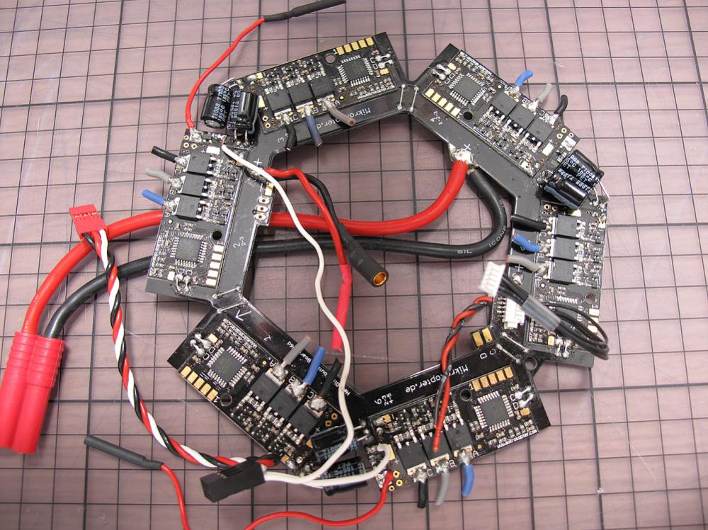

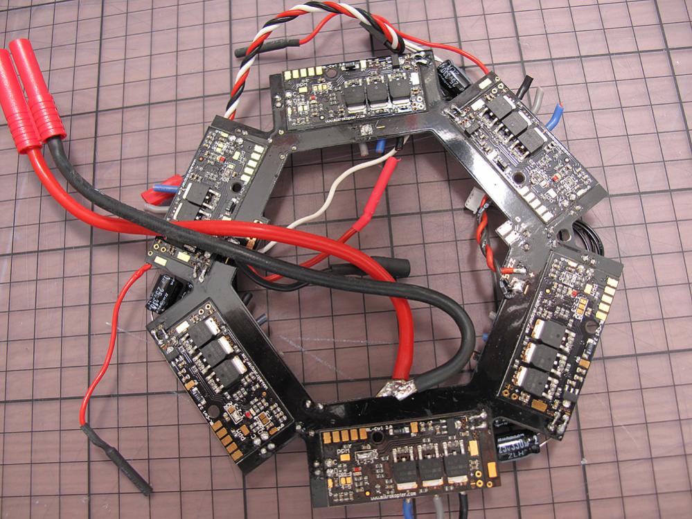

Next up were the various pdb connection cables. As shown in the pic:
A - 2mm bullet to each BL-CTRL
B - spare ground
C - Buzzer with jst connector
D - LED wired straight to the pdb
E and G - LEDs via the switching circuit
F - Power supply

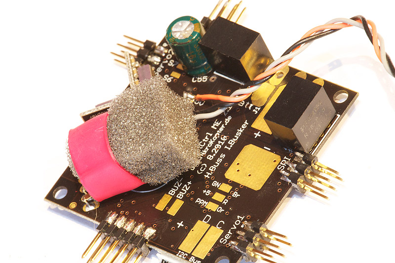

Final Sunday job was to re-foam the pressure sensor on the Flight-CTRL.
I used a piece of foam which i slit, almost in two, down the middle. I slipped this over the sensor and used a band of heatshrink to hold it snugly in place.
The heatshrink band is below the sensor hole. Would appreciate thoughts on this solution.

There should be a velco strap with the battery mount which you need both plates on ONE side of the gopro mount. The velcor strap is long enough to strop 2 overlander size 5000mah batteries to the mount plates so I am not sure what has happened to yours. The go pro mount should also come with a velco strap that holds it together.. I would go out at take some pics of mine but it raining, my workshop is locked up and I have a stupid o'clock start to drive down to London for a few days work.. grr I hate it down there.

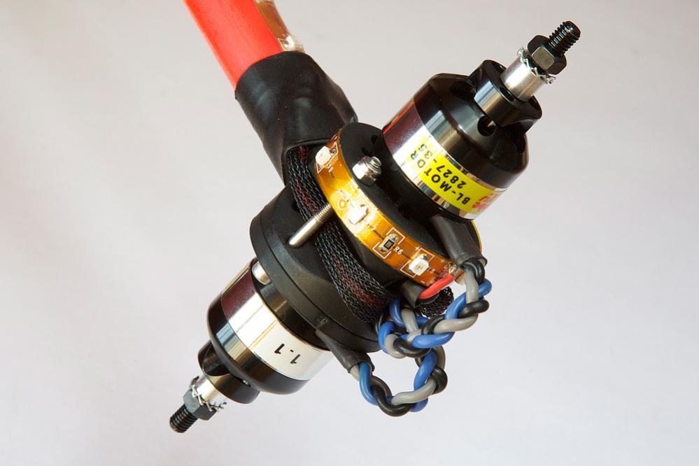

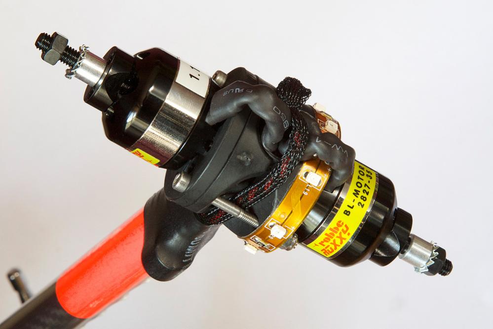

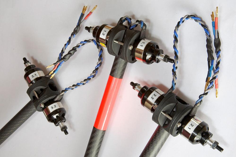

Lady wife out all day so had a full run on the build. By the way, I'm assuming this is of genuine interest to someone out there - the impetus being that i tend to trawl for images of builds etc before i get started, so the detailed pics are supposed to be of use to others planning a build. :tennis:
Anyway, here are the motors mounted and leads neatly platted…

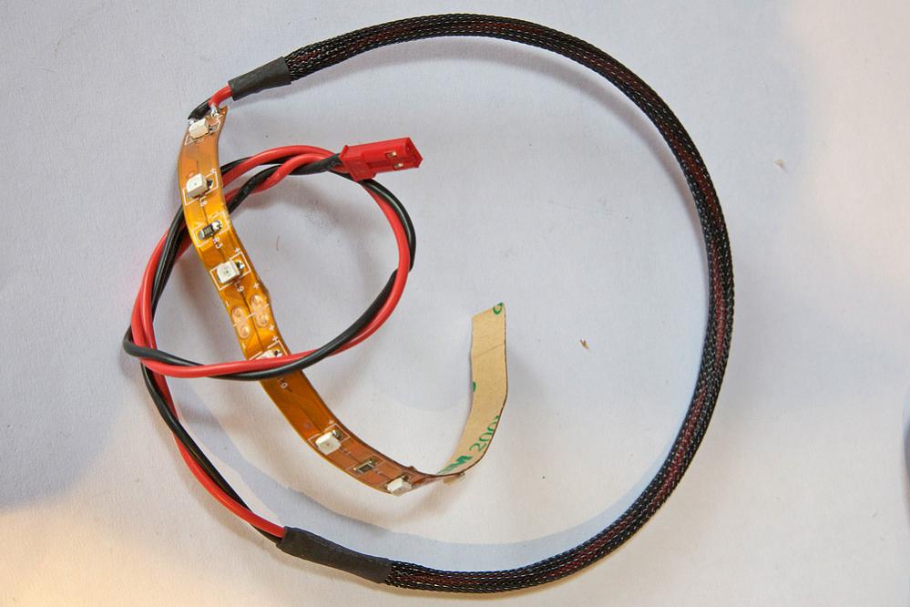

The original hexa had everything done by the book - with everything hard wired to everything else. I'm determined that this build is going to be much more friendly when it comes to fettling, so trying to have everything as modular as possible - with easy access. Lots of work now for less work later.

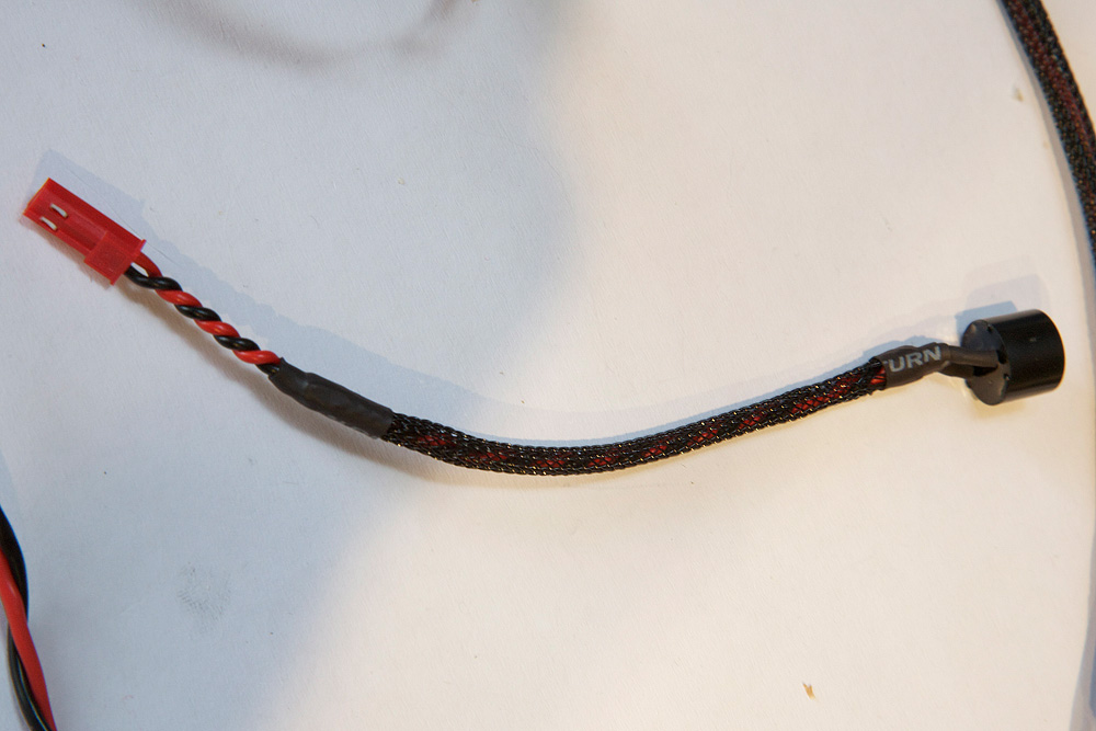

Here is the buzzer and one of the rigger led strips - easily removed/disconnected with jst plugs.

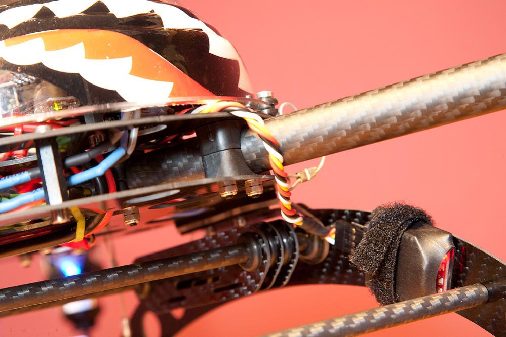

Next up the orange rigger cabling.
First pic shows the routing of the cable to the rigger LED strip - you can also see that i've wired the motor mount LED's up to the pads in the centre of the LED strip - to reduce cable run. Second pic shows the finished rigger from the other side, showing the buzzer mount and (now) protected motor wires.
View attachment 1301View attachment 1302
You can also see the new 5mm prop mounts and 8mm-5mm reducers on the motors.

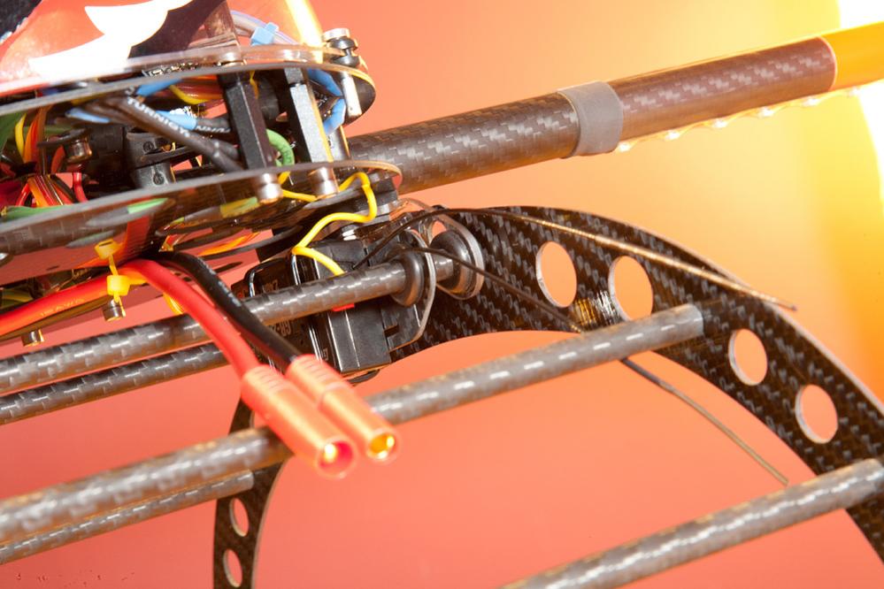

I farted around with this for bloody hours, but it's finally coming together now. It was also a right fiddle to get the finished riggers into the frame without it all flopping around, but that's done.

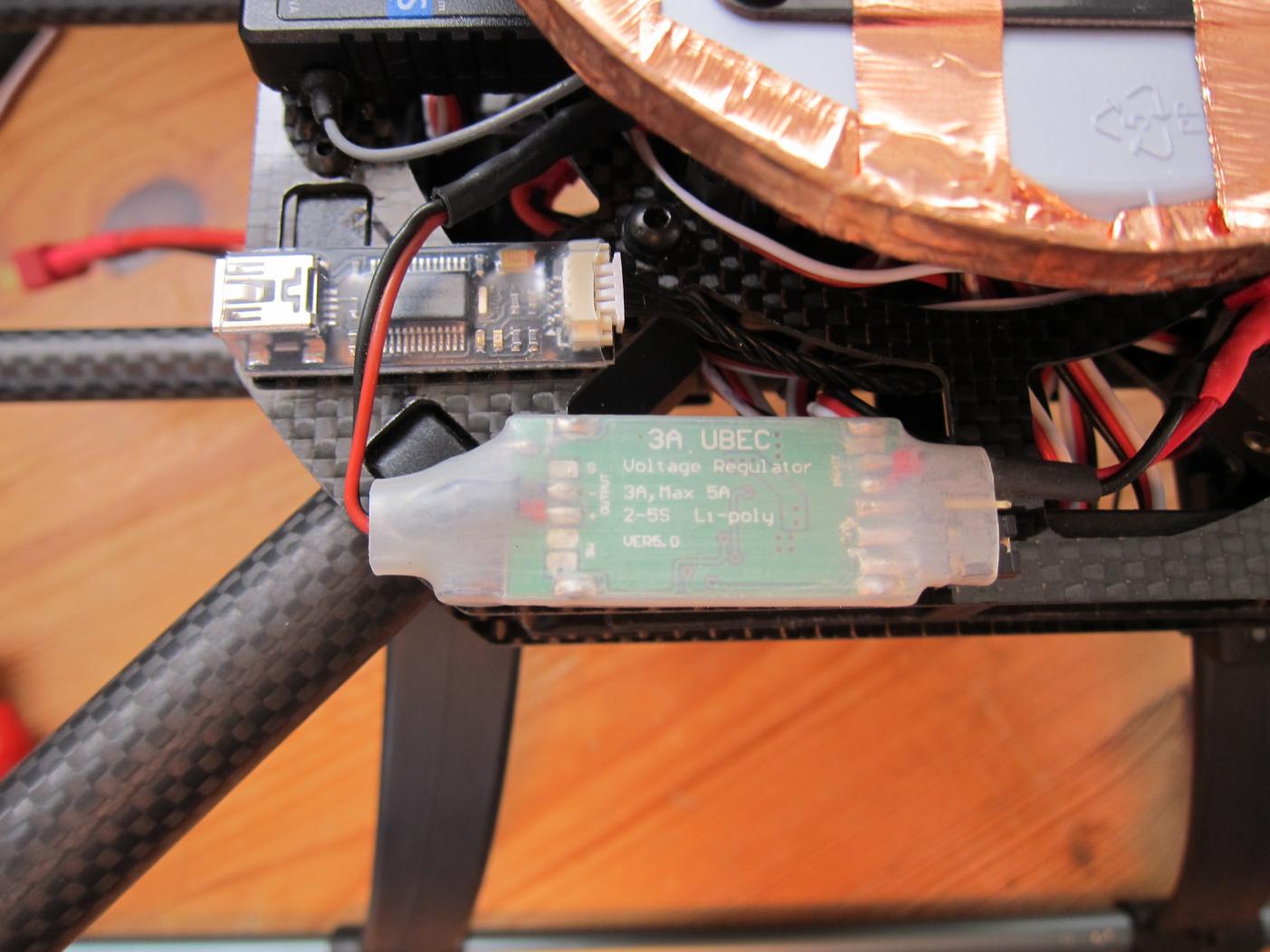

Final job yesterday was to tidy up my FlightCtrl board. I removed the spektrum connection leads, bridged the jeti jumper and cabled it up for the new radio as I'm planning to swap to an MX-20. Would prefer the new Jeti, but it looks like that's not going to appear until next year now and i really don't want to trust this build to my spektrum radio - too many stories of "Mk's going 'odd' for a few seconds while in the air". I'm a big fan of the DX8 and more than confident in it for other models - when using the full receiver/satellite combo, but my flying skills don't need the added risk of radio hijinx.
Again, in the original build i was a bit worried about soldering and heat through components, so i used a cooler iron and a fine tip. This was a mistake.
I've subsequently found that a regular size tip, as much heat as my 48w station can throw at it (455º) and being deliberate with each action to be the way forward. This means almost instant, clean joints - touch-and-done.

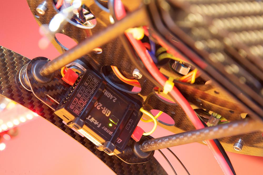

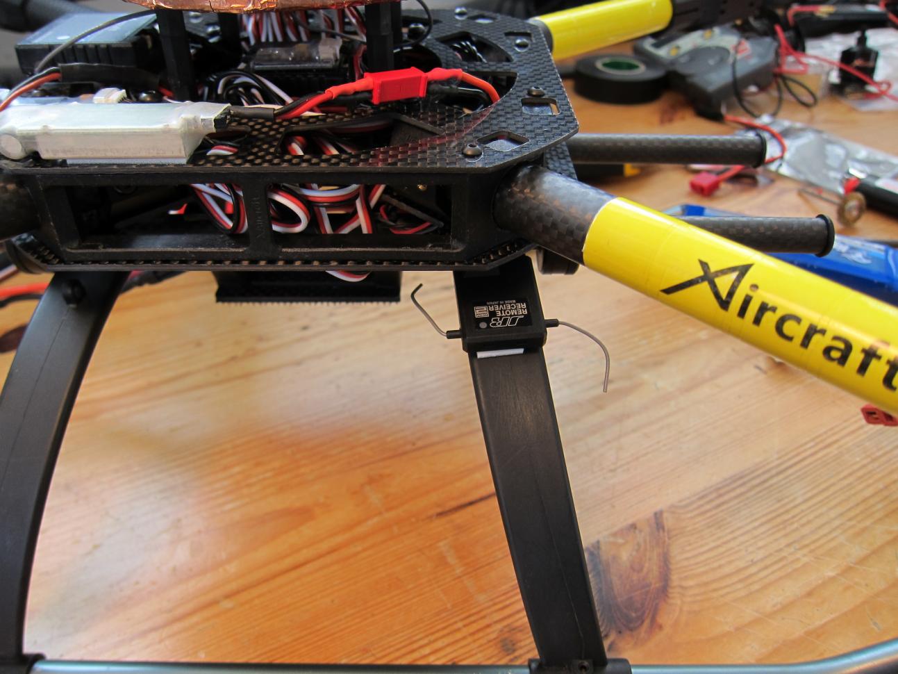

I've mounted the receiver against one of the landing gear rails with a couple of zip ties and it and the antennas should be out of harms way there.
View attachment 1361View attachment 1362
The only thing to double check now is the failsafe mode - which may require another firmware upgrade.

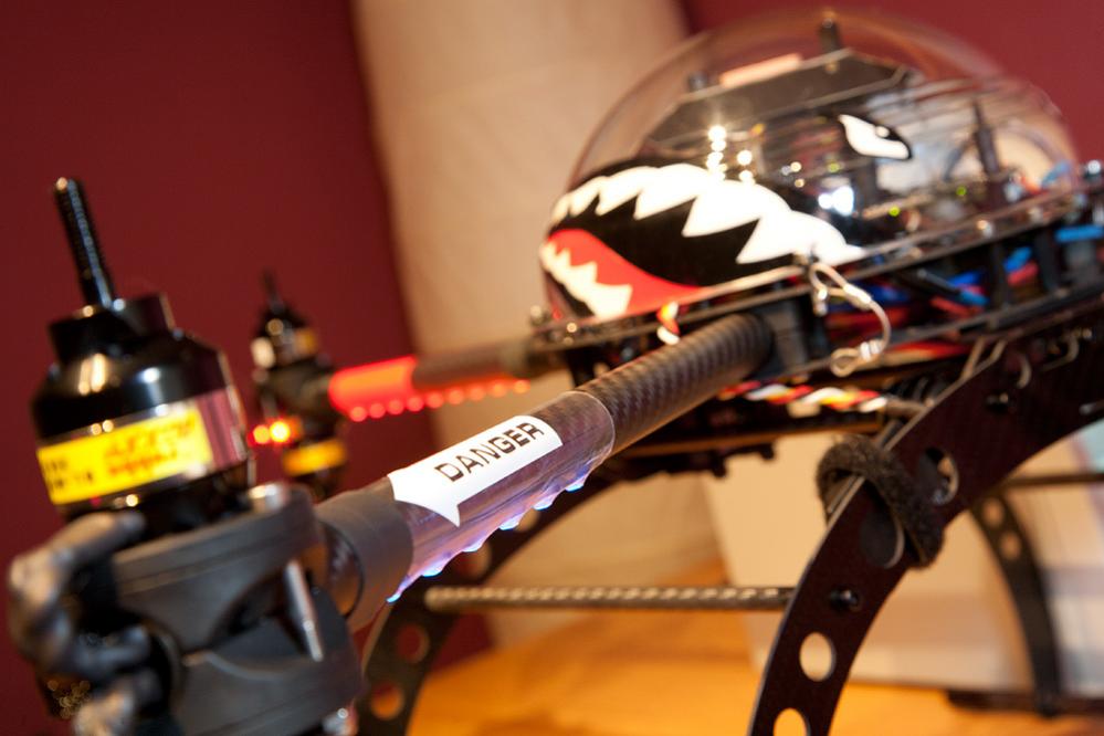

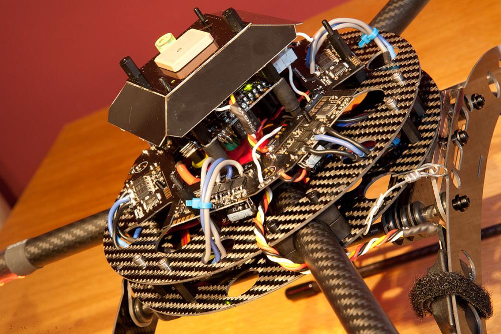

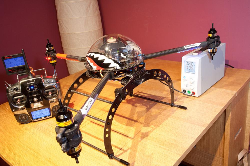

Final stuff included a few decals i cut for the inside of the dome and the riggers.
Would very much like an AV130 and some torxpower motors but that's going to have to wait for a few months unless i win the lottery.
Generally speaking i'm pretty pleased with how she's turned out - just sh!t scared of stacking her up on the first flight.
View attachment 1365View attachment 1366
QUESTIONs:
1. how do you Y6 chaps secure your props? Single nut and spring washer (those are what came with my 5mm mounts) or two nuts, nyloc nuts, thread lock ??
2. are there any specific Y6 check lists i should follow to double check everything before my first flight attempt?

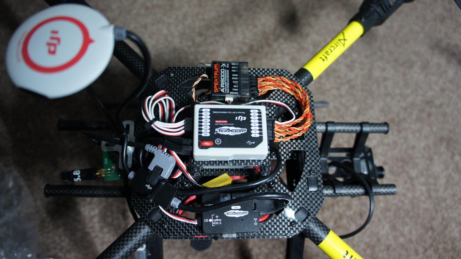

Yo Plingboot.. looking good.. I am sure people will have found this interesting.. where did you get your motor config file from?
What are the settings?
Did you work out the gopro mount from the photo I posted?
Props I use regular nut and plain washer thougt I am getting some star washers this weekend. I usually take my props off when transporting but just regular checks on the nuts tightness. I have seen a nice little torque wrench whick I may get but am just trying to find out what the recommended tightness is for my 6mm Axi prop adaptors.

Not fully worked out the gopro mount - missing velcro doesn't help, so probably need to cobble something with zip ties, I'll be adding my super simple gopro/tilt/roll mount to it later this week.
