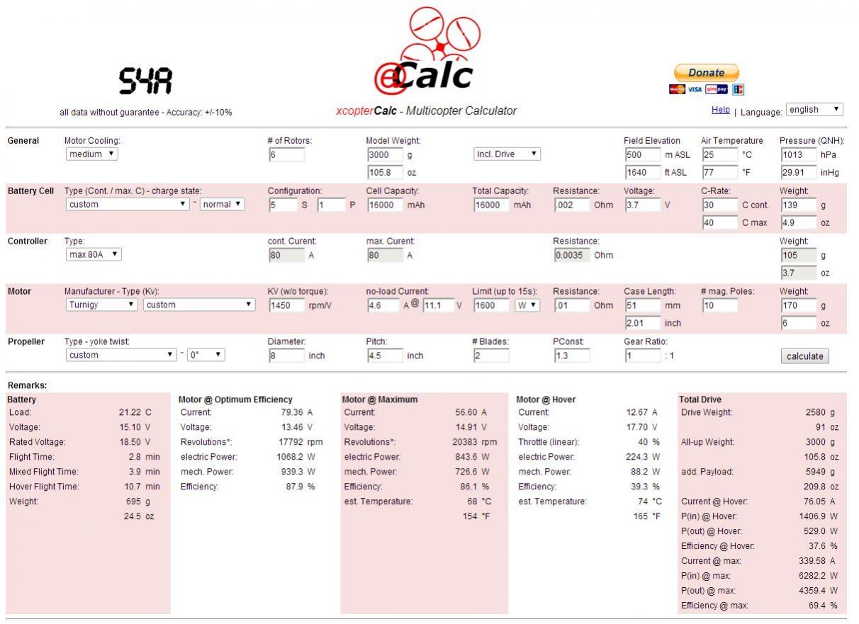

I ran it through an online calculator and will attach the results
So here are my questions:
Will 8 inch carbon fiber props be able to handle all that power?
Is there anything you would change to maximize the amount of payload we can lift with 8 inch props? (based on the online calculator, it looks like we can lift about 9 Kg including the weight of the vehicle)
Finally, is it realistic to expect 5 mins of flight time from that battery?

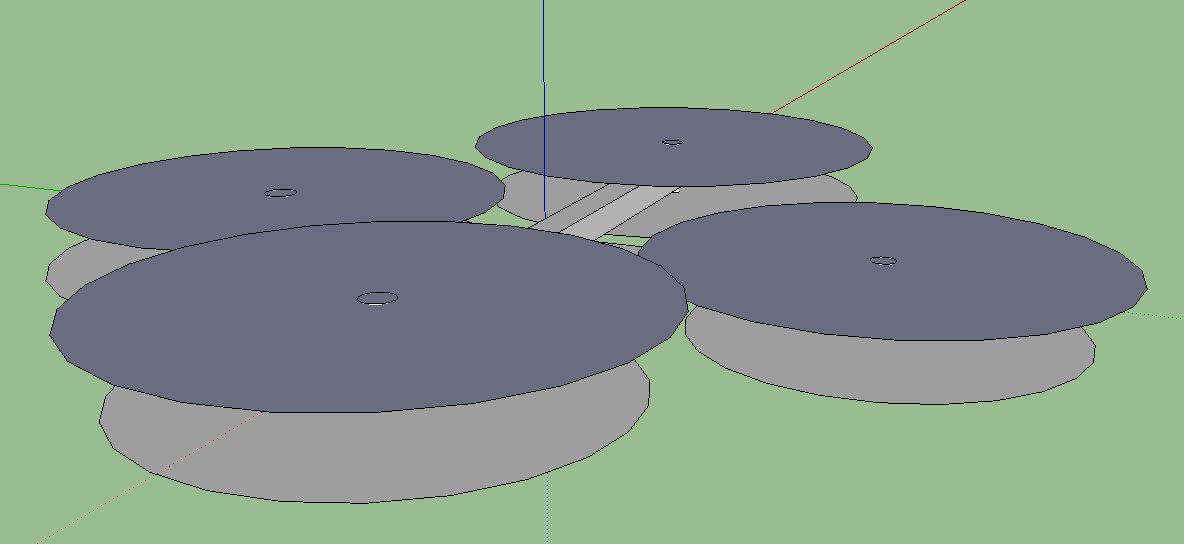

I skimmed through the overlap thread, and it looks like overlapping would be instead of coaxial (It does not look like you can overlap and X8 as that would essentially be 4 props on top of one another)
I did some drawings and it looks like the biggest props we can fit on an X8 within those size limitations would be an 11". How far apart do the prop tips have to be from one another, right now it looks like we will have about a third of an inch when they are closest together, will that cause any problems?
Right now I am looking at doing an 11x5 on top and an 11x6 on bottom, how does that sound?

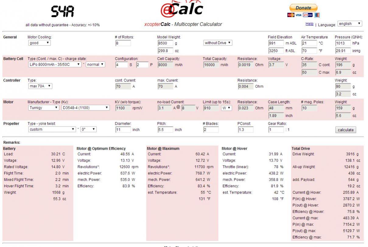

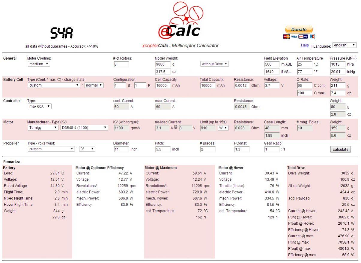

Here is my new calculation with the standard battery and temp/elevation
Also, That battery life is pretty bad, is there any way to improve it without strapping 4 batteries to the copter?
Thanks again for all your help!

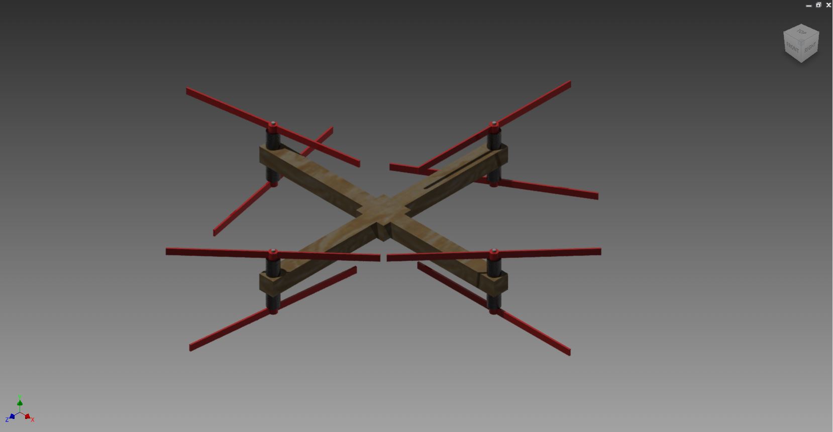

And here is a quick Cad drawing I did for an X8 with 11" props to visualize the size of everything:

Yes - 20% more pitch on the bottom is about right. Tips being that close might give you some trouble (airflow is "flung" off the tips) - overlapping slightly may actually work better - "interleave" the props a bit so you might be able to squeeze 12" props in there and avoid tip problems. All this is very weird (and interesting) as an exercise because of the size limitation - normally you'd be considering at least 16" props to carry this sort of weight. Since the total weight is what counts, you can get your flight time up by substituting batteries for payload - smaller capacity (and C rating) will be cheaper, so just pile 'em on there!
Not guaranteeing this will work, but it achieves your target flight time at 14150g AUW:

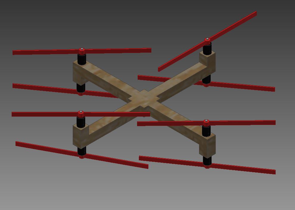

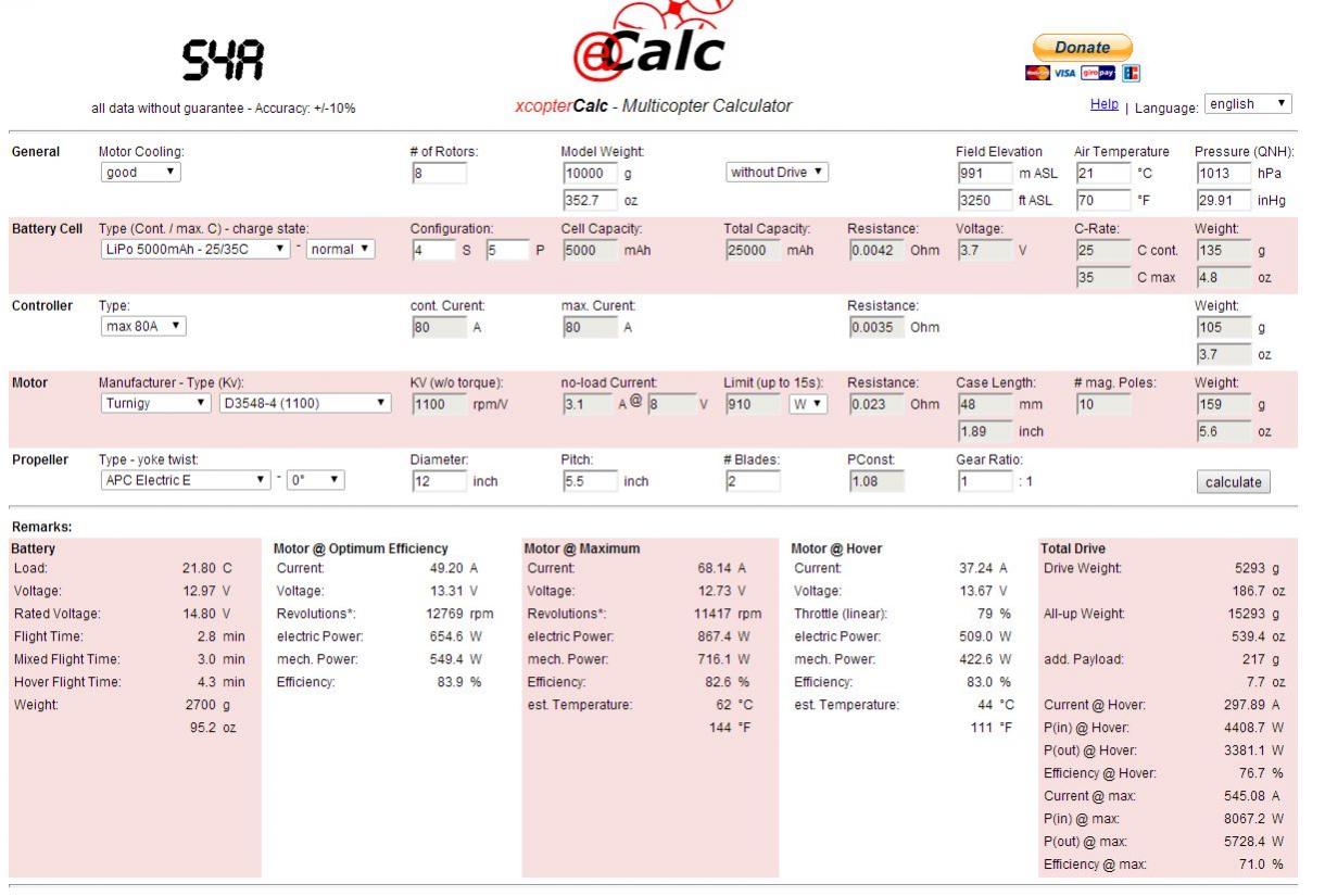

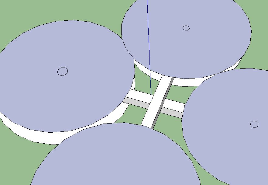

Alright, I have been playing with the idea of 12 inch props. In order to get them to fit in our size constraint they have to overlap by just over 1 inch (there is a drawing of this below). Do you happen to know how much clearance I need between the overlapping propellers?
I like your idea about using a pile of cheap batteries. I was able to get it up to a about 4 min with an AUW of over 15KG. 4 min should be fine because it will only be carrying the payload for no more than half the time, so the battery life should be much much better once the payload is dropped.
The only worry I have with this design is that it does not leave much room for the batteries and other various components that need to be mounted somewhere on the frame..... But since we are building the frame ourselves we should be able to figure something out.
Here is where I am at now:

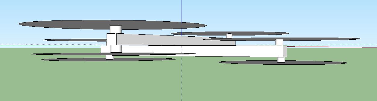

aricolton
One more stupid question I just thought of: Do I need 5 battery chargers? Or can I put the pack of 5 batteries, wired in parallel, into one charger?
Thanks!
jes1111
No - one charger will do - but you'll want to slow charge them to make sure you have the maximum energy in them so, presuming you'll need to do more than one run during the competition, you really want to have multiple battery sets already charged and ready.
JoeBob
