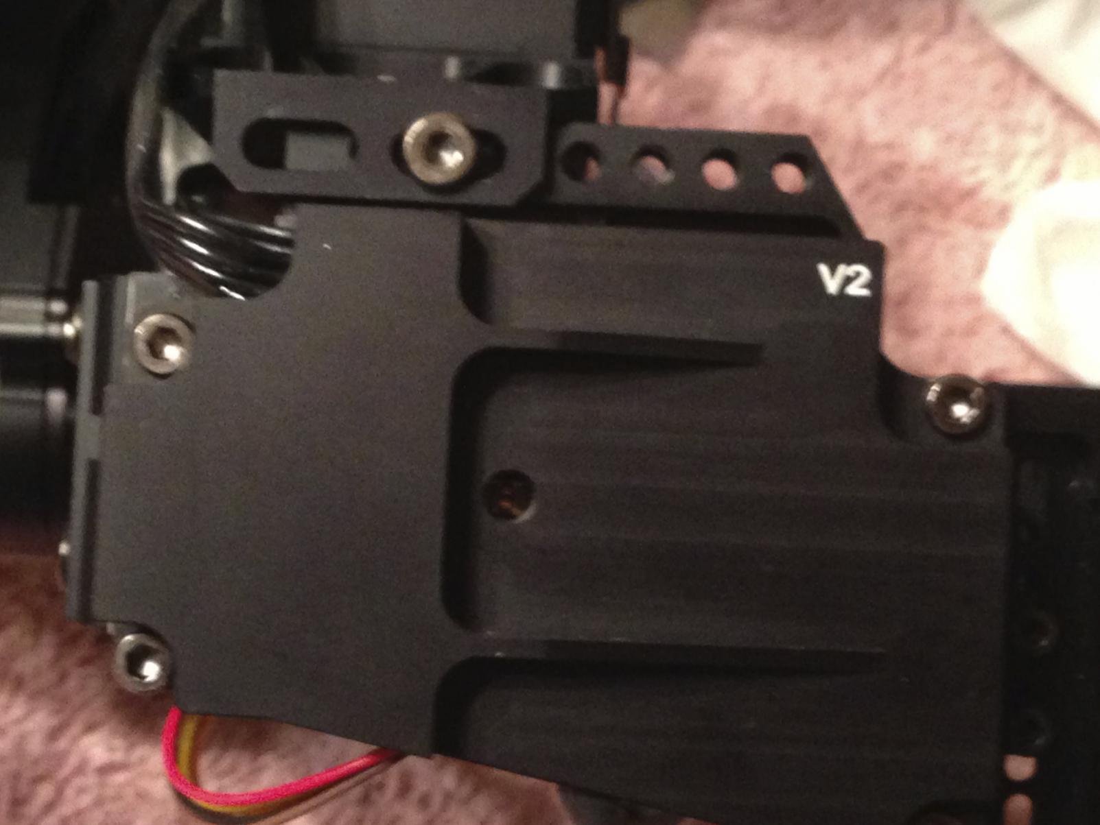

Here is what mine looks like.
Also the release notes say the following;
  • Video recording is available for Z15-N gimbal (AUX3).

Thank you Ed, this is really helpful. I'll check ours when I get to work Monday.
