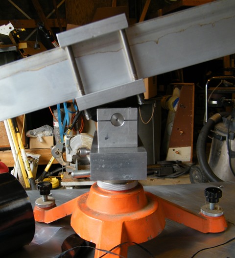

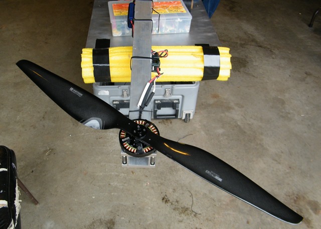

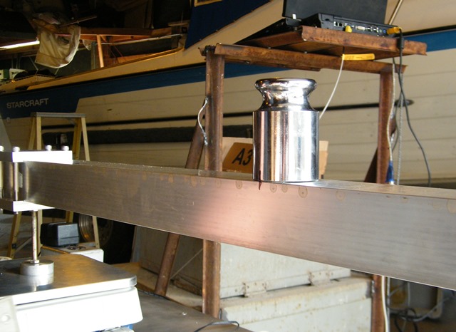

A simple hobby grade tachometer works quite well for obtaining RPM data without the need for reflective tape on a propeller. Back up the info from your Watts Up with a decent VOM. Calibrate your scale at several points, low, medium, and high. Most scales have some level of hysteresis somewhere in their weight range and it's good to find out where that is to avoid generating skewed data. If you can, perform your tests with both a TX/RX and a servo tester. You might find the throttle response range is considerably different between the two. I did using Futaba and tiger products. More throttle travel with the servo driver than with the transmitter, even after calibrating the ESC to the radio.
FYI, a thrust stand does not have to be at right angles. They can be a flat bar with a center bearing point but you have to assure both ends are equal weight and length from the bearing/pivot point.
