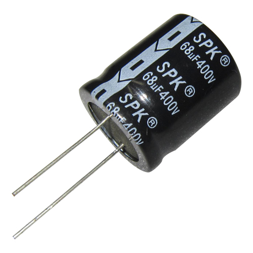

If it's the Electrolytic capacitors on the ESC's They are very susceptible to blowing with reverse polarity they are cheap and easy to swap with a soldering iron. It's where I'd start! Notice the white stripe with the - sign..That's how the power should be attached.
Thanks I have a local source for those so i'll give it a try
