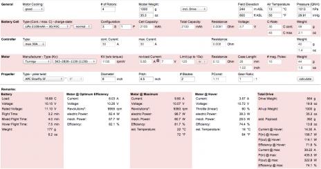

Here's a setup from eCalc. It looks good to me, but I don't know everything to look for. I had to bump the Turnigy motors up to keep the max power below the motor's rating (although it was right on the edge for the 2822-1090).

Not a lot of flight time with the battery selected. Try a larger capacity battery to see how it affects flight times. A little more AUW, but maybe increased flight time. I can say in the beginning of the learning curve even 3 minutes can seem like an eternity:highly_amused:
