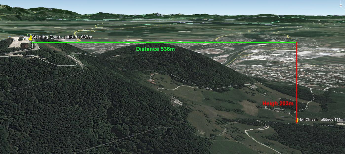

That day I went on hill (attach image bellow) recorded landscape over the fog. On the hill I prepare and start to fly like every other days. I replaced the 3 batteries. I flew between 300 - 500m away. I flew exclusively in Atti mode. When I put the last reloud of batteries, check the GPS Tracker also and fly in a straight line with a constant speed of 5 - 6m/s. At a distance of 532m or near 2min of flight, I suddenly lost all signals: Futaba 2.4Ghz, 5.8Ghz FPV Video Camera And GH2 camera, 2.4Ghz Quanum telemetry. I looked into both monitors FPV and Rec one, both show just snow. Quanum telemetry shows: no signal.
It lasted 2-3 seconds. X8 is already roll over and started to fall. For a moment (3 sec) I get all the signals back and immediately added elevation. X8 began to stop falling down (upside-down position). Adrenaline flown through my body like a drug, time has stopped - seconds seemed like minutes. I raised both hands up in order to get the best signal. On both monitors and telemetry Quanumu I got the video image and telemerty info back. This moment lasted for 1-3 seconds and then I lost again. I immediately activated Rescue System - Paracshute on Futaba switch, then with both stick indicate for shutting down the motors and watch how the x8 disappeared in the fog. I was thinking only one thing: whether the parachute opened??? I sent an SMS to GPS tracker for crash coordinates. There was no SMS reply.

Here you have raw video (I needed 2 days I got a clip) and the overall situation of Flight (Google Earth).

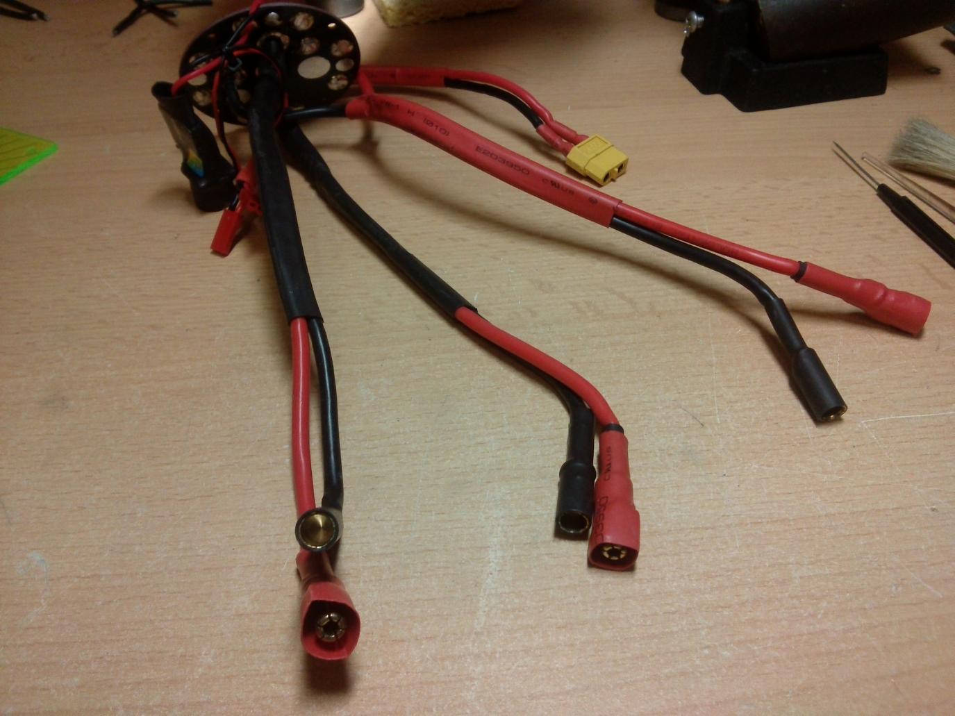

The fact that you lost/regained everything simultaneously suggests to me a possible power problem. How are your batteries wired? Do they converge to a single attachment point on a PCB or do they go to three attachment points on a PCB? i.e. is there any part of the power wiring that is carrying the full current? What power connectors are used?

have 3 x 4s 5800mAh batery wired parallel with 250A Power Distribution Board and using 5.5 bullet connectors. Forget to mention that a sec before flip moment I was released sticks (no elevation at all), so heli just start to stoping. And after crash when I founded on the ground all batteries are just fine, no damage at all and telemetry shown 3.9V per cell. On my 85% throttle elevation test (never go beyond), under that weight, shown near 100A, a lot bellow warning... Another thing is to consider that I reloaded 4 set of batteries before crash and fly like butter. I thing in current situation is distance and some kind interference included?
