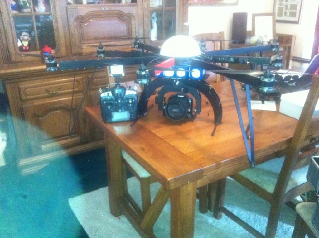

Well been building this for a few week done some flights with out gimbal but today I got to see it with the gimbal on place need some brackets to fix it on..
What do you think?

Would you care to post any details for a proper analysis? Motors, arm length and composition, I think I can see the props, but not 100%, battery type, poer distribution solution, esc size and type(custom or std.)?
Based purely on what I can see, I'd have to mention the first couple things that stand out at me, but only because you asked: firstly, the landing gear seems to be a newer revision of Droidworx landing gear? Mor importantly, if this creation in able to balance without 2 of the landing legs touching the table for support, then why, my I ask, are this support legs there to begin with? Seems like added weight for nothing, but it's possible that the photographed angle leves something out.
on a more positive note, one thing that I do like, but would need to see in person if the brightness causes any associated vision problems during dark night flying, but at first glance I like the brightly lit center dome. Feels like that, and some fore/aft colored LeD indicators (on key booms) would make for a trippy night-fly.
Good luck,
Jonthan

The specs
Volcan frame 1200mm x 900 mm this is this size so it fits in the car and I can have big props
Motors are 3515 t motors
ESC's are hobby fly 40amp
15" slow fly props (carbon)
Controller is DJI with 50 point way point
The gimbal is a prototype from www.fpvcameramount.com
It's nice but I have modded it to take 4 batteries and made the camera place bigger as I use a 77mm lens and it was not balanced..
I'm using ramazzi OSD love it for the money but I'm tempted with the DJi unit one so you can see the true sat signal.
I have fat shark goggles
It's still being built but my plans are to have two fpv tx's one for flying and for still shots...
I have a very modded skyfly tx with telemetry, I'm planning to use the trainer port to control the gimbal through a second tx giving me 16 channels on one tx (sort off) but it will also be there for two people control..

your correct there extra legs I'm leaving on so I and fly with a without the gimbal. When I took the picture the gimbal was not attached I have made a bracket today and the heights are all about the same now..... In the end the gimbal will be 360... So the extra legs will need to come off then.
nytram
This looks good, it also adds protection.. I have to say I'm very please with it, now all we need is to make it Pan with out making a big difference to the hight
