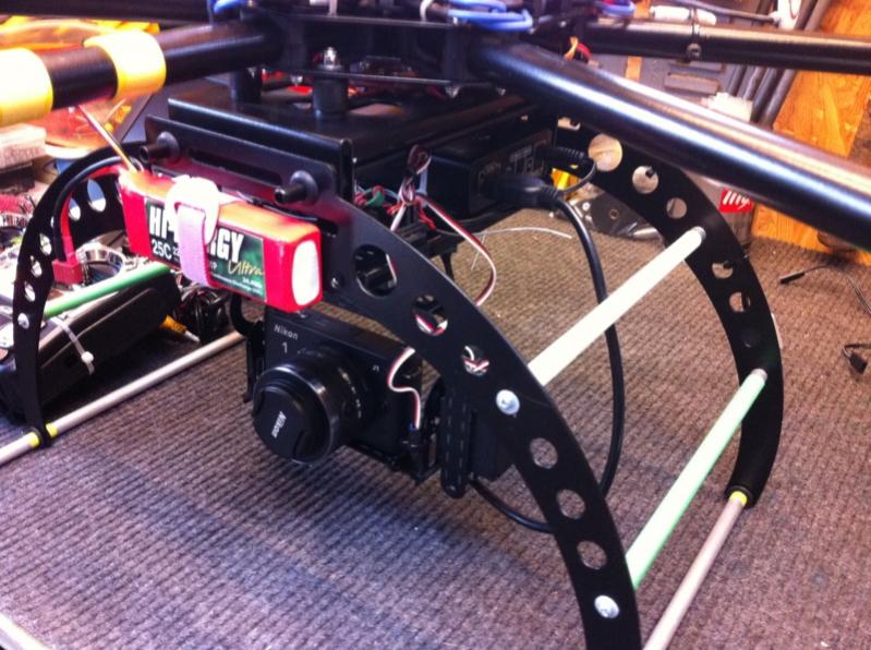

I use one and it works a treat. All you need to do is hook up a ubec to feed it with 5v. I have a separate lipo so I don't have to wire it up to the heli harness. Here it is just under the main frame.

Thanks the converter sounds like the way to go then. What weight is yours?
It is deffo the way to go, IMO easier than buying a new camera if you are happy with what you have already have.
No idea about the weight, I don't have digital scales, but not very heavy, maybe 200g or so. Problem is that it's a bit bulky, but perfectly manageable if you have the space.

Yes, take it out of the case. Case is nothing but air and is heavy. I use a small Recom inline for power reduction to 5 volts. Rather than plugging it into the board with a plug I soldered the power wires to the bottom of the power connector. See a good shot of the board over at quadrocopter.us. The HDMI converter only costs about $40 US at Amazon.
