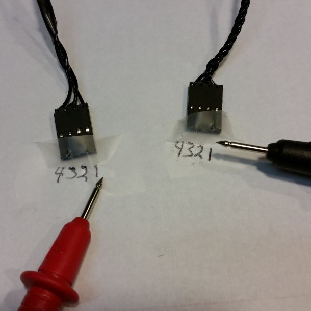

I just checked today with my continuity checker that pins 1 & 2 check ok but pins 3 & 4 are different. On one end Pin 3 goes to pin 4 and the other end pin 4 goes to pin 3. Is this normal? See photo below.

Check your cable connection to your GPS unit. This same thing happened to me, suddenly zero satellites. On inspection the GPS cable was loose.
