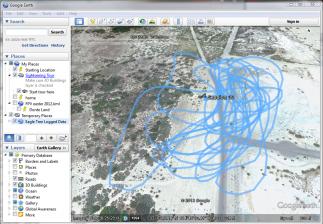

to do what your asking is in the fpv OSD's like eagle tree, EZosd, Dragonlink OSD, and probably a few others. each of them would have to be put together except ezosd by immersion. The others need seperate parts that add up like gps module, barometric altimiter if you want real heights for the 3d map of what you flew. with a video transmitter and a unit like eagle eyes by Eagle Tree it shows it real time, EZ OSD has an iphone app for live readouts, dragon osd has something similar.
