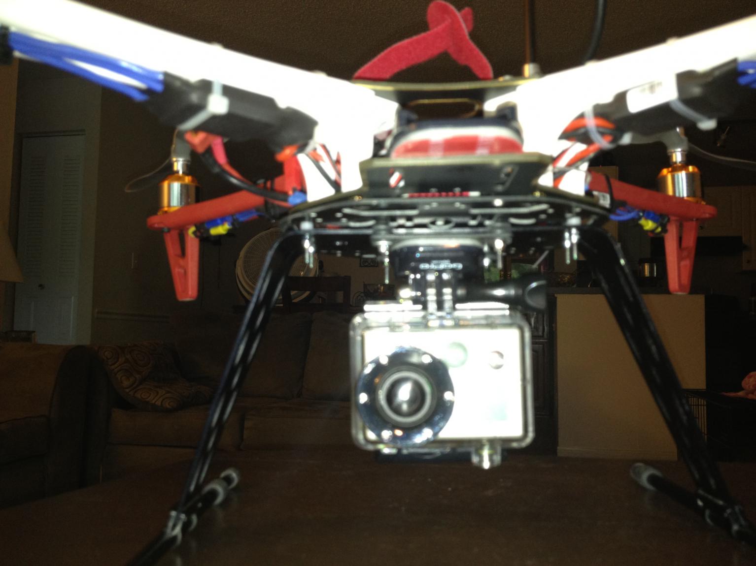

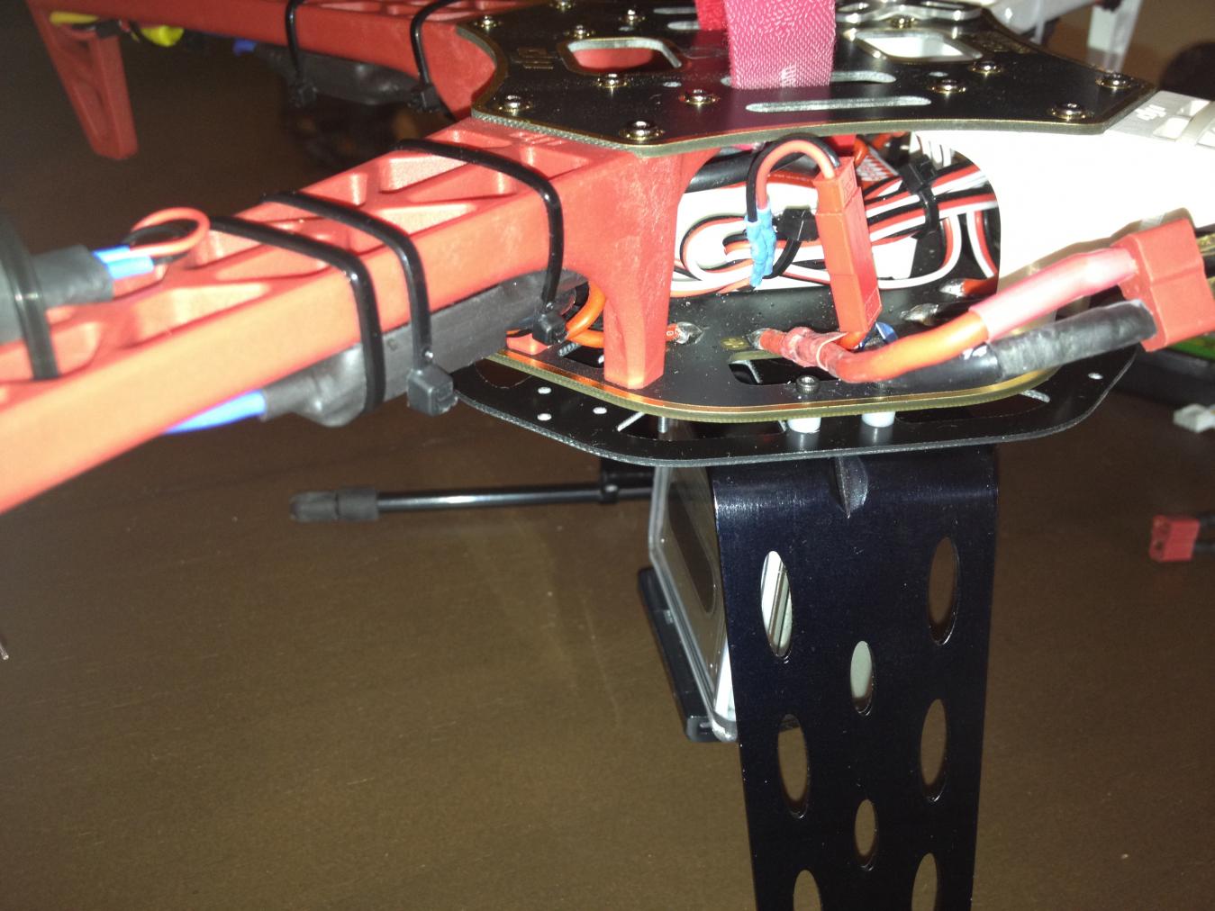

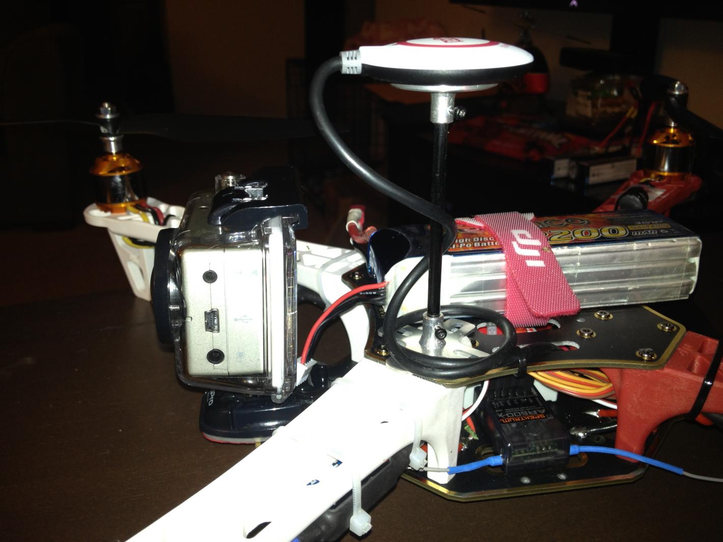

1st post here. So I got my Naza and GPS all setup on a F450 frame using a Spektrum AR600 rx and 7DX tx. All functions setup except course lock and failsafe (tx signal loss) since the rx does not support it. The next step was to install my GoPro Hero2 on the front plate of the F450. Without the GoPro on, GPS works perfect but once I turn on the GoPro, I lose partial GPS signal making position hold unreliable. I have the antenna mounted on the front left of the F450. Do you think if I move the antenna to the left back I will not have this issue? I tried to re-calibrate with the Gopro installed and on but still have the issue. Wondering if anyone else is having a similar issue.

I only have the GoPro attached with no addons. I do have full gps coverage (yellow led - atti / green - gps) with the gopro off. With the gopro on, and full gps coverage, the leds fluctuates from 1 to 3 red, 1 yellow in atti mode and the same with gps mode except one led is green rather than yellow. I noticed that sometimes the green or yellow will blink but then quickly changes. Lock is unreliable with the gopro on. I may have to try and mount underneath the frame.

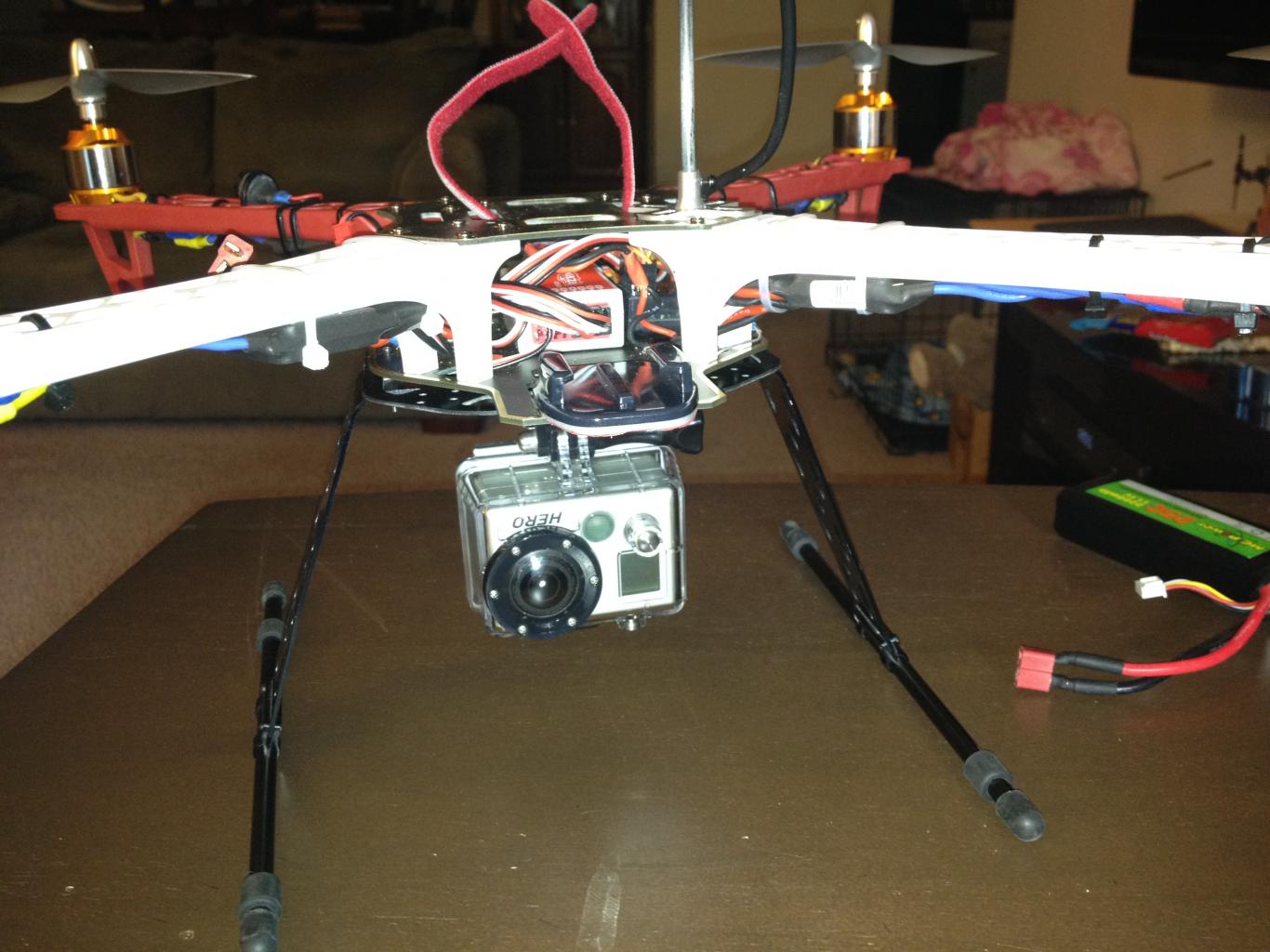

I will need to purchase the Toroid and will give that a try. No, I don't have the WiFi back for the camera. I did a little more testing. I noticed that although I don't get a steady flashing green led on GPS mode when the GoPro is on, it holds position but not locked on. I have the metal landing legs that were from my Walkera MX400 and will install this on the F450 frame with the GoPro underneath. This may work. I'll post an image once installed.

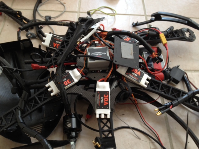

The GPS antenna runs along the left side of the frame. The only wires that are in front of the frame are from the esc's. See both images. The 1st one shows the front and the second left side and receiver.
View attachment 5040 View attachment 5041
