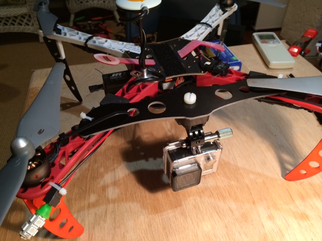

Here's a mount that works well for me. Not fancy at all. I used an IrisAerial batwing (don't think he sells them anymore but you could check) and a standard GoPro mount. Drilled a hole in the batwing and used a nylon screw for the GoPro mount along with the GoPro mount's double sided tape. The batwing is cable tied to the F450 arms. Works quite well. Got the idea from someone else on this forum a while back.

I wouldn't enjoy editing all my video while standing on my head...
Or losing quality when rotating it.
Unless there is a feature in the GoPro to invert the image, you'll be wearing your Fatsharks upside down.

the GoPro works either inverted or upright

that mount looks like something I could make if I had to.
