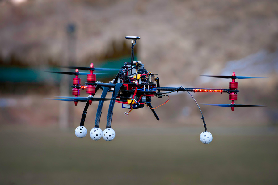

I've heard this happening before, but I thought it was some setup/user problem. My WKm works perfectly, very stable on my Carbon Scarab ysix. So today I decide to try the return home function. I changed my 3way switch from GPS-ATTi-Manual to GPS-ATTi-Failsafe. Get a quick GPS lock, no red lights and up I go. Flip the switch from GPS past Atti to Failsafe and wait. The craft starts back, but then pitches violently to one side and starts to spin! Tried three times, all with a total lack of stability. My GPS is located far from any electronics as you can see in the photo. Any Ideas?View attachment 3058

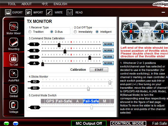

Went into my Assistant software to try this and thought I should also check the firmware. With everything on the calibration stick position display is going insane. The stick positions are moving all over the place. I suspect my receiver (sbus) and rebind, no change. Back to the firmware, it's the current version. Upload it again and the erratic movement is gone. Weird and probably not related to my problme, but who knows. OK, holding the sticks off center and flipping the switch to fail safe.... no effect on the stick position. Here's a screen shot, they still go where I move them. View attachment 3081

srbell
Ok, the erratic behaviour is back. Looking at the calibration section, all four sticks and flight modes are randomly moving all over the place along with a RX-ERR flashing. Swapped the receiver and changed the transmitter with the same results. Being I'm using three channel sbus receivers I plugged some servos into channels 1 to 3, the roll, pitch and throttle channels. The servos are steady and centered. I also have a sbus decoder which agian shows no erratic behavior. I thought maybe there a problem with the assistant software or usb cable but the gimbal running off my WooKong is going insane. Maybe this is the reason for the erratic flights I experienced during RTH function. Anyhow, untill it gets firgured out I'm grounded. Any help would be greatly appreciated!
srbell
And now it's gone! What the heck is going on? All sticks now show center. The flight mode jumps a bit from gps to failsafe, but it's better. Still probably not a good idea to fly.

srbell
Fired it up again and back to all controls going crazy, roll, pitch, throttle, yaw, gimbal and flight modes. Same RX-ERR. Of course it's not an RX error as the receiver operates servos fine on the three available servor ports on the RX and the sbus signal is fine (testing with a sbus decoder hooked up to the same servos). Seriously considering tossing this controller and putting in my purple APM 2.0 board, at least there's a reset button. BTW, callibration didn't fix anything but it was worth a try.
