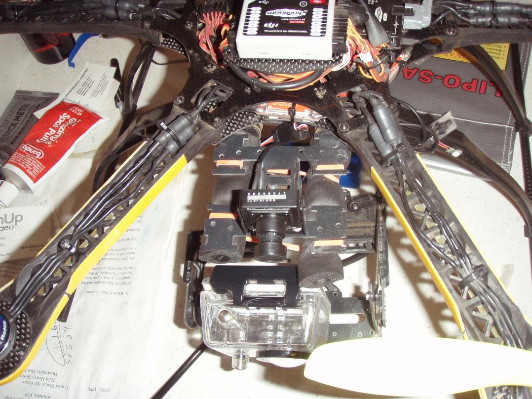

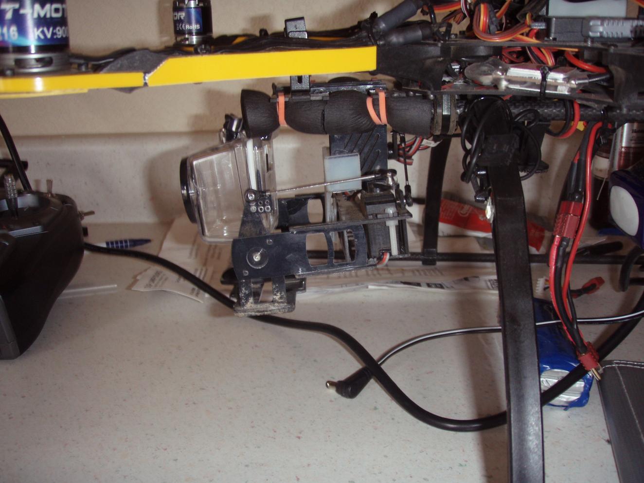

Here's the set up.
X/A Hexa
WKM with 5.10
mt2216-900kv & mt30a esc's
GoPro Hero2
mc6500pro with DCS2600 digital servo's
Props and motors are all perfectly balanced.
First the pic's of the set up, (below)

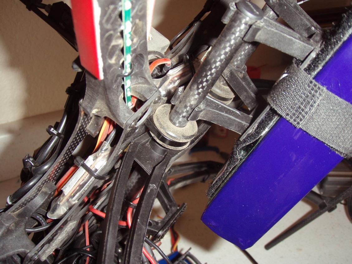

As you can see, I just have the gimbal mounted on top of foam on the load rails, secured by rubber bands.'
I should recieve another 4 load rail mounts and grommets tomorrow. I was thinking of removing the foam and installing these in the foam's place, put some Zeal tape on top and place the gimbal mount on top of that, hoping to eliminate some of the shakes.
In assistant, travel on both pitch and roll are at max, no binding.
Pitch gain is set at 35 and roll at 65.
View attachment 5498View attachment 5499View attachment 5500

I need to re-center both roll and tilt, I know. I had made some position changes to the ball link positions and did not re-level, so keep that in mind.
The pitch and roll is the best I have been able to get it.
Would like to know how to get this set up better, either mechanically or in software.
