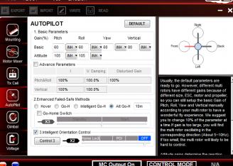

Okay, I have 2 F550, 2 WKM.. both on 5.12 now. Futaba SBUS setup.
both using DJI 10" props.
using 4000mah 4S
between the 2 is huge difference. In the auto-pilot section. one is across the board 110.. stable, smooth.
the other, even swapping same props and battery. I cannot seem to get it to even take off smoothly. It always launches and seems like it has a hard time initially balancing and sways to one side before it levels out. By that time, I am doing a bit of throttle up and need to lower my throttle to keep it from zooming up.
any help would appreciate.
if I go higher, it launches better, but in GPS mode, it seems to move around.. seem like it is uncomfortable standing still. Not like ESC bullet twitchs.. just bouncing around.
KS
UPDATE: Seems that I clicked default and started at default.. it seems to be much more smoother.. but still wobbles randomly in mid flight. Now all is at 100.. will start from here again.

interesting... I connect, go to autopilot, click default.. "write".. go fly.. results
come back, connect again, go to autopliot, click default again.. and write again.. and test flight.. different outcome.
I did this 4 times.. and all four had slightly different behavior. from horrible take-off, to smooth take-offs, touchy altitude change pushing the throttle way below 50% on the stick to get it to stop climbing.
any thoughts..?

After clicking default and write, did you completely redo all the settings including re-calibrate the TX and the compass?
no, did not... I just clicked on default, and write... waited a bit, uplugged.. powered off.. took it out about 20ft away and powered on, waited for GPS purple flashes.. then took off.
interesting, maybe I should do that GPS calibration each time? Is there a way to calibrate the gyro?

It is my understanding that if you make any changes to the MC (WKM hardware, new firmware, or reset default) that a complete redo of the settings is required.
TX Calibration, Compass Calibration & re-entering all previously entered gains / adjustments.
I have never heard of any Gyro Calibration other that what the Factory as done.
After reset to default, It is like starting over with a new unit out of the box.
I hope this helps.
