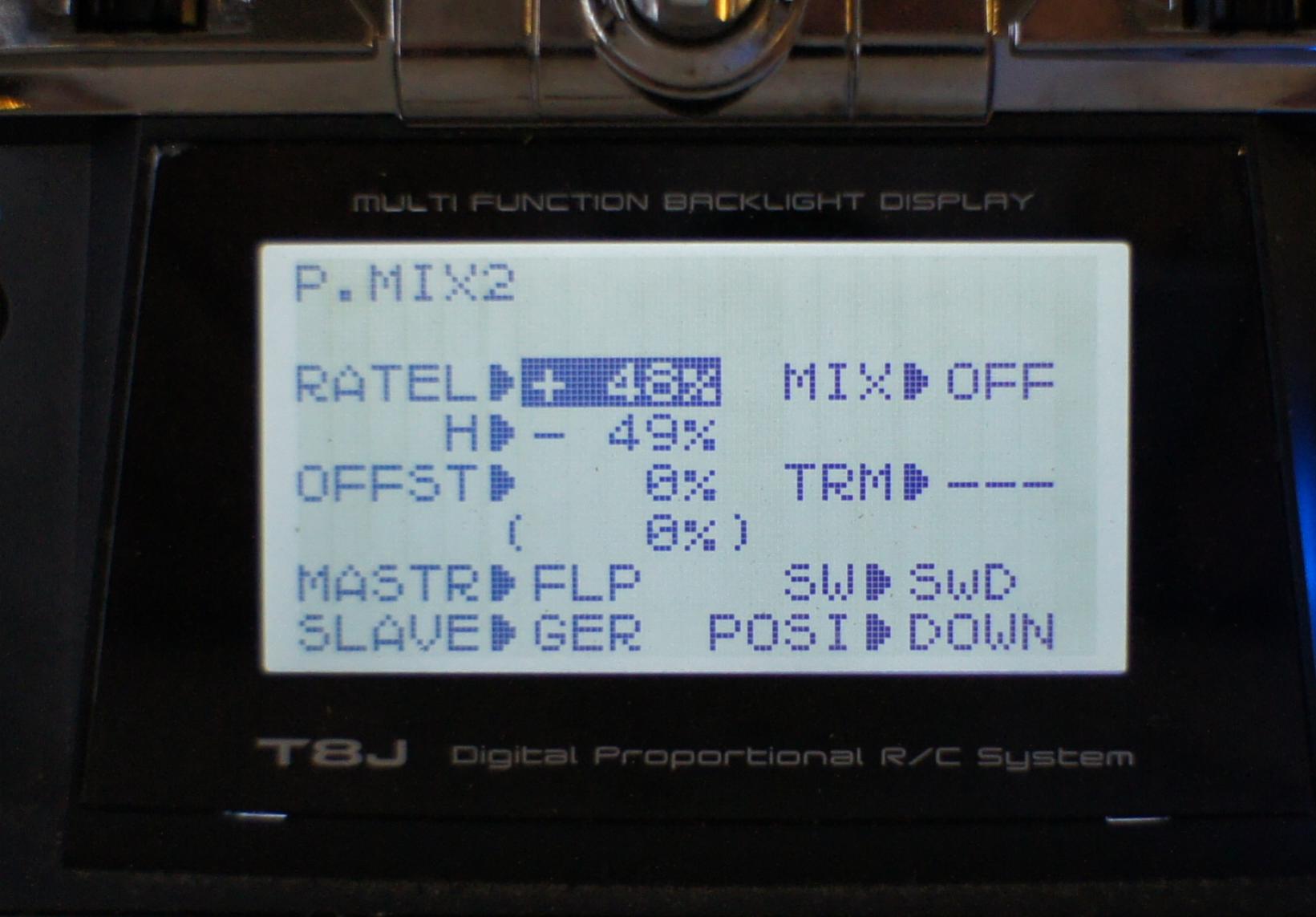

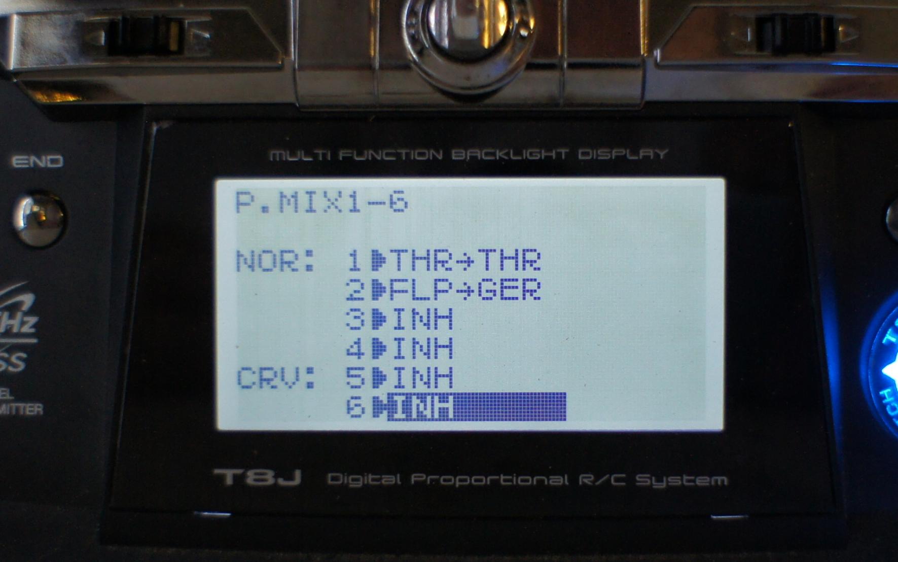

Could anyone help me set up an 'in radio' mix on a futaba radio, to trigger the RTH function please?
I want to set this up so it an 'in radio' solution, rather than taking up a channel using the wkm function.
Haven't quite got my head around the futaba menus and ways of doing things yet…
here ya go
on the naza, i can only get it to trigger in atti or gps atti cause of the way it's mixed in. in man when you hit the switch it goes off the screen, so it might still be triggering, never tested it, but the light comes on right not turned on
Edit:
that's not sbus or wk so your actual ch may vary

plingboot
thanks, will have a go now.
I did have this working on my DX8, but in the process of switching to futaba.
If you look at the tx monitor in the DJI tools, when you activate this mix in manual mode it goes off to the right, but if you look at the bottom of the window the mode indicator changes from 'manual' to 'failsafe' so i always assumed it'd work.
yea, that's what i thought,,, it just doesn't light the blue thing so mentioned it. I've got 2 of these things setup now, they both fly gps mode straight as an arrow, but i've never flipped the switch or ran out of signal so it's never been on........ god i hope it never has to. that scares the crap out of me,,,,,,, what if it locks over,,,,, what if it goes inside my truck where i turned it on... all these things runnin through my mind
