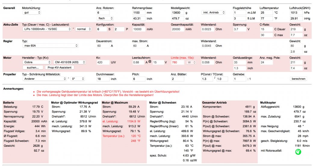

There is no way. That motor produces 1001 grams at 50% throttle on 6s. That means the Alta would have a AUW lift capacity of 14 lbs?!? And it can carry a RED?
Looks like the Alta uses this motor with some mods: Cobra CM-4510/28
Seems to be nothing too special. Anyone more detailed infos? Greetings.
Yeh I think it's unlikely since one of the founding members of freefly systems was the guy behind Xera motors - awesome rc Heli motors back in the day, so I think they have what they need in house to produce there own motor design!
Sure it´s probably not the same motor but it looks kind of the same.
Also it could fly an 13600g payload according to eclac.

I had this same discussion with a motor manufacturer back in May as the size of the motor and the claims of thrust just do not seem to add up...
I guess users will report the actual facts....

I meant nothing derogatory toward Freefly, but agree with those speculating that the motor in the release photos & literature appears to be a 4515, and that motor would not produce the required thrust to effectively lift a RED with the current FC & ESC. As I currently understand the Hobby Based Brushless motor industry, there are just a few manufacturers who can produce the quality of motor anticipated for this aircraft. Additionally, the Cobra CM-4510 motor pre-dates the Free Fly Announcement of the Alta, so it is reasonable to believe that the design is proprietary to Danlions.
Perhaps there is something else in the equation that we do not yet understand that would allow this size motor to produce lift beyond that currently produced by the Cobra CM-4510 series at a 50% or less throttle as is currently used as a sweet spot for multi-rotor design.
