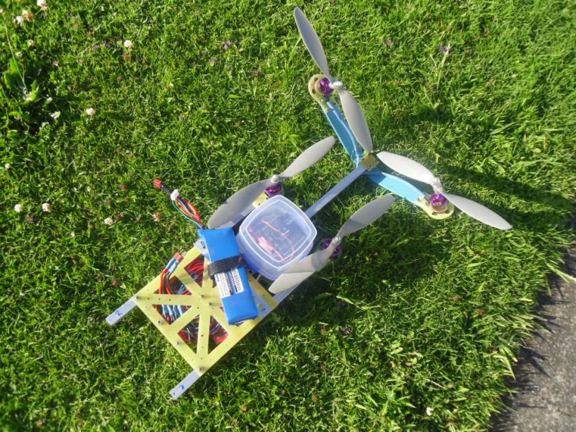

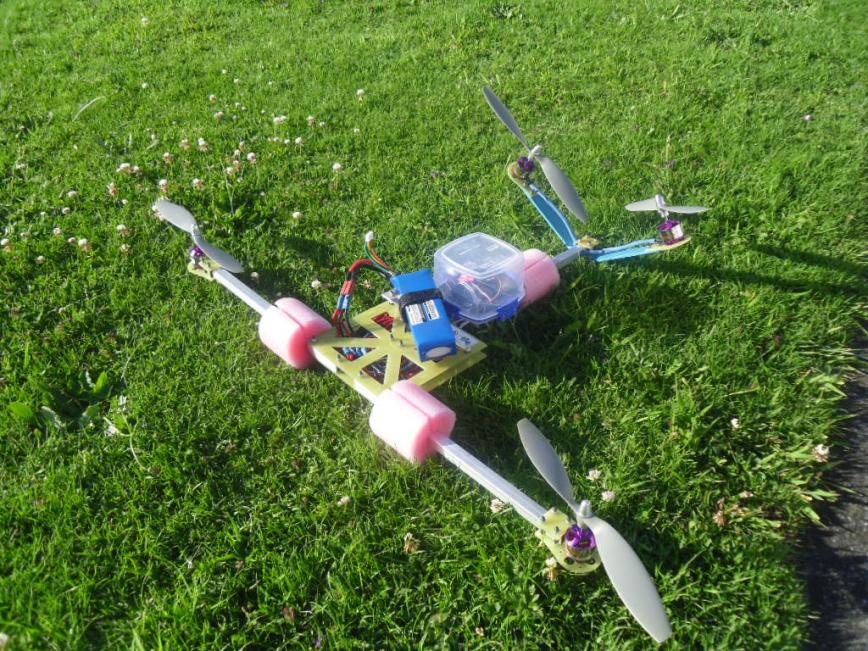

Heres my latest build, based on my favorite RCtimer motors (2630/14 750 kv) spinning 10 by 3.8 apc props, turdy plush 25 amp esc's, seperate SBEC, 4S 3000 lipo, 1200 grams dry (no lipo) and 8:30 safe flying time.
The frame arms are 12.7mm box section aluminium tube, centre plates and motor mounts 2.5mm G10 fglass
The flight controller is copter control, and the mix is a custom, but close enough to a Y4, so any FC that has a Y4 option will work
width is 650mm motor to motor and 450mm long
folded shes about 500 long and 250 wide, centre plate is 150mm square
needs a smidge more tuning, the wind was causing some oscilation, to much inner loop gain
since the video have swapped transmitters, nice to have a proper throttle stick now (before it worked from 25% to 75%)
View attachment 2019View attachment 2020

I see you noticed the big empty area up front - go pro is going there, unobstructed view, no props in shot :)
At 1:12 it shows what I love about how these fly, i can't get a quad to turn like that
The mix is one I did for CC for vtails/y4 but for each frame I normally tweak the rear motor thrust and yaw to suit the weight and prop sizes

Mine are just as bad.... hahahaha. Have you thought of using wing nuts on the foldable arms? Might make it even faster and more portable?

@stacky - good idea
@Denny -yea have toyed with that idea, have two motors that are good for 3kg thrust each
