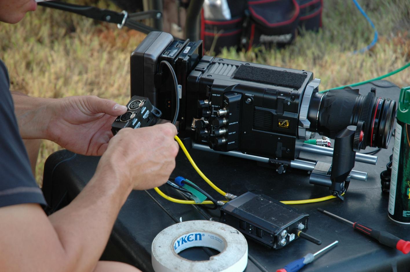

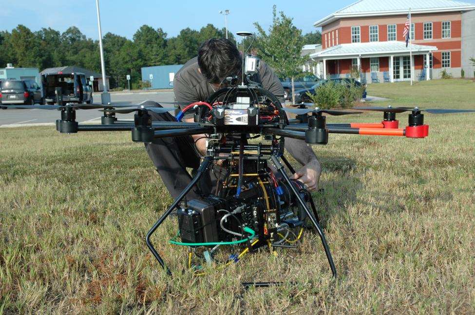

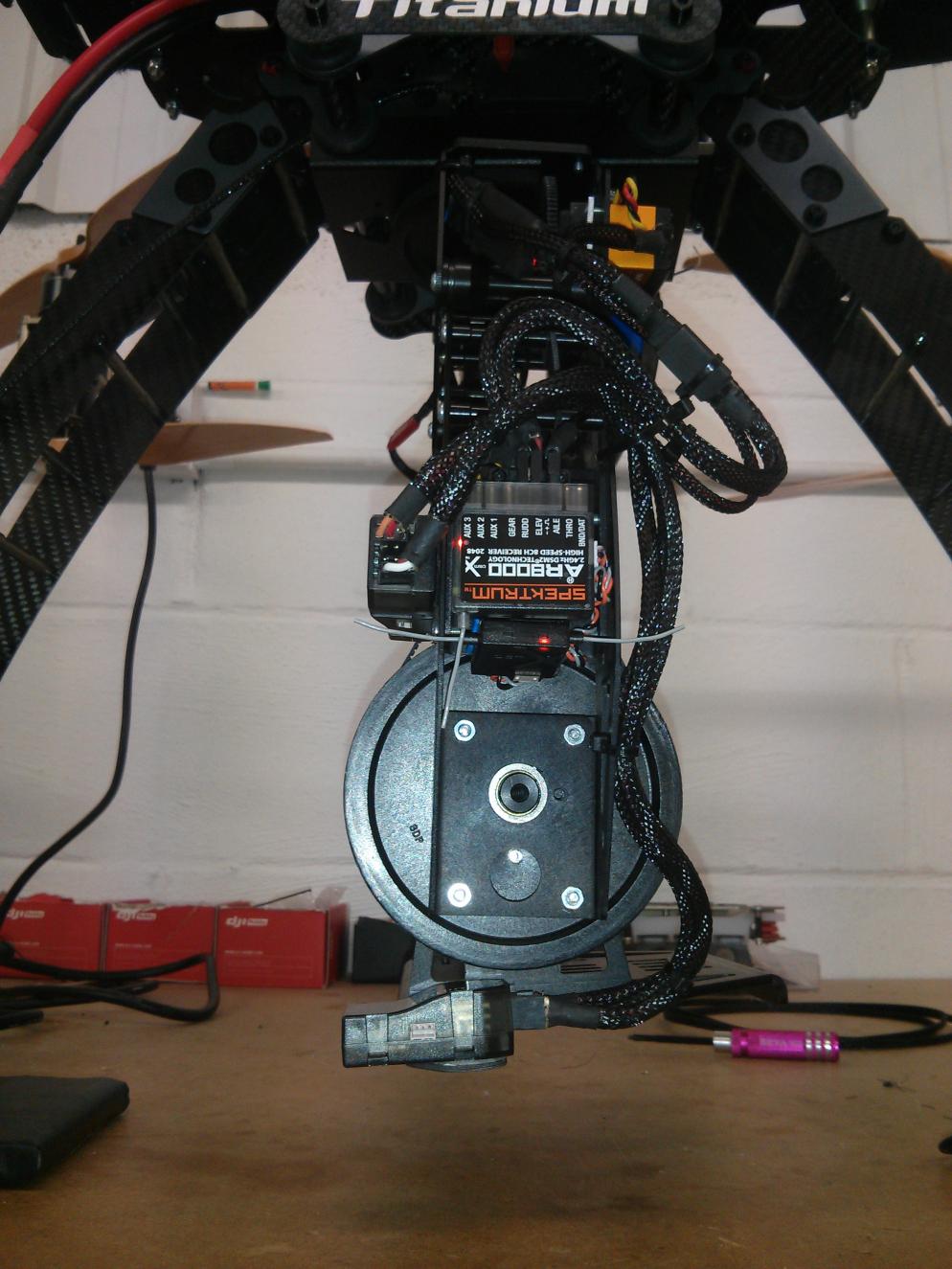

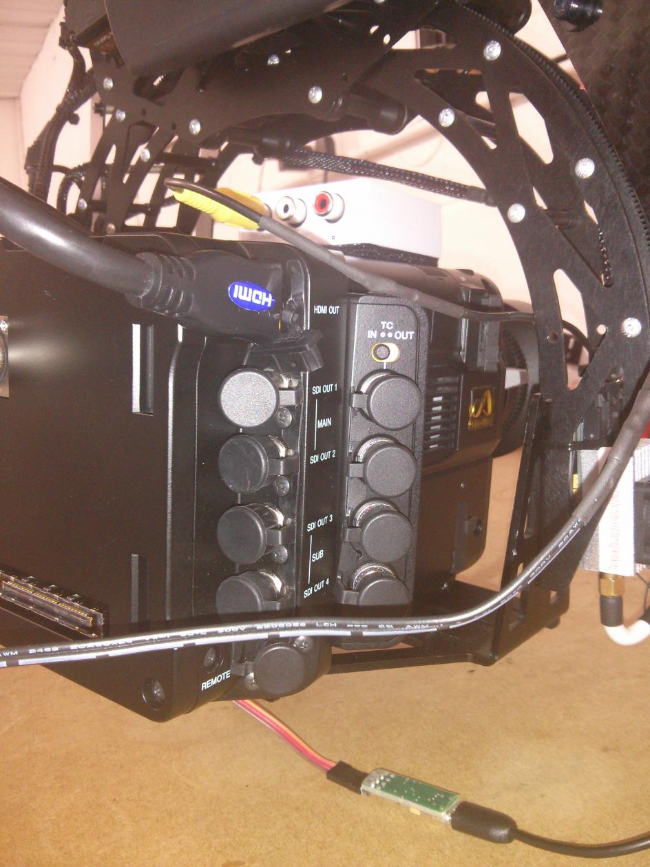

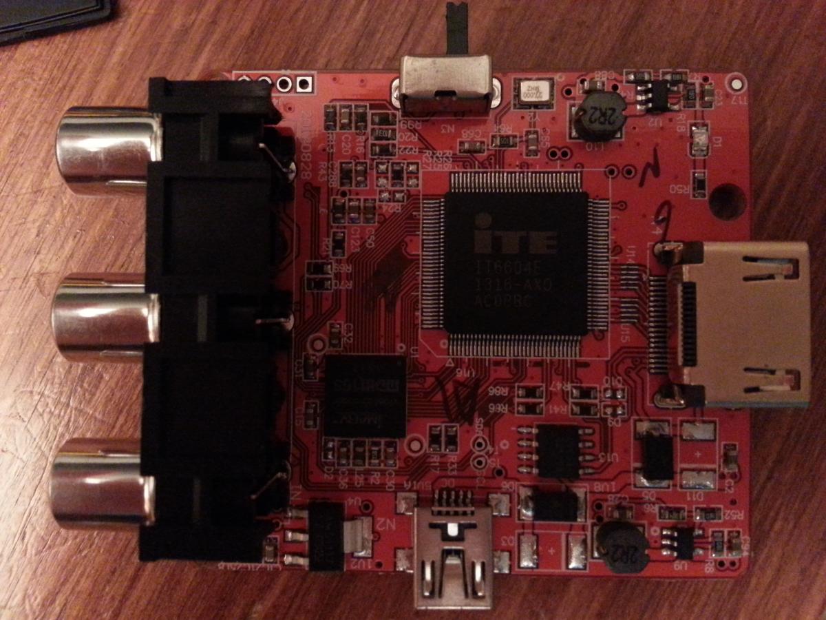

So it was an interesting shoot! I ended up with the F55 on the epic tray used upside down as I had my Kopterworx anti-vibe plate on the stock tray and DID NOT want to remove it at the time. As you can see in the pics I did not have a lipo to power the Sony. Had I known a few days ago I could have built the 4 pin to EC5 but this client being a price client and not a service client, communication was terrible and I thought we would be flying the mark3 up until the day before. Anyway, my Kopterworx HDMI converter WOULD NOT work with the F55 at all. Very disappointing. Not sure if it was a progressive vs. interlaced issue or what as daylight was almost done and we decided to fly the F700 instead. Again the KW converter did not work but my cheapo HDMItoAV saved the day. I need to figure out the converter issue cause that little guy cost to much not to work. Had the F700 balance almost perfect but with 20 minutes of daylight left we flew. Shots were perfect and exactly what they wanted. Got a round of applause which is always good for the ego. Take a look at the photos and critique away.. Still not totally happy with the way the gimbal rocks in the DW quick detach setup. Seems the rubber bushings are just to soft. Even with non aggressive flying I have to be crazy smooth starting a move and finishing, otherwise the cradle rocks and the skyline just doesn't compensate for that. Cant wait to upgrade to the colibri or something similar. Would love to figure out how to stop the gimbal/landing gear assembley from rocking like that.
Stripping the F55 down..
Cabling nightmare as we were trying everything to get video out of the camera
1stAC ready to shot himself as he could not get the menu up on his monitor and
they did not have the Sony viewfinder onsite. No Menu = No HDMI out settings
