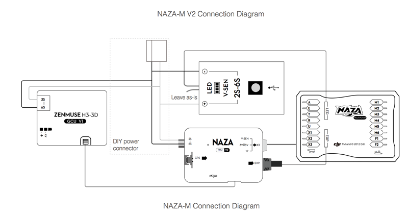

eskil23
Wikipedia Photographer
If I'm not all wrong, The NAZA can not both control eight motors and a gimbal at the same time. There are eight ports out, the last two can be either motors or gimbal control.
Des
Your right unless you are using the DJI H3-3D and CGU Unit. The gimbal connection back to the Naza M is via the Can Port and this leaves F1 and F2 available connection of motors 7 and 8. Here's how that looks.View attachment 23460
