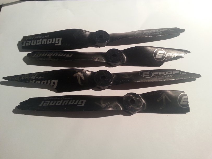

Only because I have no pride will I admit that not having a Kill-Switch when landing a failed Auto-Tune cost me $40 in props. Bent RX antennas (straightened with fingers) and scratches on my Ublox Neo M8N, but nothing else serious.
