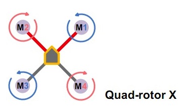

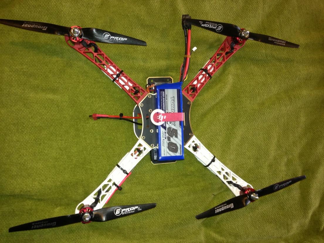

I have it set up like this with the writing on the top with the red being the front.
The rotation is set up like this..
Which ones are backwards (as in upside down)?

It looks like the props are reversed, in the photo above.
Verify by turning each prop by hand, with battery disconnected of course. And look at how the prop cuts through the air.
