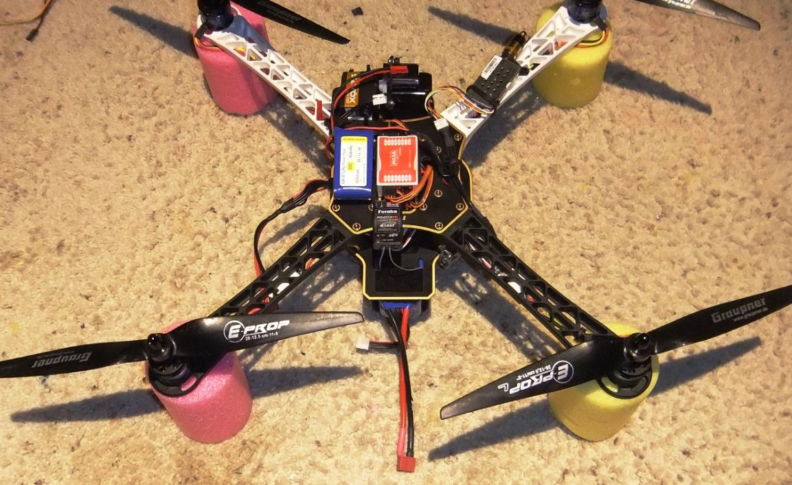

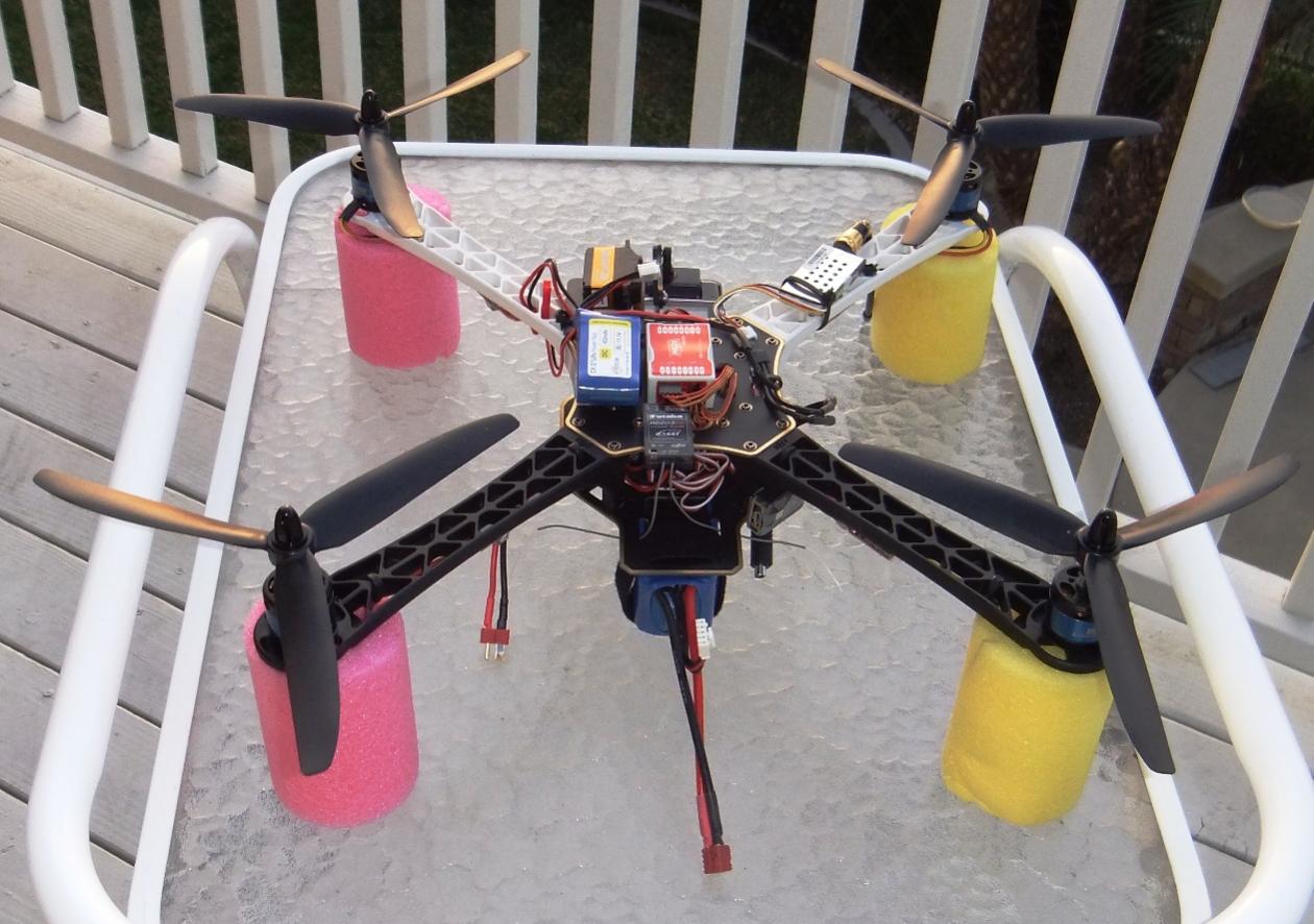

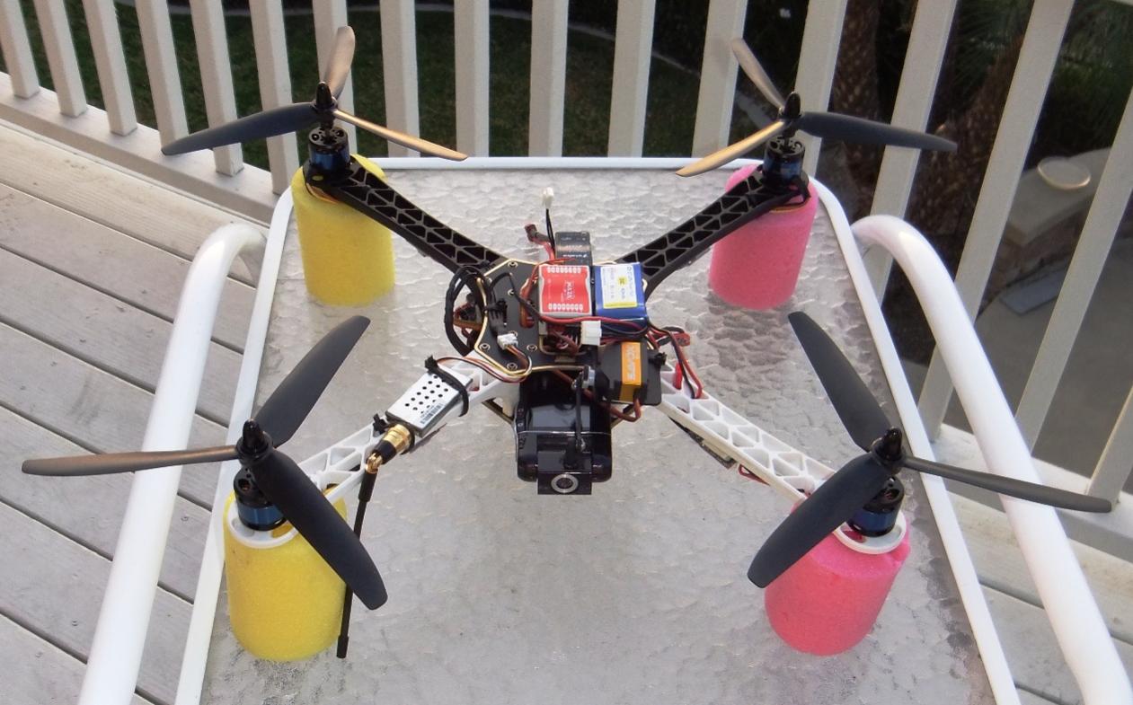

Although I haven't flown it in over a year, I used to have quite a bit of fun with an FY-90Q - equipped Gaui/ VC450 transplant, as an FPV platform. I decided that the F450/Naza build I was working on would be a perfect replacement setup. I used the AKE ESCs and motors that came with my XA Hexa combo kit and added the Sony Bloggie that I used to have hard-mounted to the VC-450. The Bloggi is basically just Velcro'd to the lower F450 plate. I added a Savox servo, to control the lens tilt mechanism, and so now I at least have stabilization in the tilt axis.
The problem is that this little guy is way over-propped, with the 11x5 Graupners, running on 4s, so I'm having a heck of a time getting the gains adjusted, to take out the wobbles. I really need to use 10" props, but I don't have any of the 10x5 Graupners. I've tried balancing the stock 10" props, but there's still a slight bit of the high frequency vibrations getting through to the video that I just don't see with the Graupners. I found before that the GWS 9x5x3 props, when balanced, have lower vibration levels than the 10" 2-bladed variety, so I might give a set of these a try. I've got a whole box of them :)
Here's the video of the maiden flight:
Pretty much the whole time I was fiddling with the gains, but I never really got the wobbles out completely. Also, after the first flight, I moved the battery to the bottom, and added some pool noodle "feet". I originally had the pack mounted on top of the Naza.
-- Gary

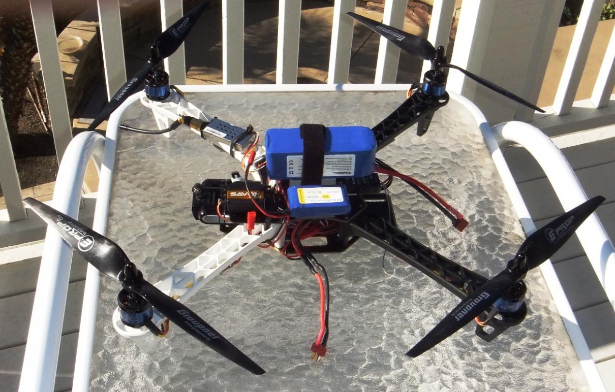

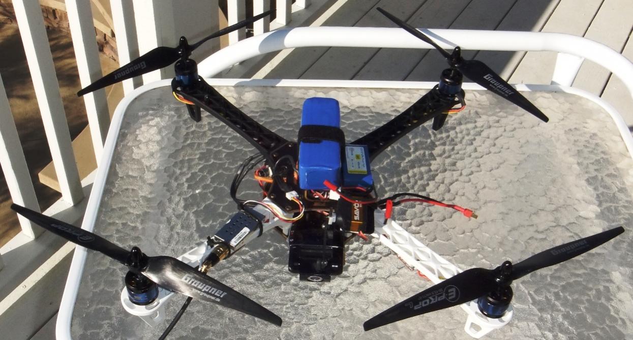

To paraphrase a popular saying, "What a difference a prop makes!" I was having gain adjustment issues, with the 11x5 Graupners, which I knew would be way too much prop for this little guy, especially on 4s, so I was about to switch to the stock 10x5s when I remembered something. Before, when I used to fly an FY-90Q-equipped Gaui/VC450 quad, primarily as an FPV platform, I remembered that the GWS 9x5x3 3-bladed props were a ton smoother, and had pretty much zero vibrations, compared to the same 10x5 props that comes with the F450 and XA Hexa kits, but they need to be balanced well, which is a pain. I took the four props off the VC-450, checked the balance (one was slightly off...) and then put them on the F450. I was absolutely stunned by the difference. They are so much quieter than the Graupners, or the 10x5s. I just uploaded the video out of the Bloggie, and it is absolutely vibration/jello-free. :) First video I've done in a very long time that I can really say that about. It truly was quite a pleasant surprise. :02.47-tranquillity:
This also made a huge difference in getting the gains dialed in. I still had to play with it, and there was a fair amount of wind, but I ended up maxing out the knob, which was at about 200%. That gave the best results, but there was still a bit of descent wobble. I'm going to up the center point to about 150-180, from 100%, so I can have a bit more room, but I'm guessing I will need to get the basic pitch and roll gains up to about 220-230. I left the yaw fixed at 180 and the vertical fixed at 150. Not sure why I picked these numbers, but changing these don't seem to do much, so I've got them fixed. I left the Attitude gains fixed at 75. This too seemed about right, but I might lower them a bit more, to get a bit smoother movements.
Flying without GPS, in the wind, was a bit interesting. :nevreness: Without wind, it flies exactly like the WK-M, so I forgot. :) Anyway, it was definitely drifting with the wind. Since this will primarily be an FPV platform, I can't see needing GPS, but even flying it from the ground, it is not so had, mainly because the altitude hold function is so amazingly rock-solid. It is pretty easy, and fun, to simply fly around, doing coordinated turns. :) Another thing that really helps with the orientation is the pink and yellow pool noodle "legs" that I added. I did this mainly to increase the ground clearance, so that I could have the pack underneath, but I had no trouble seeing the colors, even as high up as it was.
I'm going to do one more gain tweaking flight, and then I think I'll be ready for an FPV test. :)
