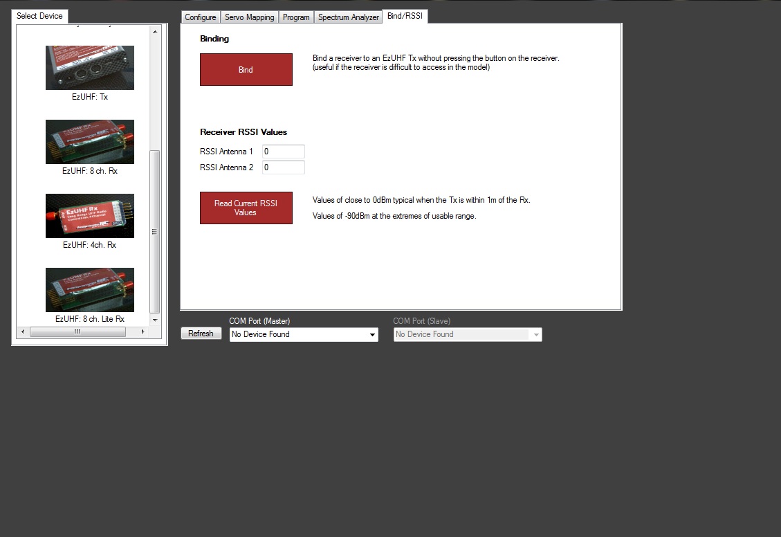

Thanks Chris! I have updated the firmware on the TX and the diversity 8ch RX to 1.44 already, I have the manual, and the installer but I didn't notice you could bind with the software so ill have to go back and try that :D.
In the Immersion tools, choose the 8CH transmitter and than go to the last tab.....:
Some time gone since I did it last time....but should also be described in the manual....
