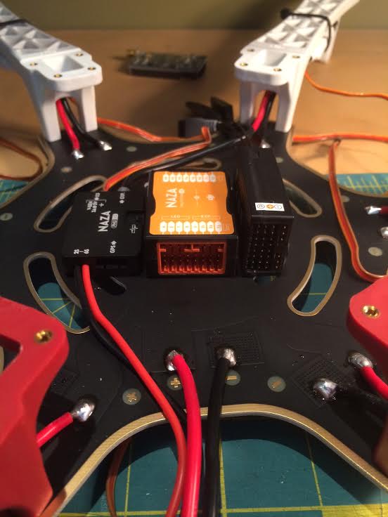

anything wrong with installing the receiver vertically?
Also, am I correct in thinking that any + - pads can take an accessory?
Meaning, can I solder positive and negative wires from any of the electronics to any of the + - pads that the ESC's are soldered to? Is it better to solder everything to the battery + - ?
does that receiver have satellites or just the wires sticking out the sides? if it's just the wires then you should try to locate it away from the center of the frame where the wires can be sure to keep a clear view back to your transmitter. On the side of an arm with one pointing out and the other pointing down. I think the frame plates are G10 which won't necessarily keep the signals from passing through (carbon fiber will) but it's not really good practice to bury the receiver wires/antennae in the middle there.
if you've got satellites then you're good there as the receiver is just processing what the satellites are bringing in and the satellites can be mounted out away from the frame with the wires running back to the receiver.

Bart, isn't that where my Naza has to go? did you by chance mean in the center, on the bottom of the top frame plate (so the PMU and the naza were vertically centered?)

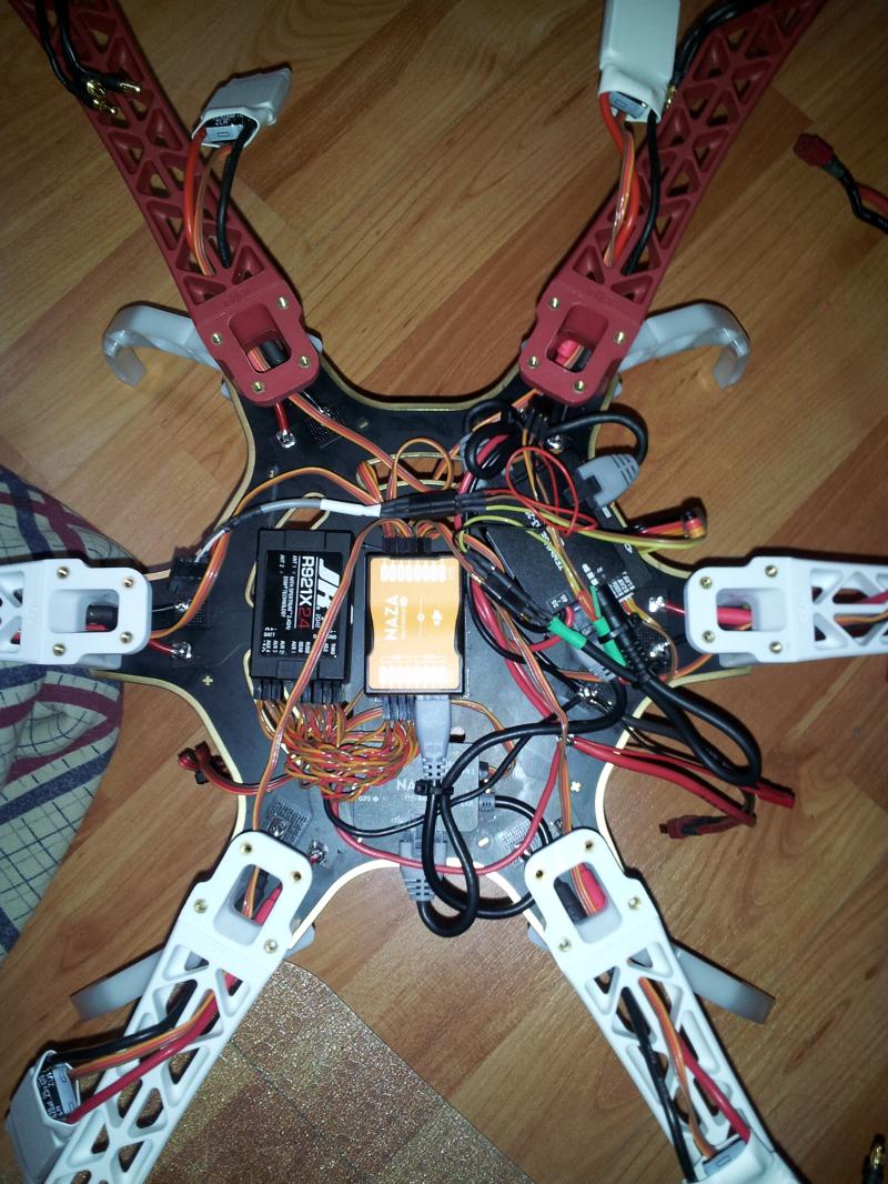

here's how mine looks
it's a bit of a mess with the flight cam and the connection to the zenmuse
what's not seen is the immersionrc 600mw transmitter that on the top plate with the gps

It's an XR8 which has two wires with plastic antennas molded to them. The plastic pieces are about 2" long.
The "NAZA" is the IMU I was referring to, so yes that's where the NAZA should go, in the center on the top of the bottom plate.
so if there aren't any satellites then the two wires are the antenna wires and the receiver should go somewhere where the wires are clear of the frameplates and not obscured by other components. the signals should go through stuff but i'm not one to test things like that. i think i put a receiver like that on the group build F450 by mounting it to the side of an arm with the antenna wires facing out and down.
