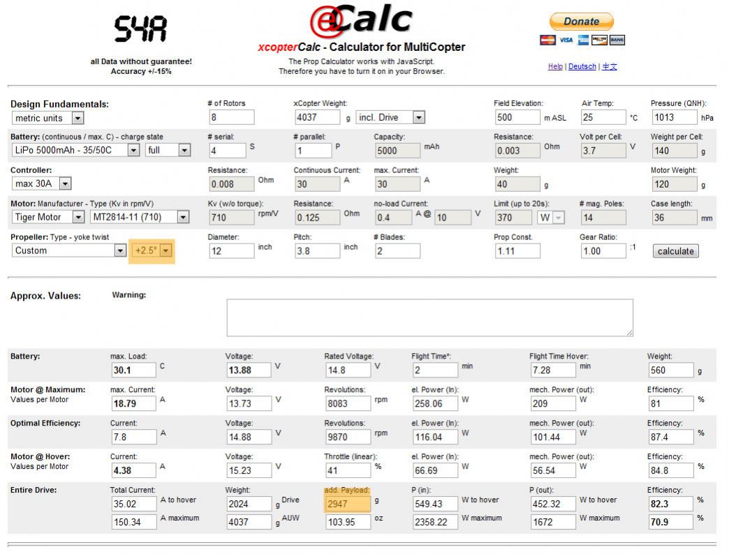

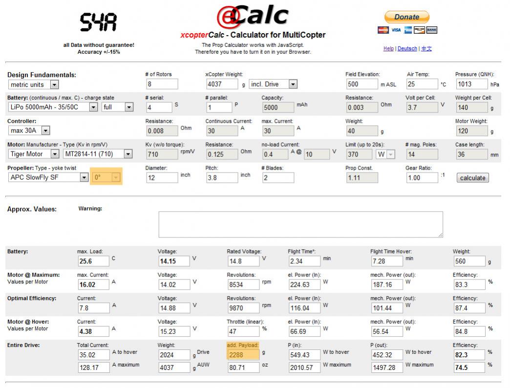

Hi,
I play with ecalc and try to figure out how much my MK can lift. I'm stuck with props-yoke twist. Try searching on web but nowhere strait answer. I upload 2 images with different props yoke tilts. I have motor angle adapter at: https://www.mikrocontroller.com/ind...id=564&zenid=2a0a11d953dd80e831e9470af8b0baf9 and it have a 3 degree tilt. Can I use it to calculate props yoke tilt in dropdown menu 2.5 (it is closest) or not?
Also can't figure out what is mean include Drive? Is this mean with or without motor, esc, battery, maybe?
Thanks.
View attachment 4245View attachment 4246

Yoke twist is only needed for props which have variable hub or choices (like folding props). Leave it at zero.
Angle plates will also reduce lift slightly, so the figures the calc give you will be high by a few percent.
"without Drive" is best used when you want to play "what-if?" games - assuming you know the weight of your frame, gimbal, camera, etc. then enter that and the system will add the weight of the batteries, motors and ESCs you choose.
The "add. Payload" fields show how much weight you could add to the craft, as configured, and still remain "flyable" (with throttle at 80%!). Effectively, therefore, it represents your "excess thrust available".
Vojec
Thanks to clear that out, because if you include/select wrong number in my case payload varies by almost kilogram.
