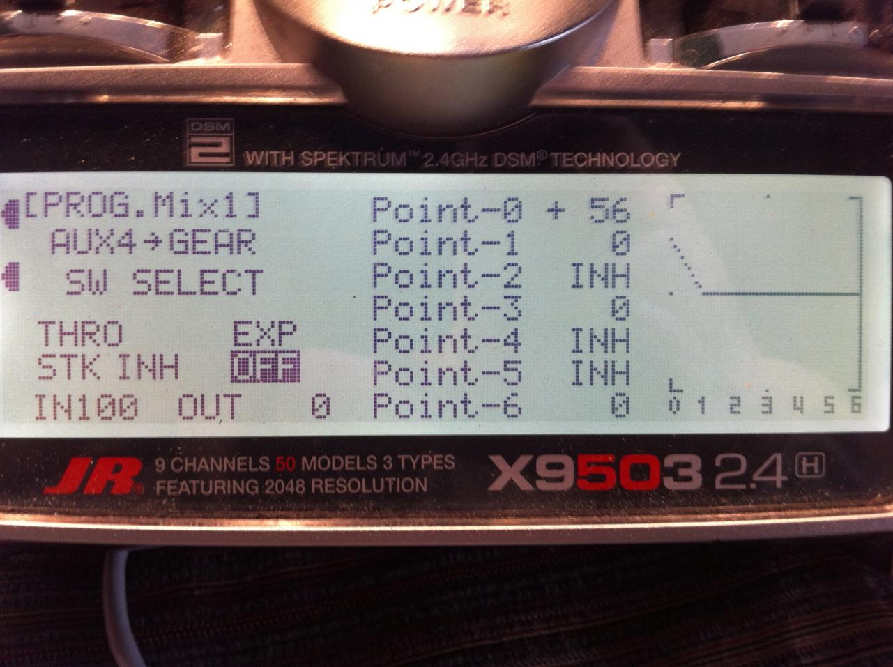

This is on a JR9503 but the screens and set up are similar.
My Gear channel is set to the Fmode three position switch. Hope this helps.
