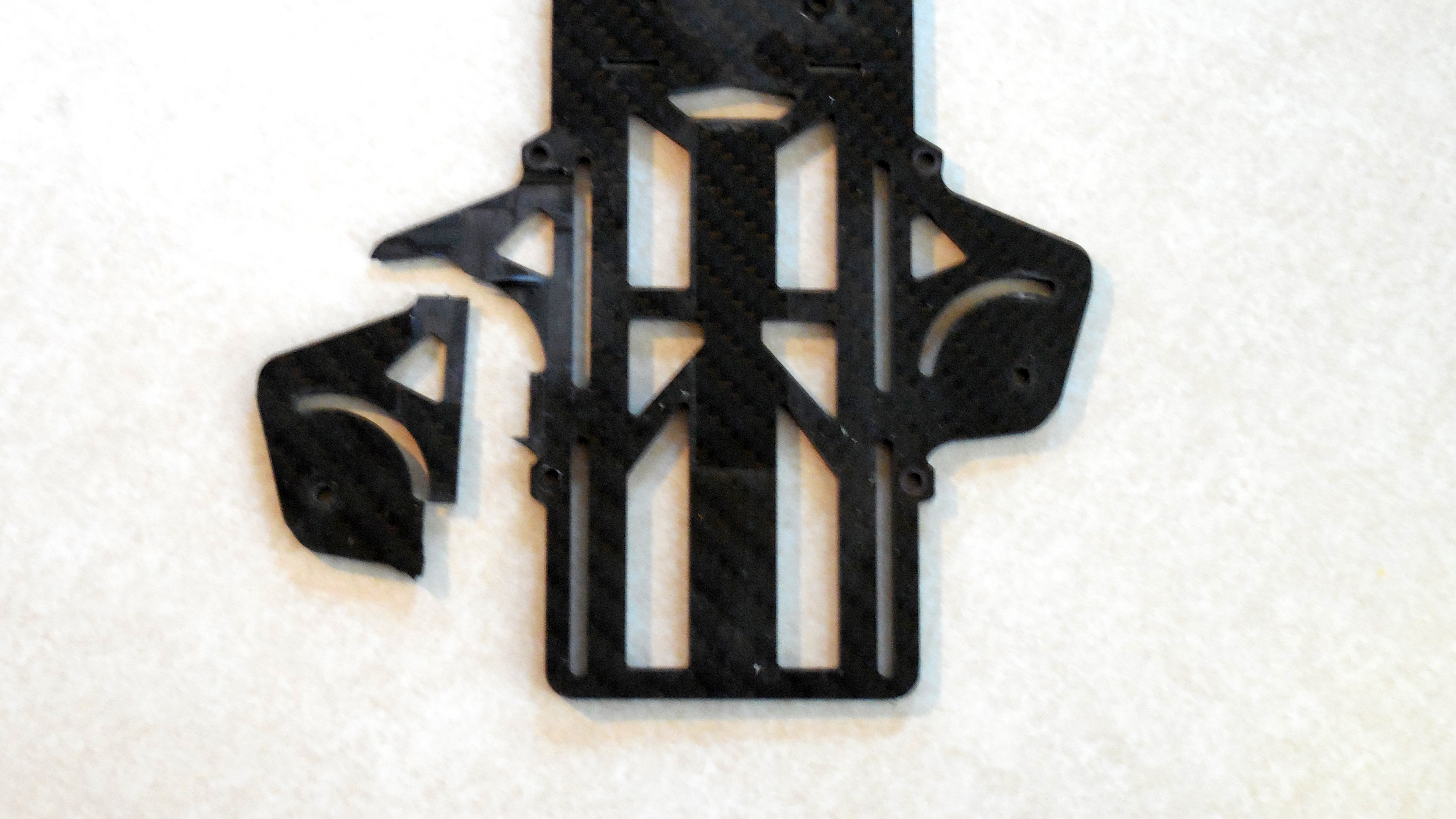

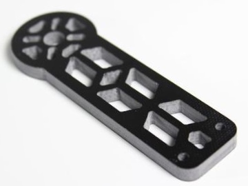

Kit manufactures need to be aware of costs vs. crash suitability. Making the arms of a multirotor indestructible, may put other parts at risk. On this point, I experienced a crash with my XHover 300 where it came straight down on the left rear arm breaking the middle body plate. The plate costs $70 to replace. I would have preferred to replace a broken arm at $10. I'd have to break seven arms to equal the middle plate!
If the arms are part of the plate make it thicker than the others. If the arms are bolted between two plates, break an arm, not two plates.
Of course, the smaller the a/c the less the mass, the less mass, the less the force in a crash - to the point that those tiny micros are almost unbreakable. Large hexs and octos seem to explode on the smallest of crashes. Been there too!
Manufacturers, test crash your products to the point of figuring out how to break the least expensive part.
Here's photos of the parts in question.
