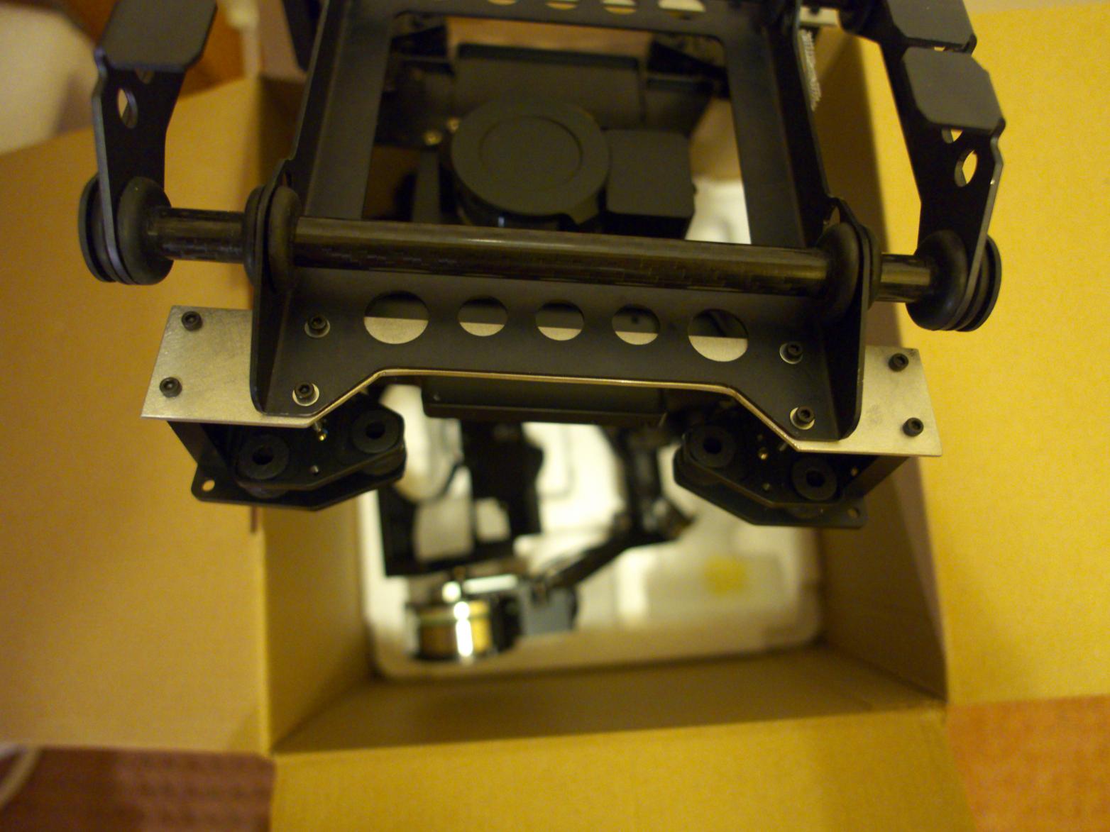

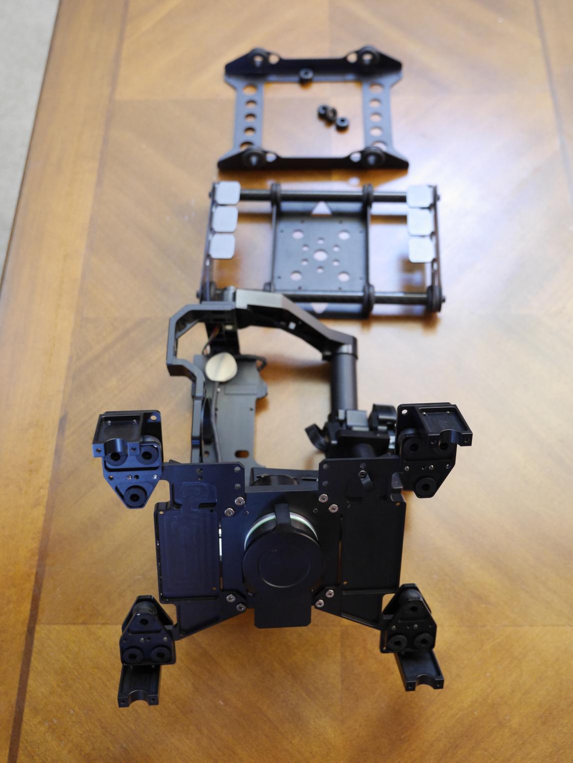

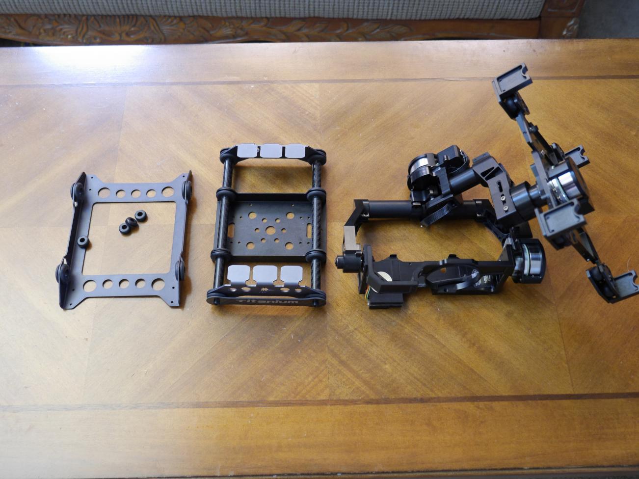

I bought a Zenmuse adapter plate to use with my new Zenmuse Z15 GH3 gimbal and for the life of me I cannot figure out how to mount the Zenmuse to the plate. I have looked online at the Droidworx site and there is not any instructions. It appears that it too small to attach properly and that there may be additional parts needed. Has anyone installed a Zenmuse on their SkyJib and would be able to share the install tips and/or photos of the install? Any guidance would be greatly appreciated.

Just had a quick look at the DJI web site and used their ZenMuse manuals for both the original GH2 and the new GH3 versions. The way they are hung to their support rails has changed .... DJI inconsistency again .. so the Droidworx plate you have will fit the old version but not the new.
I hope Droidworx have picked up on this already and have a solution in the works, soon I hope as I'm heading in the same direction as you.

Thanks for the info Andy, another $62.00 down the drain. I am hoping that the Droidworx staff monitors this forum, I would love to get this thing up in the air sometime soon.
cbpagent72

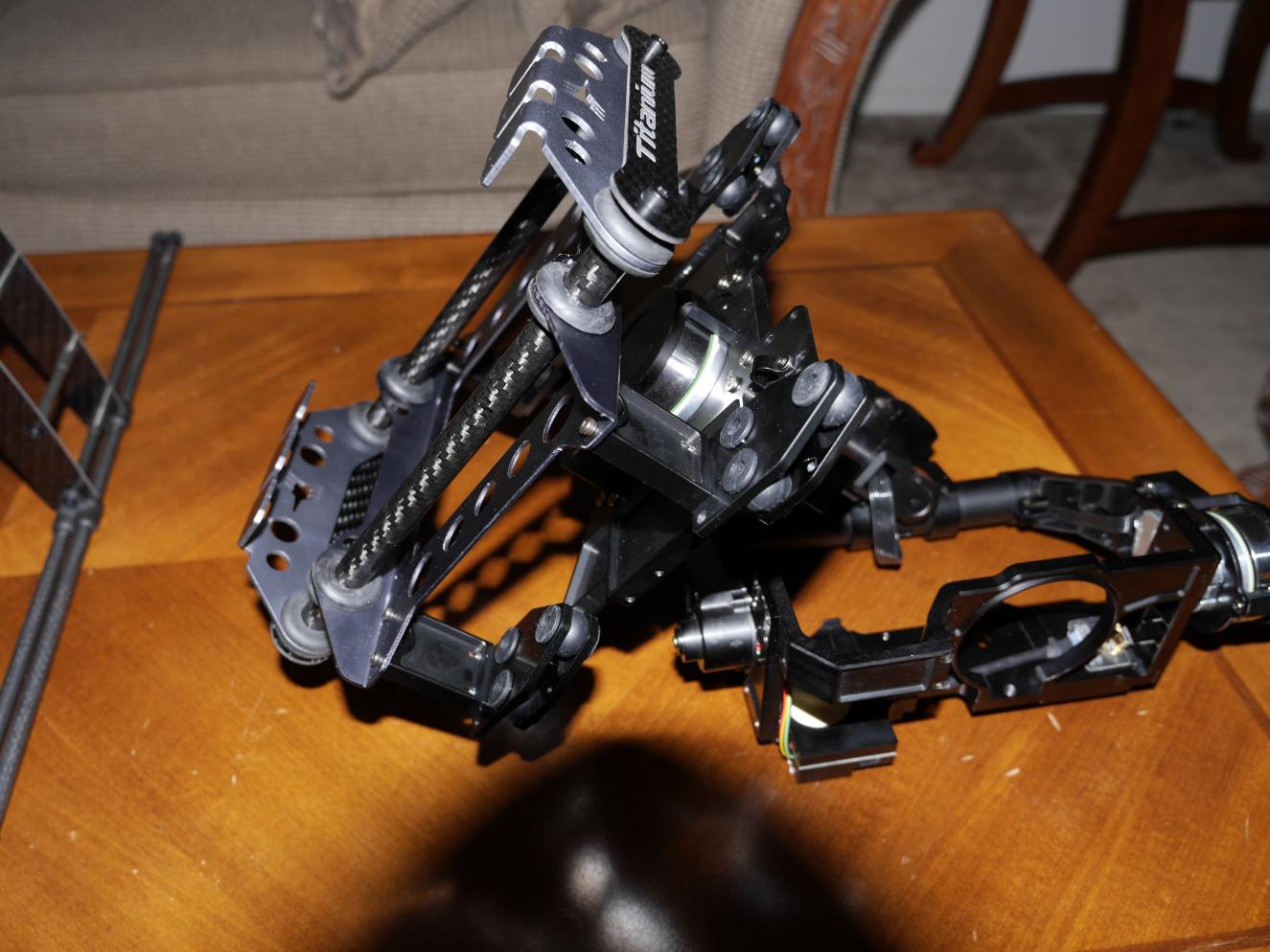

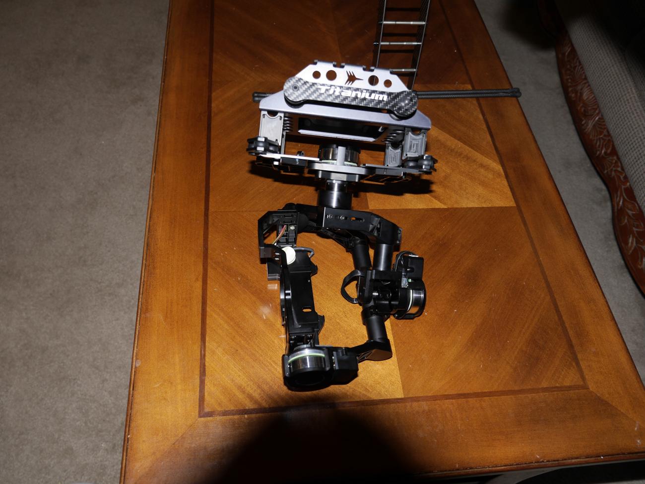

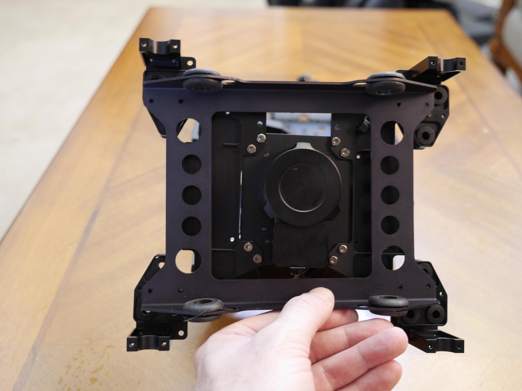

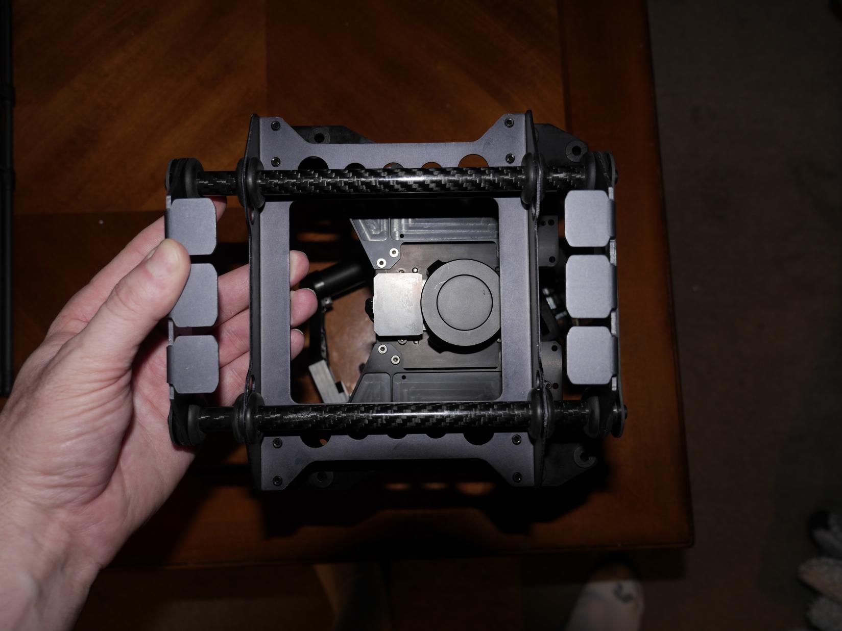

After messing around with the GH3 Zenmuse parts I think I have found a way to make the bracket fit. I will report back with photos if I am successful.

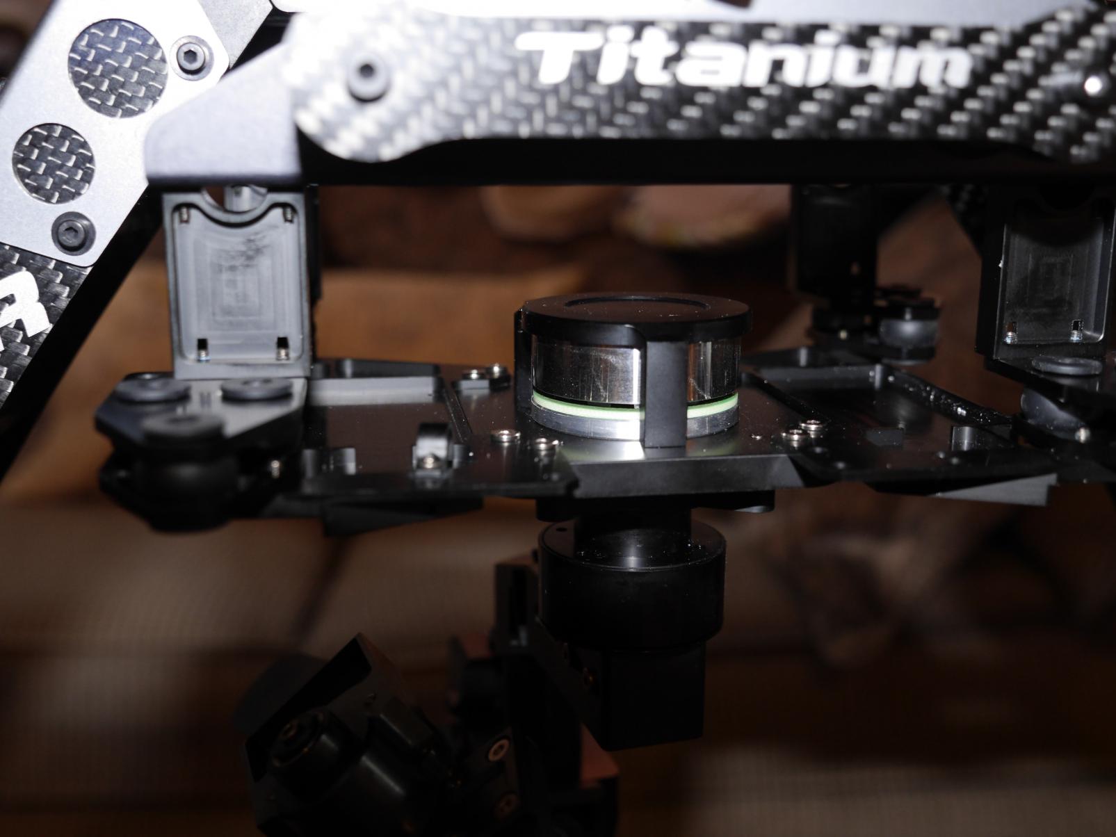

cbpagent72

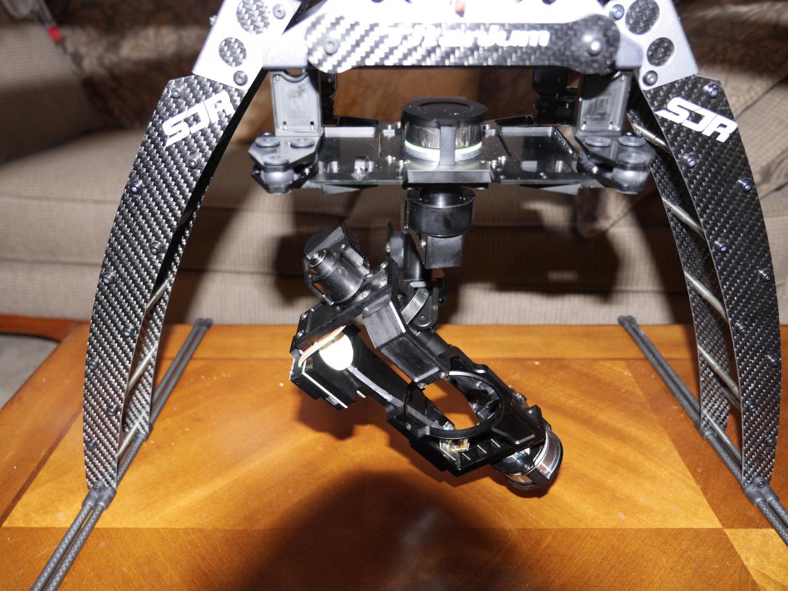

Well I managed to make the Zenmuse fit after some messing around with the orientation of the Zenmuse four brackets. It doesn't look like it is made to fit that way but it looks like it will work fine. The little Zenmuse controller won't fit inside the mount on top of the Zenmuse but I have a few other places that i can put it so no big deal.
Good to know you made it fit.
I'm sure you already know but make sure you don't power that up without the camera and lens on it.
