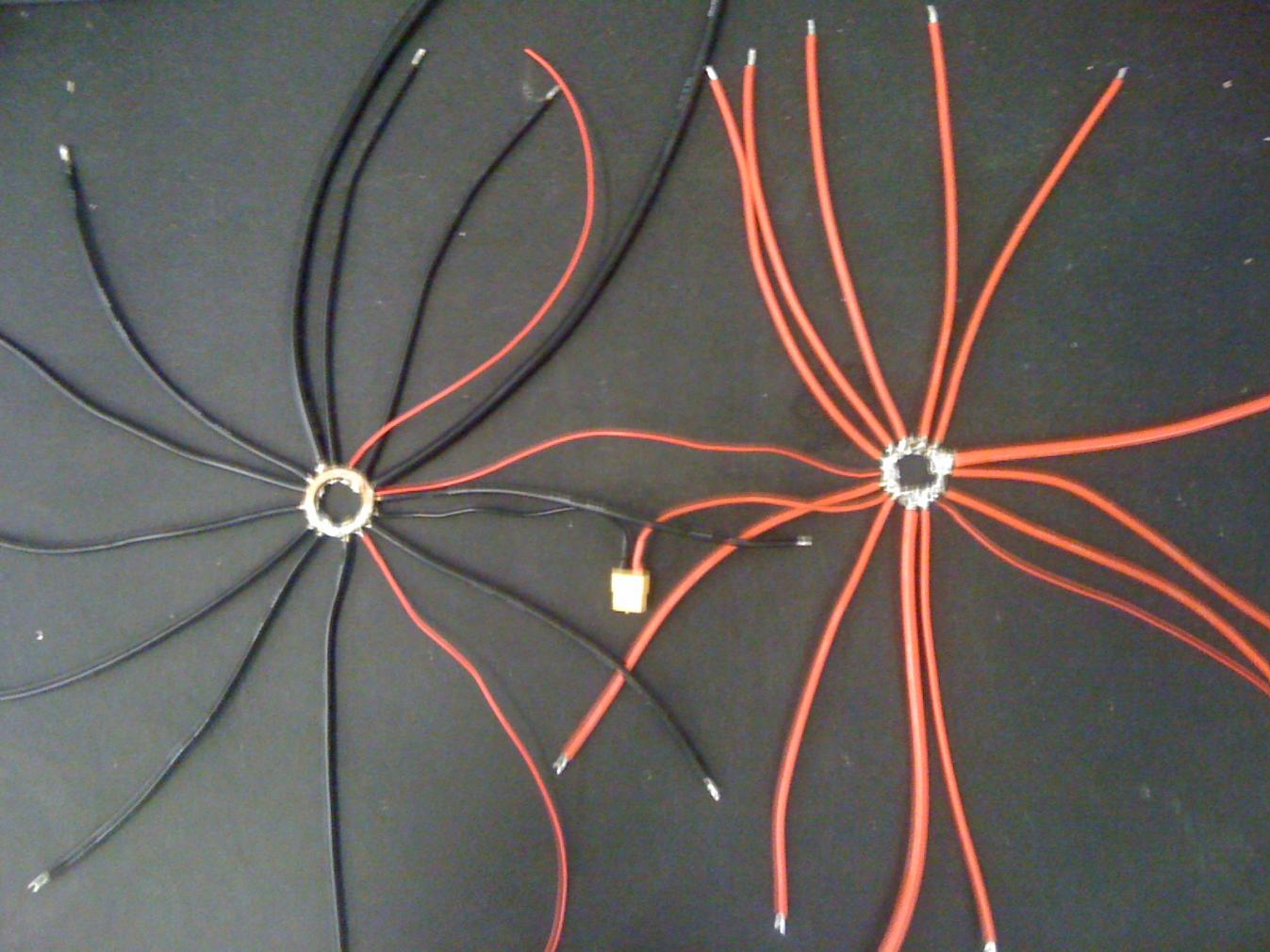

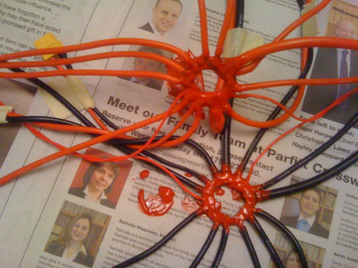

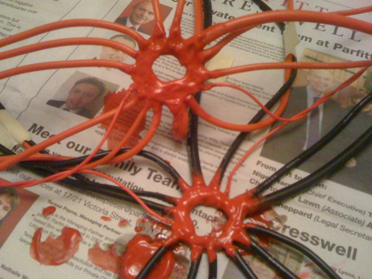

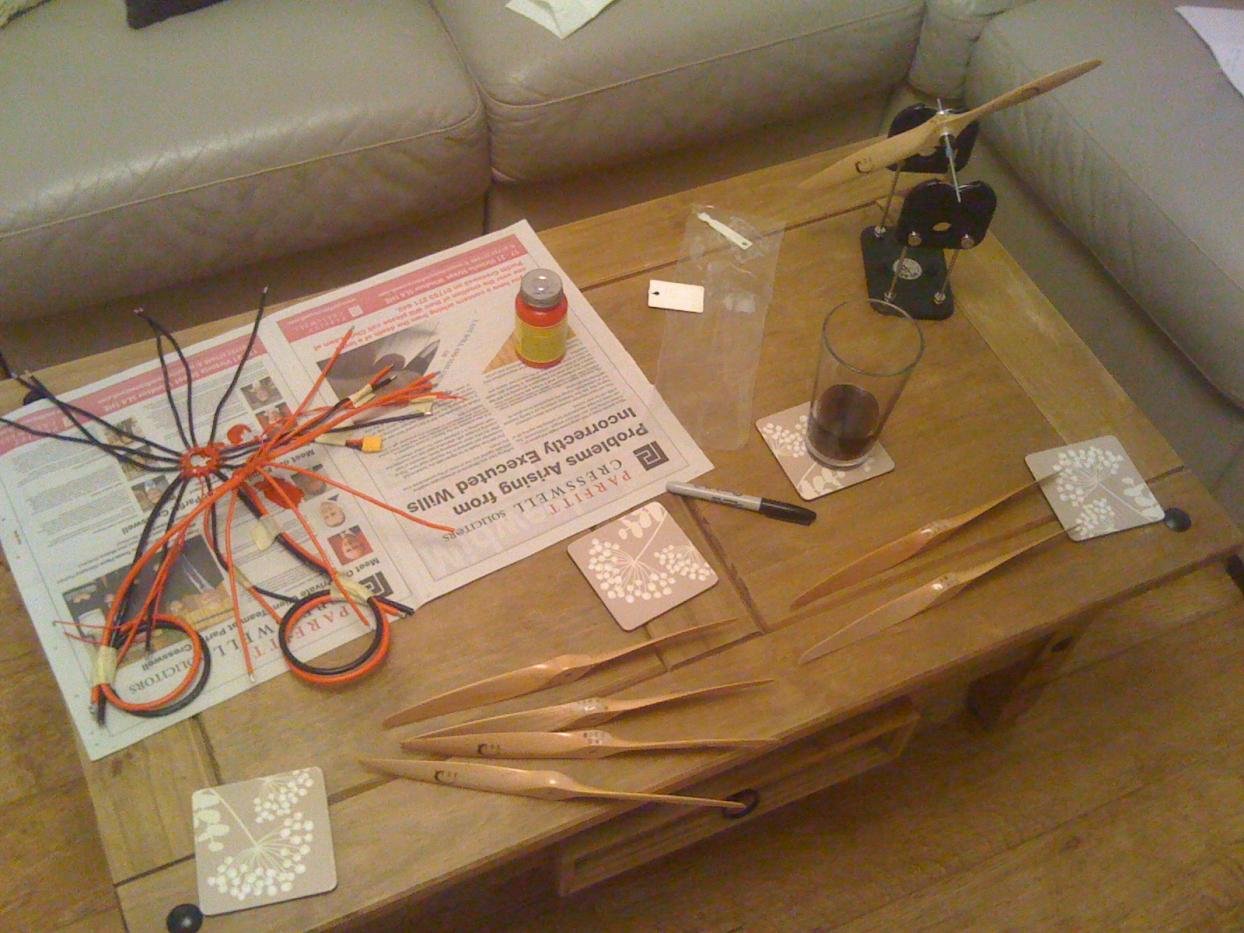

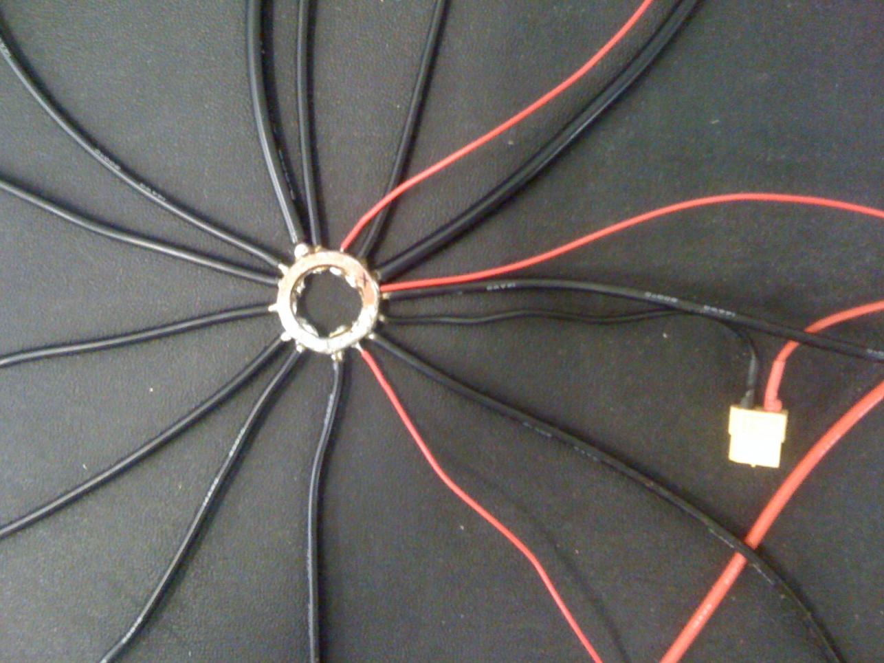

I have built a spider configuration for my power distribution. Got the idea from this forum : ) Its made up of two copper washers for the bus bar's and I soldered all of the legs to the washer. There is a + and a - one. There are 15 legs on each washer. 8 for the motors, 1 for the PMU, 2 for my LED's, 2 for the two batteries and two spare for expansion(UBEC's). I covered both with liquid tape and placed a plastic plate between both then another layer of liquid tape to hold them together.

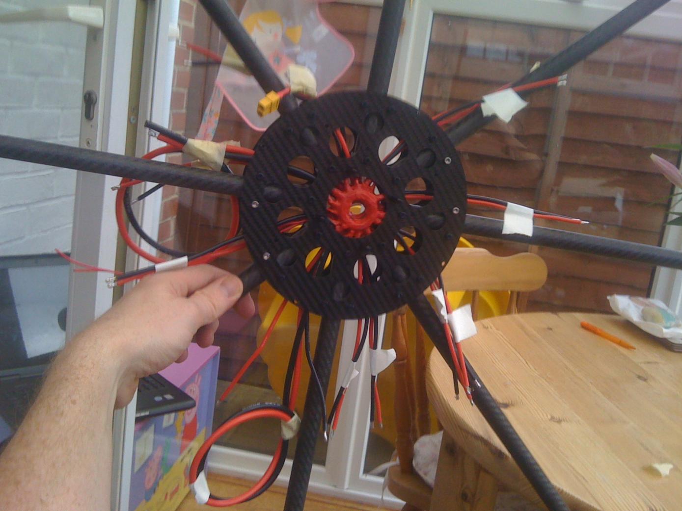

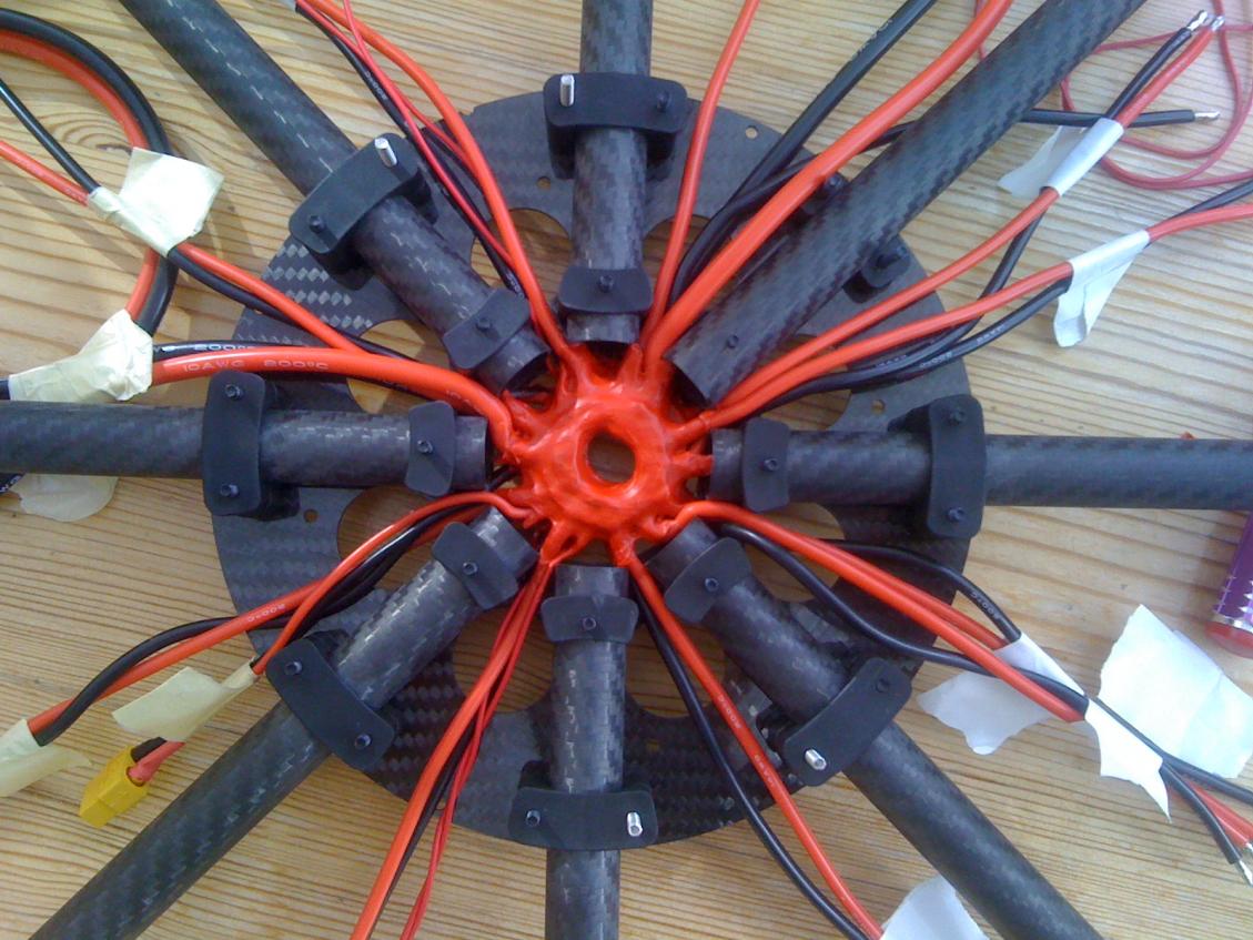

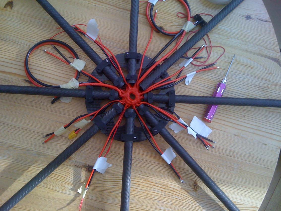

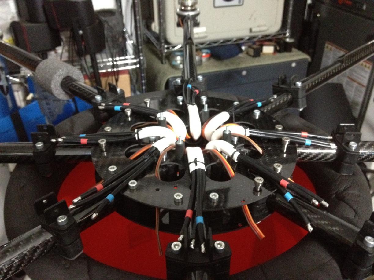

I first put the power distribution circuit on the Droidworx top plate but had an idea to put it inside. (Between the top and bottom plate) It was a bit of a squeeze but just managed it. Looks nice and neat.
Thats how far I have got so far. I think I will mount the ESC's on the below the lower plate.
I still have to sort out the WKM and my TX.
Attached are a couple of photos. Sorry for the poor quality, they were taken with my old iphone 3G. Photos say a thousand words, better than my description! : )
