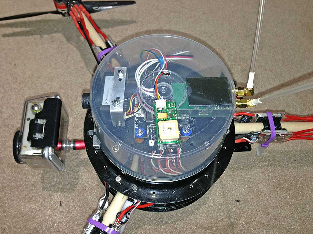

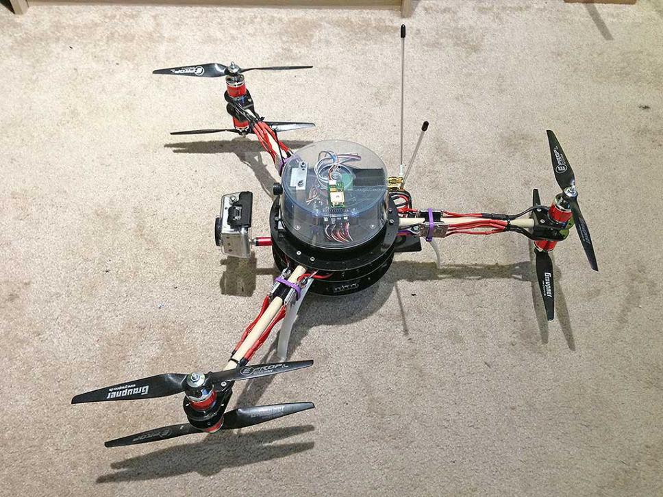

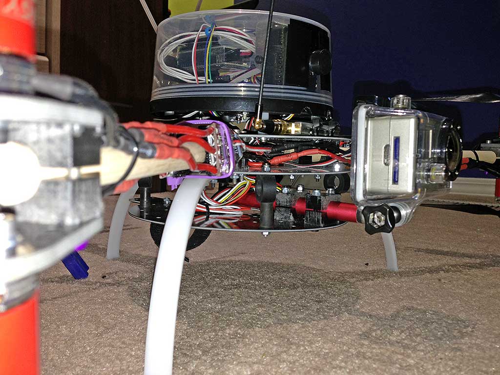

Here are some photos of my Rusty's Frame Y6 setup. It's based on the Rev8 version of his plates. Round wood booms, Frankenquad rib-bones landing gear, love those things.
View attachment 8528View attachment 8529View attachment 8530

The Y6 weighs in AUW at 1934g with a 3000mah 3s battery.
