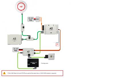

Thank you for the info.. if will try connecting it to Can 1. note the images from the DJI manual one says Can1 the other Can2 this is confusing. I have the H2-3D

The PMU and the Data Link/Ground Station go to Can2.
The IMU, GPS, iOSD MK II and the GCU for the H3-2D connect to Can1.
You should not need the Can Hub.
