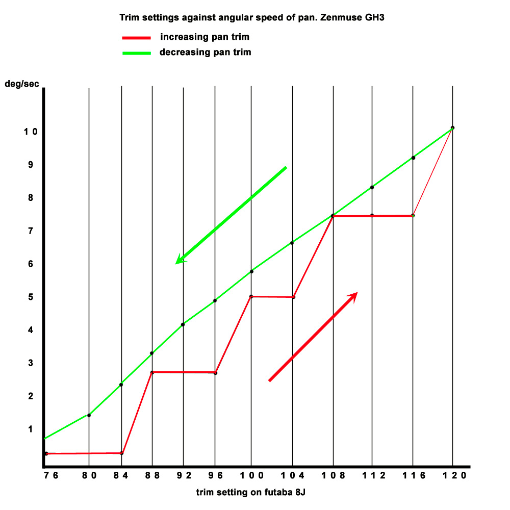

Here is the graph I sent to DJI yesterday. It clearly shows the stepwise progression in angular pan speed as you increase input and the smooth ramped change when you decrease input.View attachment 16315

i got an aswer from dji regarding the gh3 z15 jerky movement issue and its looking good i hope ...
they know about the problmthey say and wil tryto fix it and implement n next firmware

That's really good news, its a bug that has been bugging the hell out of me! Such a pity because bar that problem, the Z15 GH3 is rock solid (mine at least). Lets hope DJI try hard to fix this problem but to be honest...I'll believe it when I see it.

Funny thing is this bug is NOT in the 5D Zenmuse, it is really smooth with no stepping, it just has other problems that require fixing.
