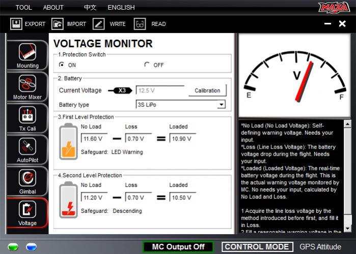

One more guess the lipo protection. What is it set to 4s or 3s ? and the values. Maybe its going to safeguard descending because its set to 4s and you are using 3s ?
fvg007
I have gain set from 100% - 250% using a VR switch but no luck...The video you see here is running around 120%.
I do notice at high setting ( over 200% ) I can see some oscillation of up and down - motors are rev up and down...
fvg007
This is my Lipo setting here:
Will try to turn it off and see it make any different...

1 flight: turn on lipo protection and camera gimbal on - System does not work. height cannot hold and motor will not stop in 3sec after startup
2 flight: turn off lipo protection and camera gimbal on - system does not work.
Both time I calibrate compass before flight.
3 flight: turn off both lipo protection and gimbal which was my last working setting...But still does not work!
I cannot get it back to esc turn off in 3sec after startup!
Any idea..? Now I am confused!
