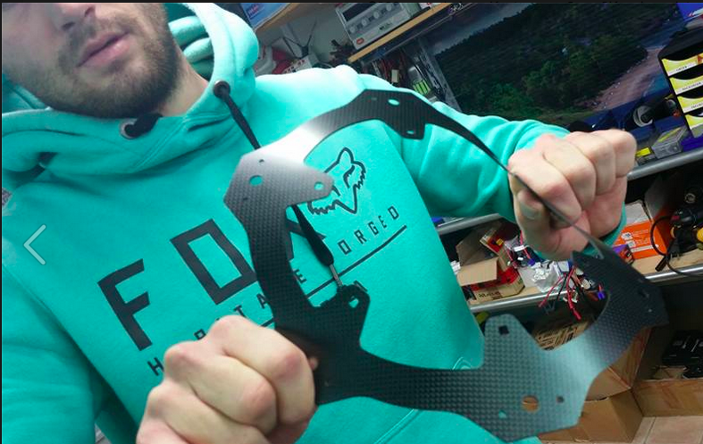

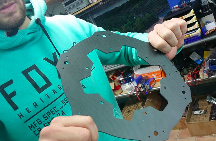

Amerly
kuau
Amerly,
I had seen this new top plate and will probably order it,
I am holding off just to make sure it's not my gimbal/camera combo
