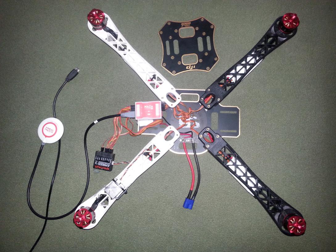

Hi guys and gals,
I'm new to this So bear with me... lol
Ok I just bought a F450 DJI and also the Naza M-lite GPS flight contol
I got it all put together and powered it up and bind my RX to the TX and everything went good (I think)
Now when I'm getting ready to connect to the computer but it wont connect to the PC like the PC is not reading it..
So when I plug the battery in the LED blinks green then red and stays red til I connect to the PC the LED turns light green..
but the PC not picking it up... am I missing something before I hook it up to the PC?
Any help or walk through would be a GREAT help, Thanks...

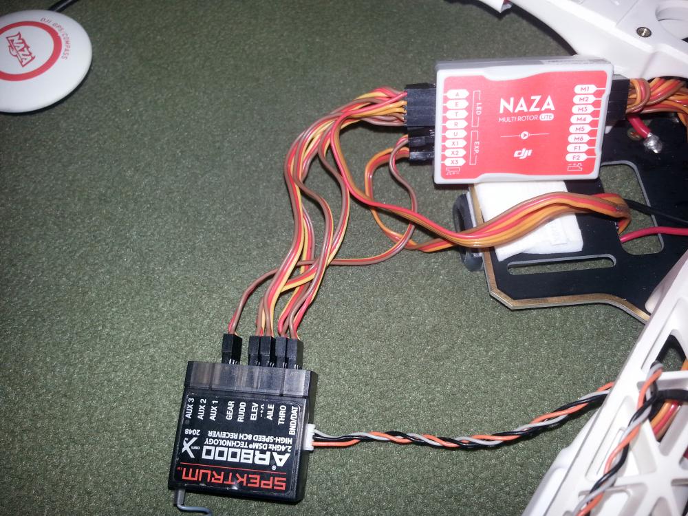

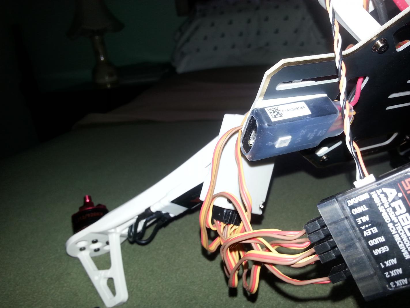

I have the driver set up on my computer but the dji not reading the PC i guess... This is what it's doing...
I turn on the TX ,
then I plug in the battery to the multi-rotor ,
the LED light starts flashing from (red, green, and yellow) in that order 3xs
then it flash 3 green and a pause and yellow blinks rapidly...
I read the manual and it's saying rapid yellow is TX signal but I bind the RX how can that be?
But I go on ahead and plug in the USB to it and the PC and the rapid yellow stops blinking and goes to a light green and nothing happen to it or the computer... like the computer didnt even pick it up on the USB port... I know the USB work on my computer as i use it for all my camera gears..

Can you go into device manager and see the DJI unit? If not then your drivers are not installed correctly.
bensid54
Check your throttle stick make sure it' all the way down. You may have to reverse the throttle setting if the blinking continues. Also when you plug everything in like you said wait at least a minute for the Naza to connect to your computer. Did you click on skip of the Naza assist before hooking everything up? I always get the Naza assist up on the screen before I do anything else.
Punisher
Ok I got it figured out... I guess the driver I had must have been old or something but I reinstalled the newer driver and everything works great... so I got it all set up and then took it out for the first flight and WOW.... runs smooth like a feather...
