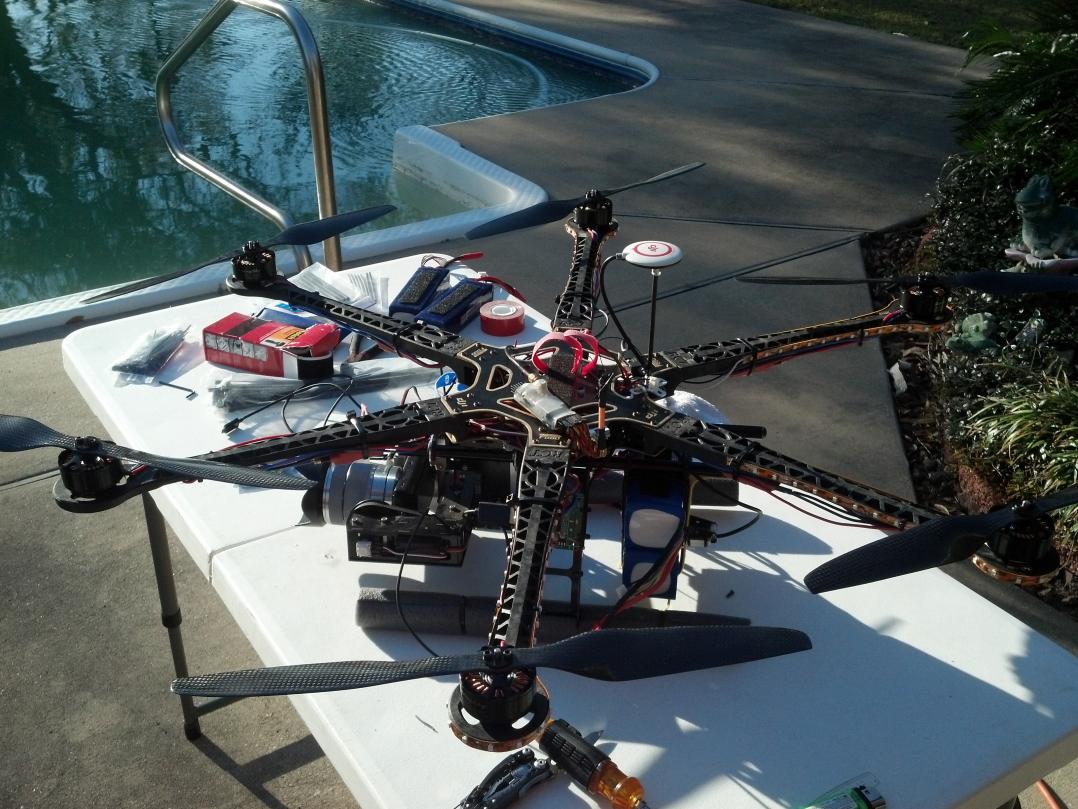

Very well done stuantonflyer. How far have you flown away from your ground station? I am waiting for the arrival of my F450 also. Once I perfect my programming and flying skills, I will try FPV. Have you tried goggles? may be an option to your less than perfect 7" tv. :livid:
btw: Love the custom "bic" legs. Very cool. Happy flying and thanks for sharing.

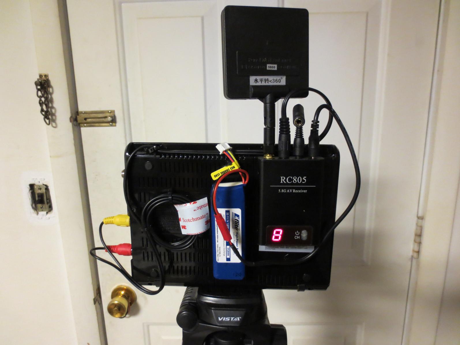

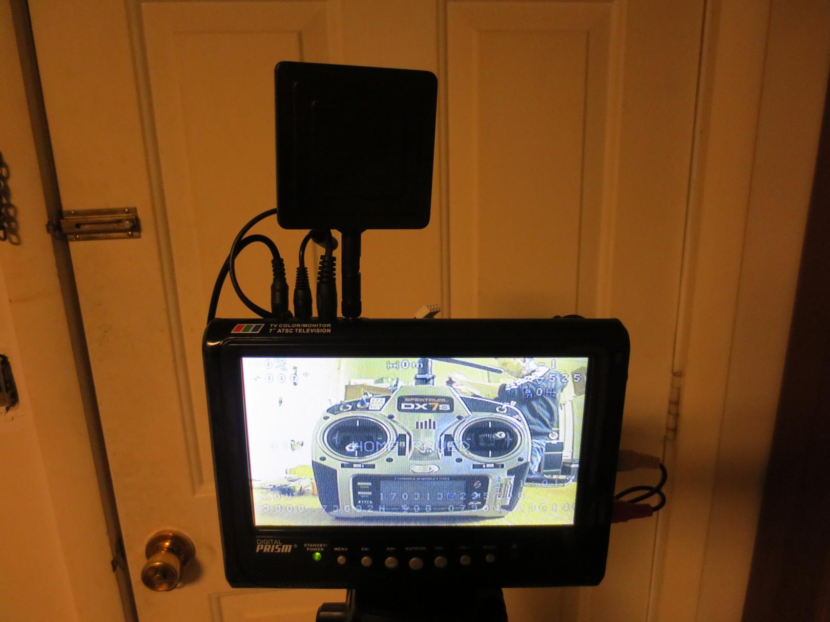

I just got the ground station and FVP setup together so I have only made a few test runs. I have been probably 500' out from it. I have a weird interferance that cuts in and out that I'm trying to fix. Not sure yet if it is just a weak transmitter or vibration or some such. No goggles yet but I plan on getting a set at some point (the TV was a cheap quick solution).
Thanks Cabojay,
I got the FPV off of ebay It's also cheap and easy way to start.
Link to video setup http://www.ebay.com/itm/5-8G-Video-...adio_Control_Control_Line&hash=item3cc9942d16
I'm still working the kinks out but, should you go this route I would recommend throwing away the cables that connect the video transmitter and the camera. Remove the plug on the camera and solder new wires directly to the board. I had both the cables they sent for camera connection break on me. I actually burned out the input voltage filter on 2 video transmitters (both fixed) due to shorted cables.

You'll get a lot better quality out of a gopro and a undermount gimble. My video quality is kinda poor and I have pretty bad vibration at the moment. The transmitter holds a good signal to 400 feet, gets kinda fuzzy to 1000 feet and starts going out after that. I went to 1100+ yesterday and took a dusk video of my town. For some reason it didn't record audio and I'm trying to figure out the best way to load the video here. This is the story of a build like this, as soon as you get one thing working you find 2 more that have issues.
My setup is perfect for what I want at the moment, just to see what the hell the Quad is doing when I can't see the quad. Definitely not going to video any weddings!
For the first few flights might be a decent idea to slap one of those pingpong balls on one side. Every time I crashed it was because I got disoriented and went full speed the wrong direction. I spent many days in a field just going strait out and strait back to get a feel for it. Nearly destroyed the whole thing the second trip. I came down the field at myself at full speed, went right over my head. I had a pretty good wind blowing in my face so the quad was screaming down the field. I turned around to see where the quad was headed and hit the wrong direction on my radio. I was trying to go forward to slow down but I went back to full reverse heading the quad at top speed strait towards an apartment building. In my panic I managed to hit the throttle wide open and and hit the correct direction. The quad started slowing and climbing and passed right through a 10' gap between the 2 apartment buildings climbed over the roof and returned towards the field As soon as it was over the field I dropped the throttle and managed a picture perfect landing some how. I packed up and headed off in search of a new pair of pants and a six pack.
Good thing you have extra arms I think I have replaced 5-6 now.

ignore the voltage warning, I can't seem to keep the gains in my OSD set properly. It keeps changing back to the default I guess, 7.5=12.6 V. Also the directional arrow only seems to work if I'm moving, it just points everywhere when I hover.
stauntonflyer
Psychopath Labratories
Update, I haven't had the video cut out so bad since then. I think the combination of being 1000 up and 1000 out and directly behind my neighbors house really made things fuzzy!
