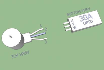

just would like confirmation for dji motor and OPTO esc connection for clockwise and counter-clockwise. Have been searching for this but didnt find any good info on this motor esc connection
had made 1 graphical image showing the motor and the OPTO esc as below.
let say would like to have a clockwise direction what is the connection base on below images:
http://i1193.photobucket.com/albums/aa354/quad500x/djimotorescconnection.png - click here for much bigger image
from motor connection 1 will be to U / V / W - of OPTO ESC
from motor connection 2 will be to U / V / W - of OPTO ESC
from motor connection 3 will be to U / V / W - of OPTO ESC
let say would like to have a Counter -Clockwise direction what is the connection base on below images:
Any guidances and tips would be much appreciate !
Thank you
regards,
- Tops -
mailman35
it doesnt mater at all how they are hooked up, if its not spinning the right way you just swap any 2 wires and it will spin the right way.
there is a reason nothing is labeled it doesnt matter :p
toptweaks
Hi mailman35,
ok ... U make a good point there ... hurm will do as what being suggested building my first F550 hexa and all is wired only on the motor esc connection :p
thank you !
