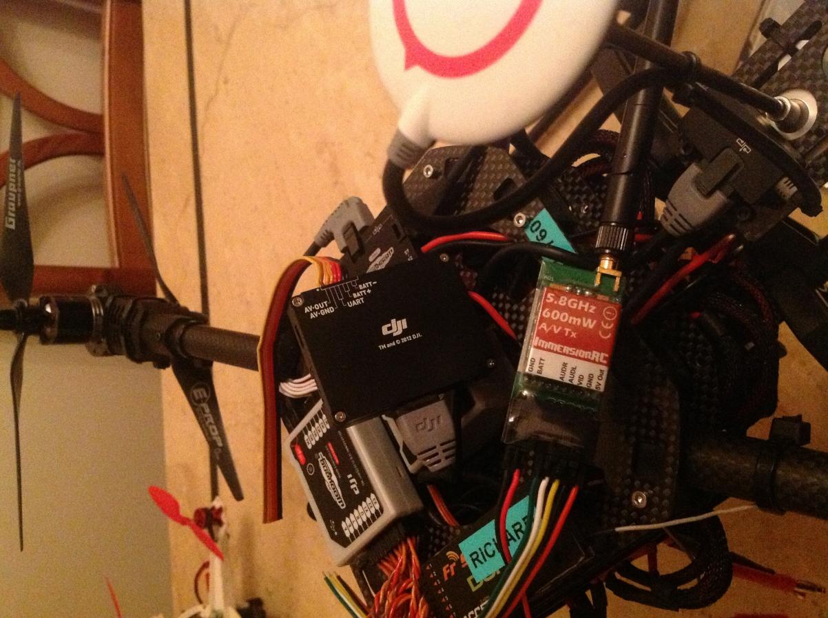

I have a DJI iOSD (sadly its a Mk1, ordered just before the Mk2 came out) and an Immersion RC 5.8ghz audio/video transmitter (600mw).
I want to transmit using the Immersion TX but can't work out the wiring. I don't want to 'smoke' either, by using the incorrect polarity.
I plan to use a gopro but could do with help as seen in the photo. I find the DJI iOSD instructions poor and wonder if anyone can supply photos of their setup.
Is it compatible?
I have an Immersion TX on my 550 which works fine with Naza etc attached. The WKM on my 650 v8, doesn't seem so easy....

In the DJI iOSD manual on page 6 you got a nice wiring diagram. Look at the box: "OTHER WIRELESS VIDEO TRANSMITTER"
DJI side Immersion side
AV-Out (yellow) ---> Vid (yellow)
Av-GND (brown) ---> GND (black)
UART (2x orange) ---> not used, this is "channel selct", and this function is done via extra cable to transmitter
BATT+ (2x red) ---> 1x can be used to power the Immersion - BATT (this is the double Molex plug on the left side) - check Immersion manual for requiered Voltage
BATT- (2x black) ---> 1x can be used to power the Immersion - GND (this is the double Molex plug on the left side)
GND and 5V Out can be used to power your camera
PS: Apparently it will be possible to update the MK1 via firmware to Mk2
Chris

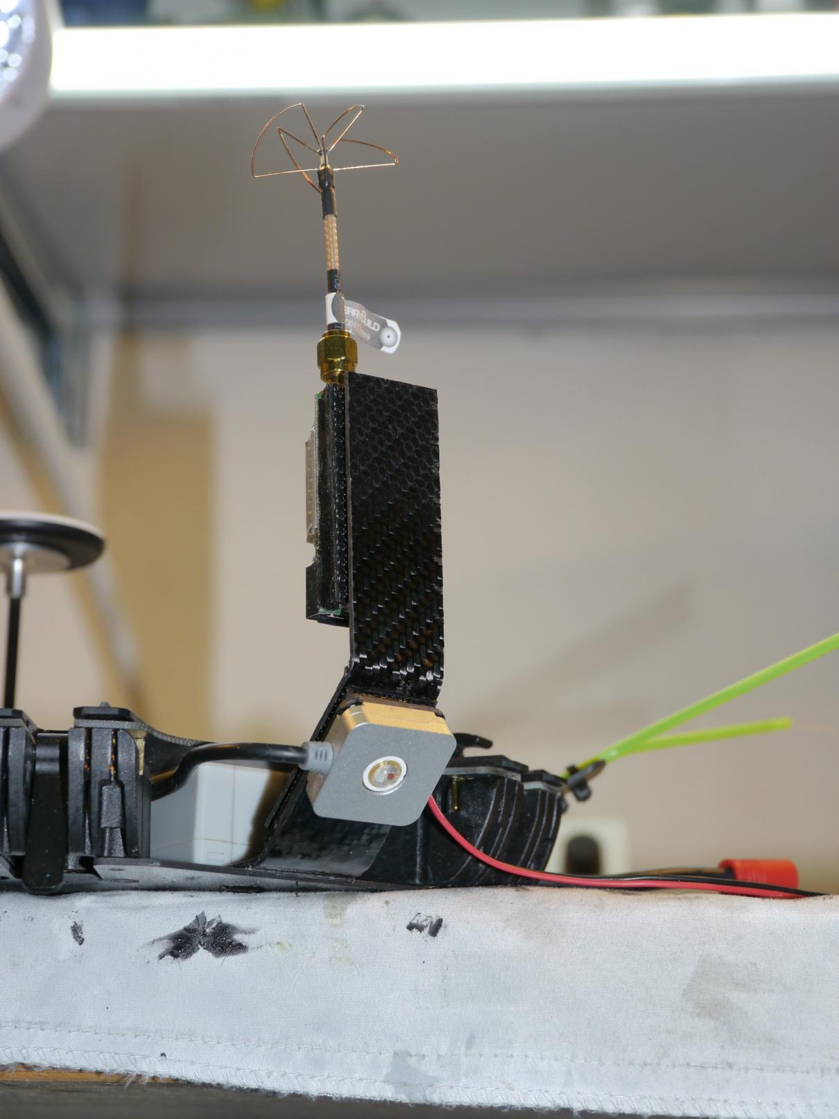

I have used this set up before. I just sold a F450 with the iOSD mini on it and the 600mw 5.8gHz Immersion. The power was taken right off the motor lead and I am running 4S lipos.
