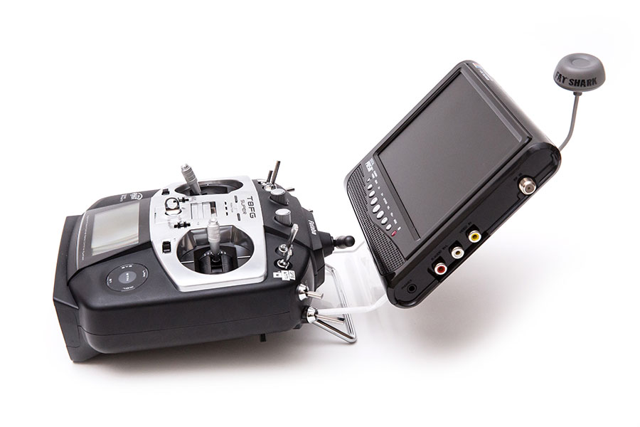

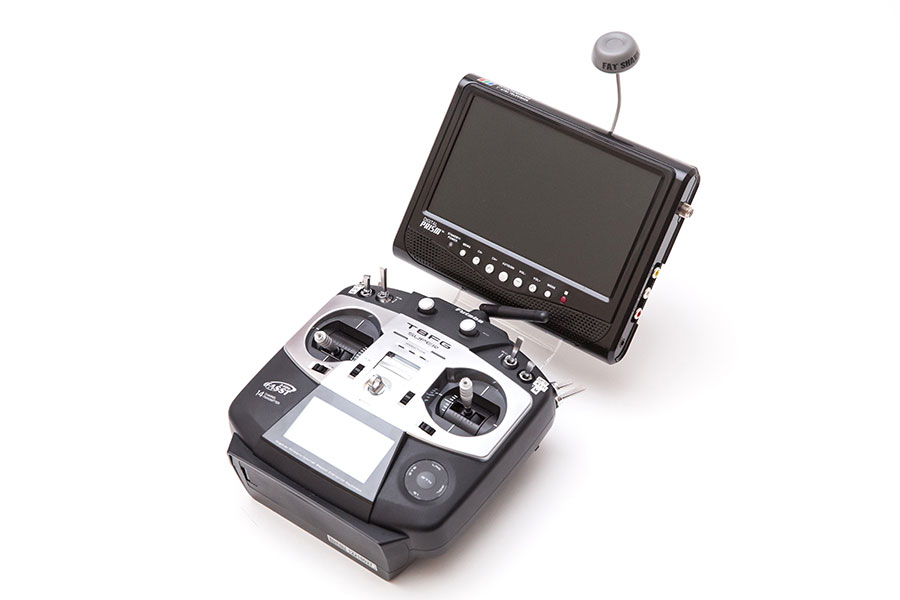

On a separate note, I went to your website and looked at you HeliCam page, what are you using to mount your monitor to your tx? Is you vrx velcroed to the back?

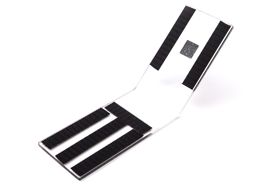

In my photo you asked about I used a length of plexiglass. I had a local shop cut and bend it for me. I then added Velcro to it. The screen is Velcroed to the mount and the receiver is Velcroed to the back.
Two problems with this setup. One is it is too heavy to hold for a long time with the weight of the display my wrists get tired and it is harder to to have fine control of the sticks. The second problem is that the monitor blocked the signal getting out of the transmitter. I had my quad go into failsafe and return home. It was only about 500 meters away at the time. I am now working with these parts. This secraft system is working better with some modifications. Still making adjustments. At least the monitor is up higher and no longer blocking the transmitter. The weight of it is on a strap that goes up to my shoulders. This allows my to have a light touch on the controls.
