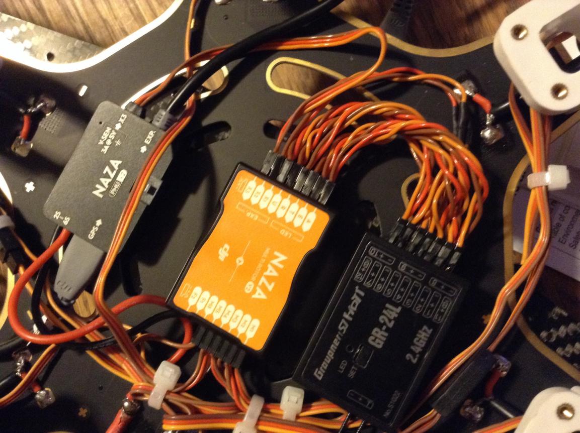

So I am diving further into multirotors and got the F550 with the Naza mv2. The build went smooth and now I'm stuck. I am having problems getting my graupner mx-20 transmitter with gr-24l receiver to talk with the naza. I have the naza setup but keep getting an error saying I need to calibrate the tx. I don't know why cause this is out if the box and with updated firm ware. I don't know if I should set it up as an airplane or helicopter for the model and other settings. I am having difficulty finding information regarding the TX and RX being used with the naza.
Does anyone out there have a graupner that they have setup with the naza to help me find my issue?

You have the Rx set up as Traditional. When it asks you to calibrate the Tx it is referring to doing so in Assistant not in the Tx. DJI recommends that you use ACRO.

Thanks for the reply Tahoe Ed. What I can't do at all is calibrate the tx in the Naza as my tx/rx won't talk to the Naza as it's setup.
From what I understand I have the receiver set up as ppm and did so following another thread hoping that would solve my issue but still nothing. Can you explain how I have mine setup as traditional and what ACRO is that dji recommends to use?
I also don't know if I should set the model up as a helicopter or airplane on the transmitter. Again I'm learning and appreciate the help
Tahoe Ed
I am not an expert at the Graupner Tx. I helped a user with his about a year ago. ACRO is airplane mode. I would not do Heli. Make sure that your Rx is connected to the Naza correctly. Throttle to Throttle etc. I don't remember how Graupner maps its channels. You are going to have to dig into the manual for most of your answers.
