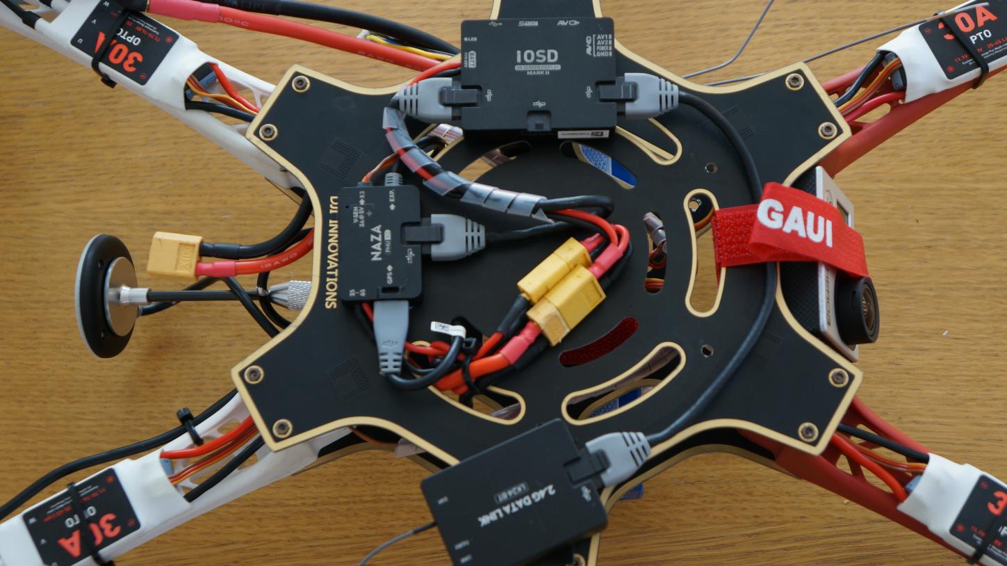

Here is a video of my F550 doing it's first "long" flight, about 1.6km.

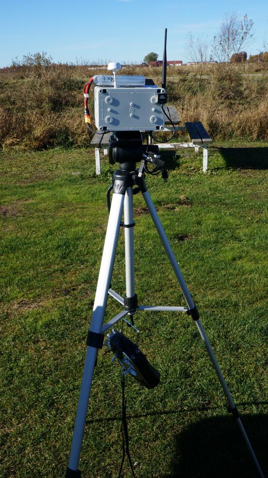

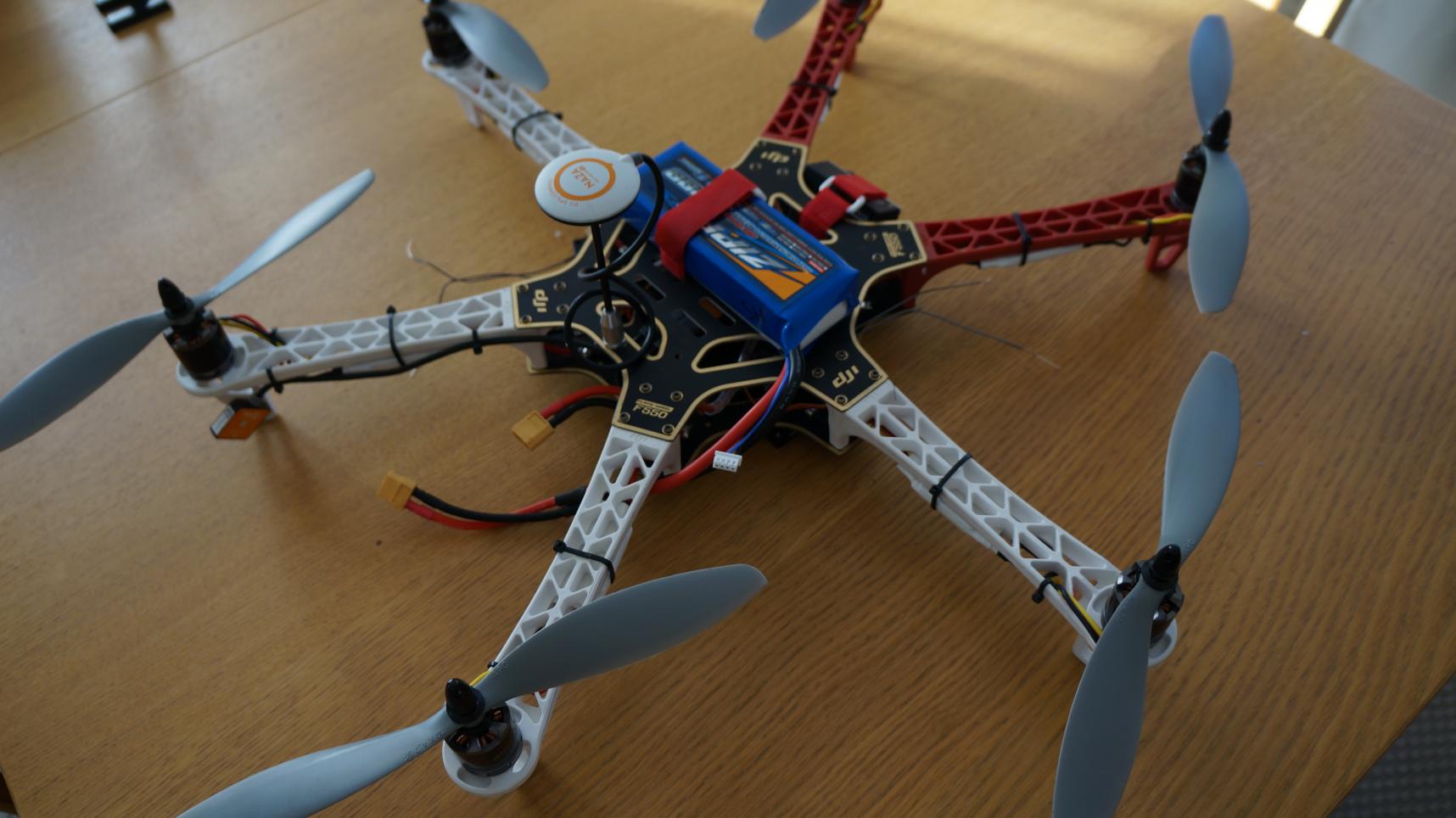

And some pictures of my Ground Station and how i fit everything on my F550.

Thanks for the info, will look forward to trying mine when it eventually arrives have built a 550 with Naza V2 specifically for this had some issues with stability using 1038 props on a bare bone quad but now have put 8" props on and flies a treat.

I use DJI's Bluetooth Ground Station with iPad. That's connected to my Naza v2. The whole mission is uploaded to flight controller, and if i loose connection it continue to run mission. I can take control with my regular TX to control it. I also have a video link so i see what happens.

Very cool and nice setup. I look forward to doing my first FPV soon with the 550. Can I ask about your GPS and how you attach it to the 550? What kind of stick is it that holds it in place? What stops the GPS from rotating around off centre? I have mine held in place so it can't pop off but the stick isn't glued so I can take it off for transporting. But it means I have to wedge the wires under a battery and keep it tight. It's a bit Heath Robinson but would be more accurate if it was firmly in place.
