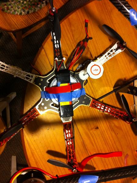

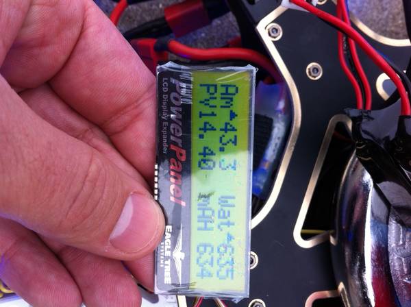

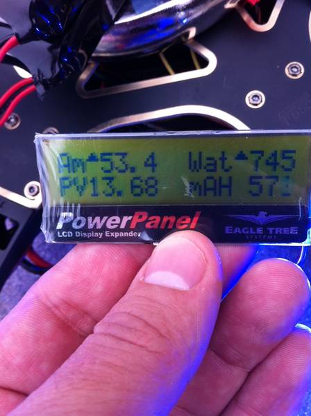

Per request of a customer and for the coming F550 GoPro and Nex5 mounts that GaryG and I will be carrying I went out and logged some numbers with 2.5lb weight and 4s 5000mah. I'm thinking 9-10mins no problem and the mount will be lighter. (GarryG will chime in on that, my mount arrives this weekend).
First pic is with 8" props and Max amp draw
Second pic is 10" props and Max amp draw.'
Third pic is 10" props and Hover amp draw.
Fourth pic is test mule. Not pretty but....
