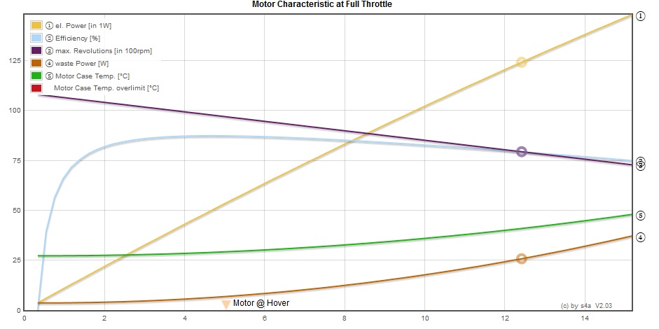

Kratos
It is very difficult (al least for me) to have big flight time and to stay in low budget... I think main problem all multirotors is flight time. Do you have minimum flight time?
davey_b
Nah, not really, 10 minutes or more would be nice but as long as it's more than 7 minutes or so of hovering and gently going about that'll be fine.
Kratos
The time it takes to haul the camera into position, take the shot, get back and land. Sometimes 30 seconds is enough.
It depends from person to person. For me 30 second is not enough. I need steady video clips 2-5 min.,so 20 min. in hover minimum but that cost. Anyway I dont want to replace batteries every minute plus I dont have money for multiple batteries :D At this moment I am thinking to invest my money in something else, but then I quit and that is not in my nature :D
