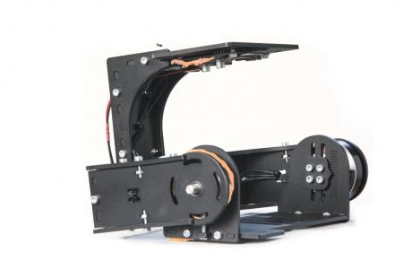

I use my F450 to fly a Canon S95....still a fairly lightweight camera, I switch between a S95 on Xaircraft 2x gimbal for stills and a Gopro on a Brushless gimbal. need to throw together another F450 from bits I have lying about to avoid the hassle of reconfiguring.

I have it connected to a VTx so frame shots with a 7" monitor mounted on my Tx. One down side here is that the USB is common to AV out and remote control so its one or the other unless you can wire up a fully populated canon style USB lead. I get round it by using a mechanical focus/shutter mech. prior to this I used the CHDK Intervalometer script.
