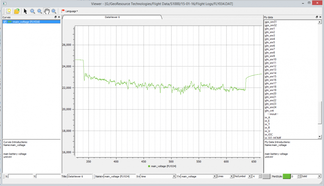

It works beautifully! Attached is the 'after' screen capture (before the data was all compressed into a single vertical line at zero seconds).
I can send the file if you want to PM me. It is too large for the forum and in .RAR format (unless there is another way).

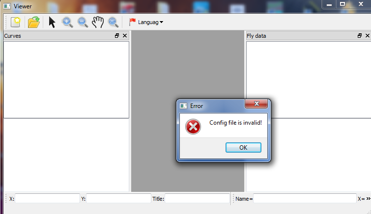

I have downloaded and unpacked the archive. Unfortunately, after downloading any DAT file error message "Config File is invalid".
Maybe there is another version of the viewer or the installation file?View attachment 23694
I believe that installation has worked for others (and worked for me). Are you pulling data from a A2?

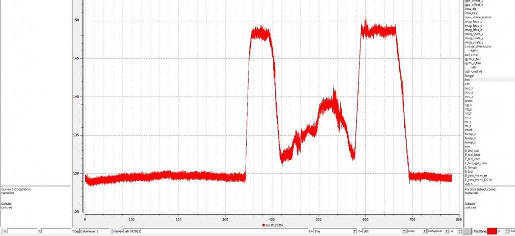

Here is a trace of altitude from your file FLY025.DAT so it seems to work well. So it would appear to be your installation of the Data Viewer that is having the problems. Do you have another machine to install it on to try it out? Do you have DJI iOSD Assistant already running on the machine? If not, I would install it from the DJI WEB site and then re-install Data Viewer.

painter12
Thank you very much!
I got! I copied your version of the viewer to the directory in which was set a standard viewer of DJI. After this, the viewer will operate normally. Maybe you know where I can see the full names of the parameters of the log file? I am very interested in the error flag "Attitudes status" what is shown as a "white flashes". What parameter can correspond to a "white flashes"?
