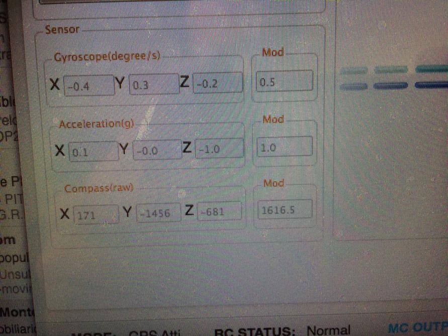

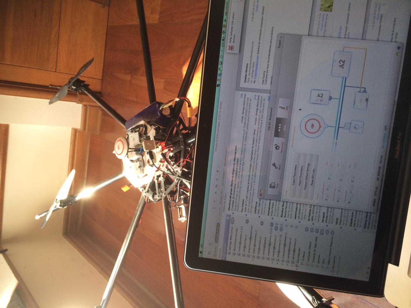

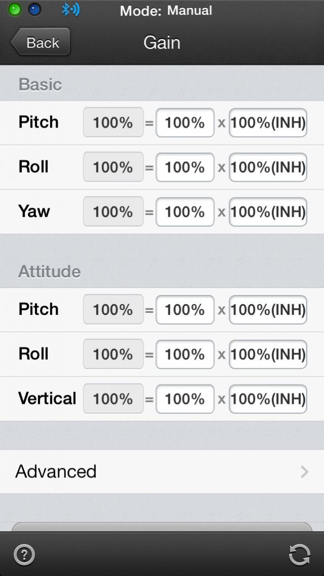

Thank you it worked perfectly but the sticks were misconfigured. But now I have another problem when it starts flying it does like a feather effect and it falls. Yesterday it flew perfectly and today it started to do this. Will be bad the dji a2v
View attachment 17306 View attachment 17307

This looks like your gains are perhaps too low. Can you post your gains please.

As Carapau said, your gains do look too low. It seems slow to respond to attitude adjustments which means it over corrects and bounces back in an endless cycle.

the gains are fine, tomorrow I´ll post a picture. The weird thing is that yesterday I flew it for 15 minutes perfectly, but out of nothing it starts the feather effect.

Well, can you post your gains so that we can have a look- it still sounds like a gain issue of some sorts.

looks like low gains to me....or maybe incorrect imu mounting co-ordinates! show the gains and imu settings!

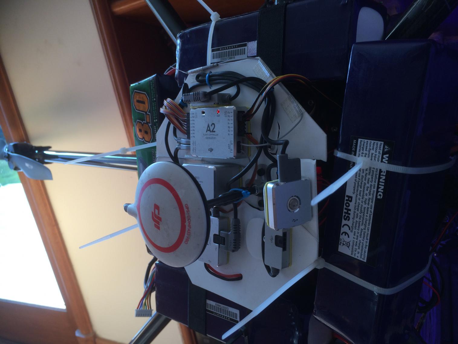

thank you all! i tried the setting and it gave me glennyboy for now it`s working perfectly, but still i want to leave the octocopter date to see if it can work even better! best regards
ocotcopter
4 batteries of 8000mha 6s
18x6.1 propeller
dji a2
t-motors u7 420kv
esc 40amp
the weight with the battery and camera is of 11kg aprox
